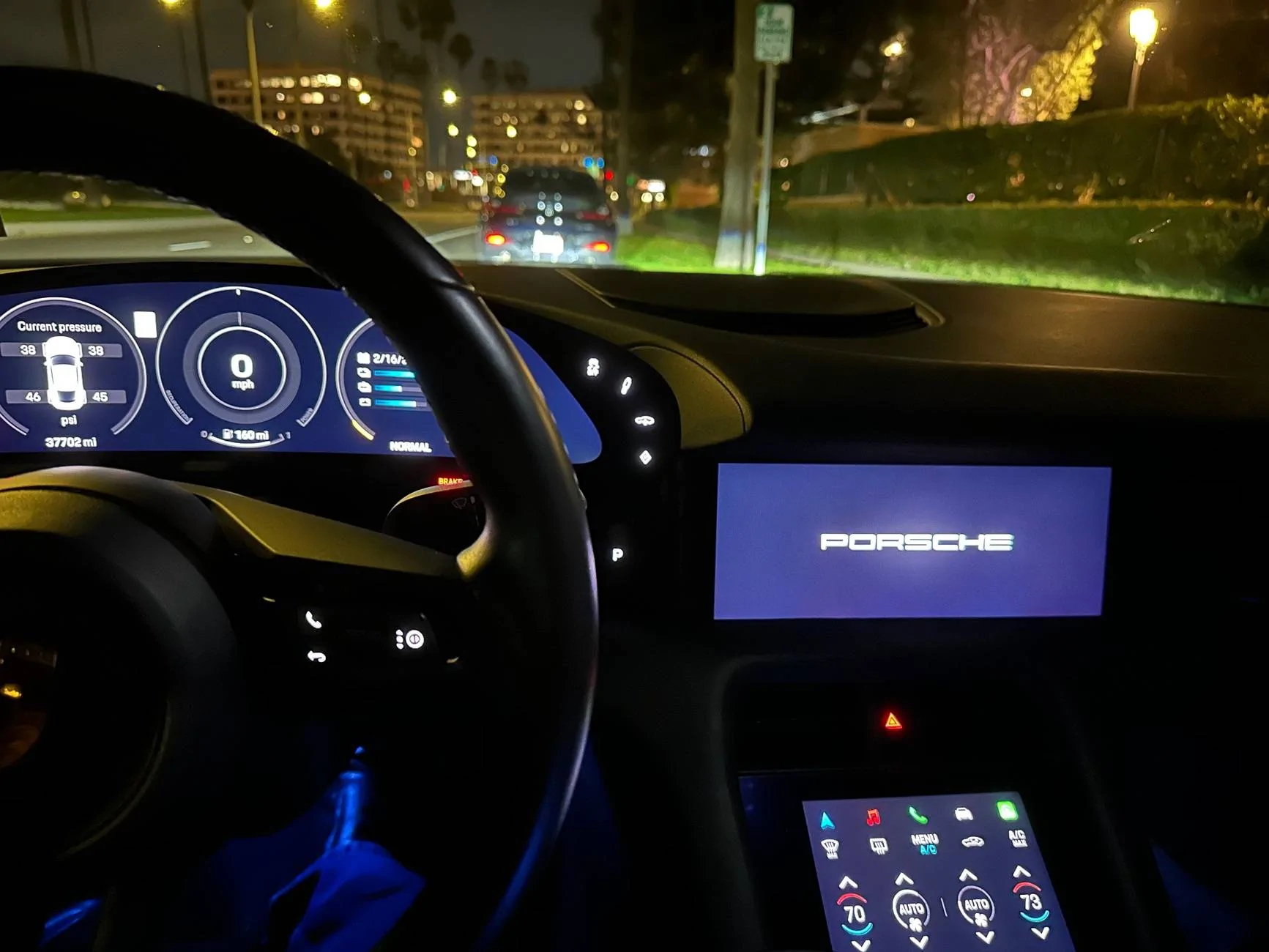

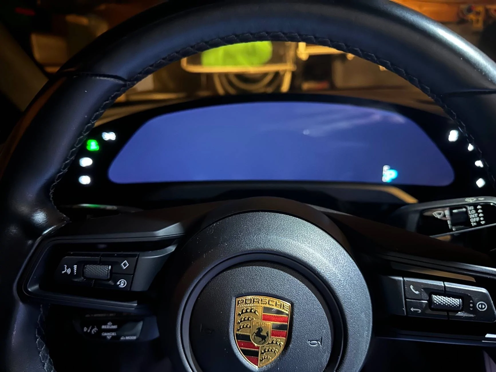

I just got my 2021 Taycan back last week after they had to reset the PCM software which was not communicating with the Porsche servers. It worked for a few days but now it stopped communicating completely and all I see on the dash PCM is the Porsche logo, no ability to see or select anything. No maps, no music, no settings. When I turn the car off the driver display goes completely blank.
Back to Porsche service we go…
At least it drives…
