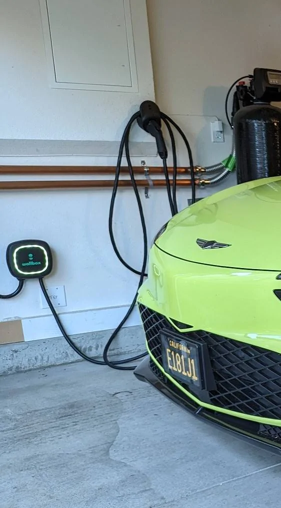

Yes, do not forget about support during and after EVSE installation.
For my Wallbox EVSE, I needed answers to questions at startup and, a year later, failure diagnosis and replacement. Good support from Wallbox.
Yup, love my Wallbox, they support power sharing natively too. IMO the Wallbox has the best form factor, I don't like that most EVSE have the "dock" integrated into the unit. No NACS built in, but I suspect plenty of J-1772 to NACS adapters will flood the market when everyone starts switching over to NACS in a few years.
