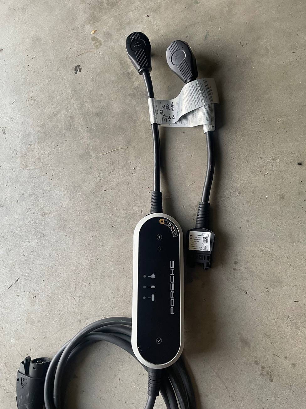

Anyone have a new charger cable from Porsche? The plug on mine points away from the wall, and they’re trying to tell me that it
is OK to twist a 220 V cord to make it fit. And they replaced it because they were worried about causing fires?
can you get the software version from your PMCC unit since you clearly have the new cord which requires a software update?
thanks.

anyone wanna bet they are trying to fix this bug? which we have two confirmed reports on this forum from people with new cords?

Just got my new cable and it’s backwards as well. I swear you couldn’t make this shit up at this point. One thing after another.
I just bought a Taycan, when I went mount the included charger, found same issue as in this thread. Plug faces the wrong way. So, contacted sr Tech guy at dealer. He was completely unaware of that problem. Response got from tech team at Porsche: “just twist the cable”.
Dealer asked me to escalate thru customer service. ???!!!!
