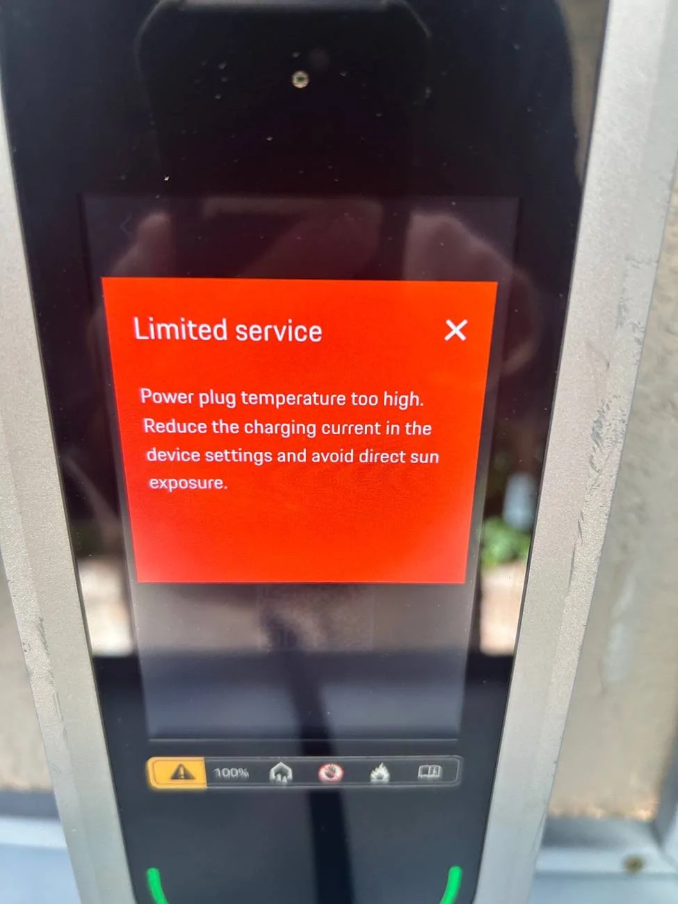

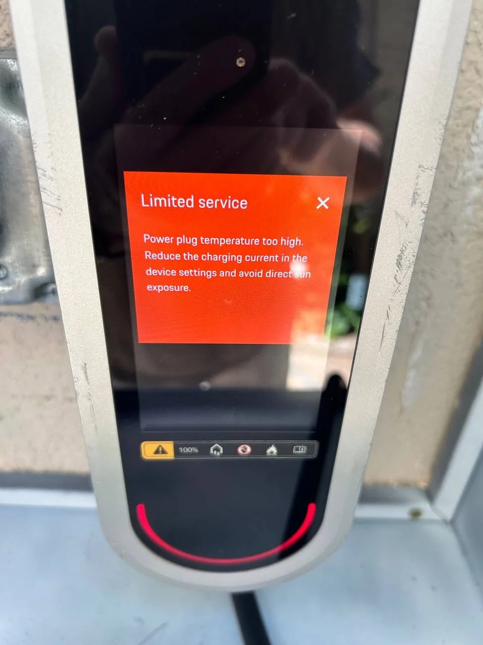

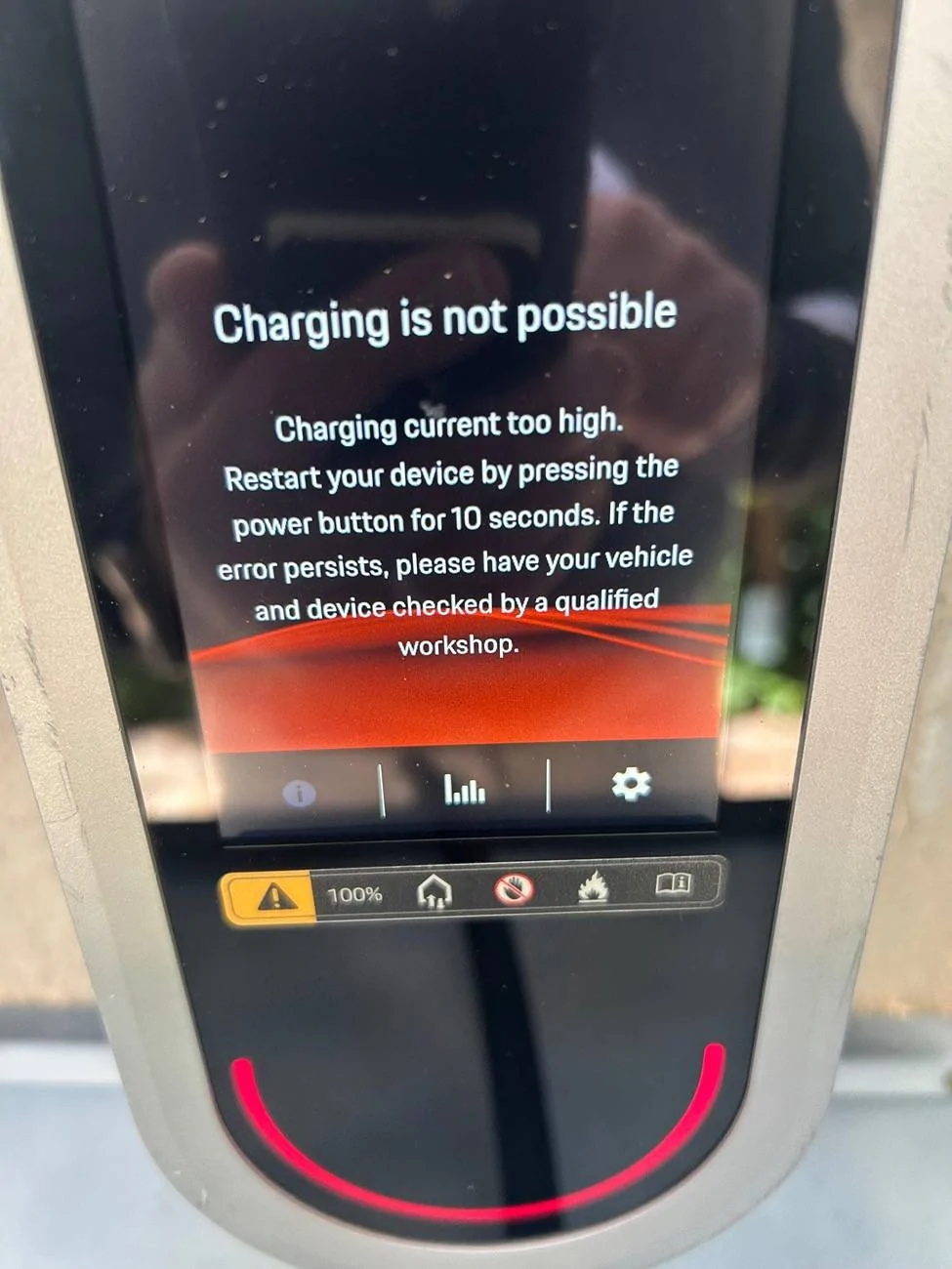

After the dealer replaced the charging cable per the recall the charger does not work. Even at 30 amps does not work say overheating

I tried mine a few months ago and it worked fine at 50%. I got the error after sometime of charging at 100% though, but I didn’t keep a close eye on it so couldn’t tell how much time had elapsed before it failed.

the North American Porsche EV charger is not a quality product - 4+ years of history has demonstrated it to be deeply flawed - Porsche's efforts to improve it have actually made it worse…buy an alternative North American EVSE from someone else and move on…many on this forum have and are quite happy…
https://www.taycanforum.com/forum/t...uide-to-the-porsche-evse-pmc-pmcc-pwcc.13886/
top North American alternative choices are - in random order - many of these alternatives are $500 or less…
  • Porsche Wall Charger
  • enphase/clipper creek
  • ChargePoint Flex
  • Tesla Universal Wall Charger
  • Autel
  • Emporia
  • Wallbox
  • Tesla Mobile Gen2 + TeslaTap (32 amp max charge rate)
  • others

Only in US / NA. No recall in Europe or UK either. Four trouble free years for me.
