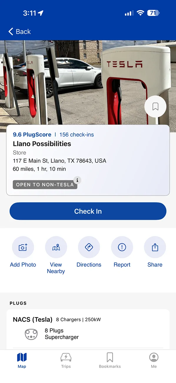

After fuming for most of the day, I see that Plug Share app appears to be able to let me configure a car as a Tesla with a setting of Hide Tesla Only Locations that confirmed that the station that I tried to use is a Tesla Only Location, and only 2 out of many show on the map as accepting non-Tesla vehicles that is easy for me to test if that is the case. The Tesla charger that I was going to use coming back from the country store is listed as accepting non-Tesla vehicles, but until I can trust that, there is no way I am taking a chance getting stranded.

Station 1: That was my user error by assuming All Tesla stations work for us, that station was not in the App/PCM and PlugShare did not list it as supporting non-Tesla vehicles.
Station 2: App/PCM shown and PlugShare labeled non-Tesla. I pull up plug in, 5 minutes initializing then Fail. I give up load the Tesla app, which is by the way horrible as far as ease of use, signed up and logged in and there is nowhere to be found how to get to Charge your car. I figured to close it and open back up and finally see that I can charge the car. I select charger and it started charging peaking at 119kW at 60% SoC with battery preheating nicely. However, this is not seamless integrated Plug and Charge experience we were promised.
Station 3: App/PCM shown and PlugShare labeled non-Tesla. I pull up plug in, 5 minutes initializing then Fail. Then used Tesla App and still Car says charging not possible.
Bottom line: There is no assurance that even if the Tesla charger appears working for us that it will actually work.
