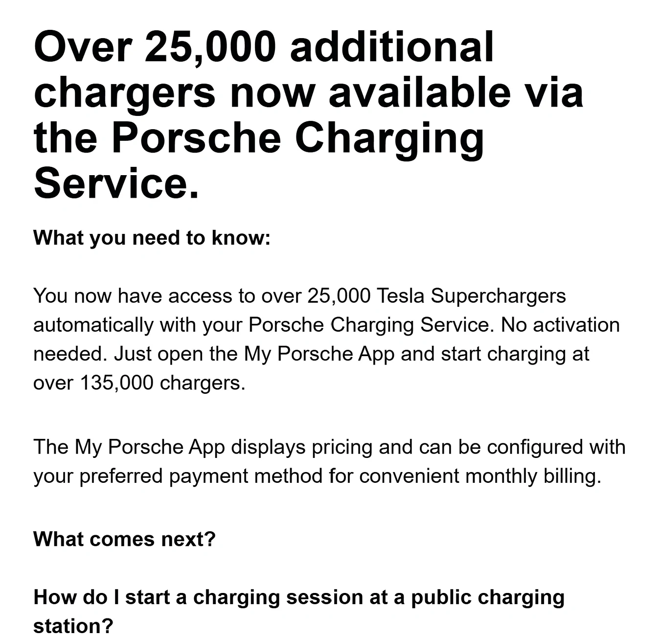

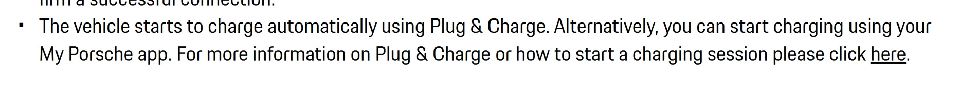

Ok @gtm, this is the e-mail I got from corporate on Oct 28, 2025 with no differentiation about J1.1 or J1.2, just plug and charge.
This is the source that says this applies to Taycan 2020+ and
https://ask.porsche.com/us/en-US/use-porsche-nacs-dc-adapter/?sap-outbound-id=90069E667B2F8F72B4C13A79002F2115ADFBD179&utm_source=SAPHybris&utm_medium=email&utm_campaign=100015056&utm_term=PCNA Tesla Go Live EM 202510___Learn More CTA 2&utm_content=EN
