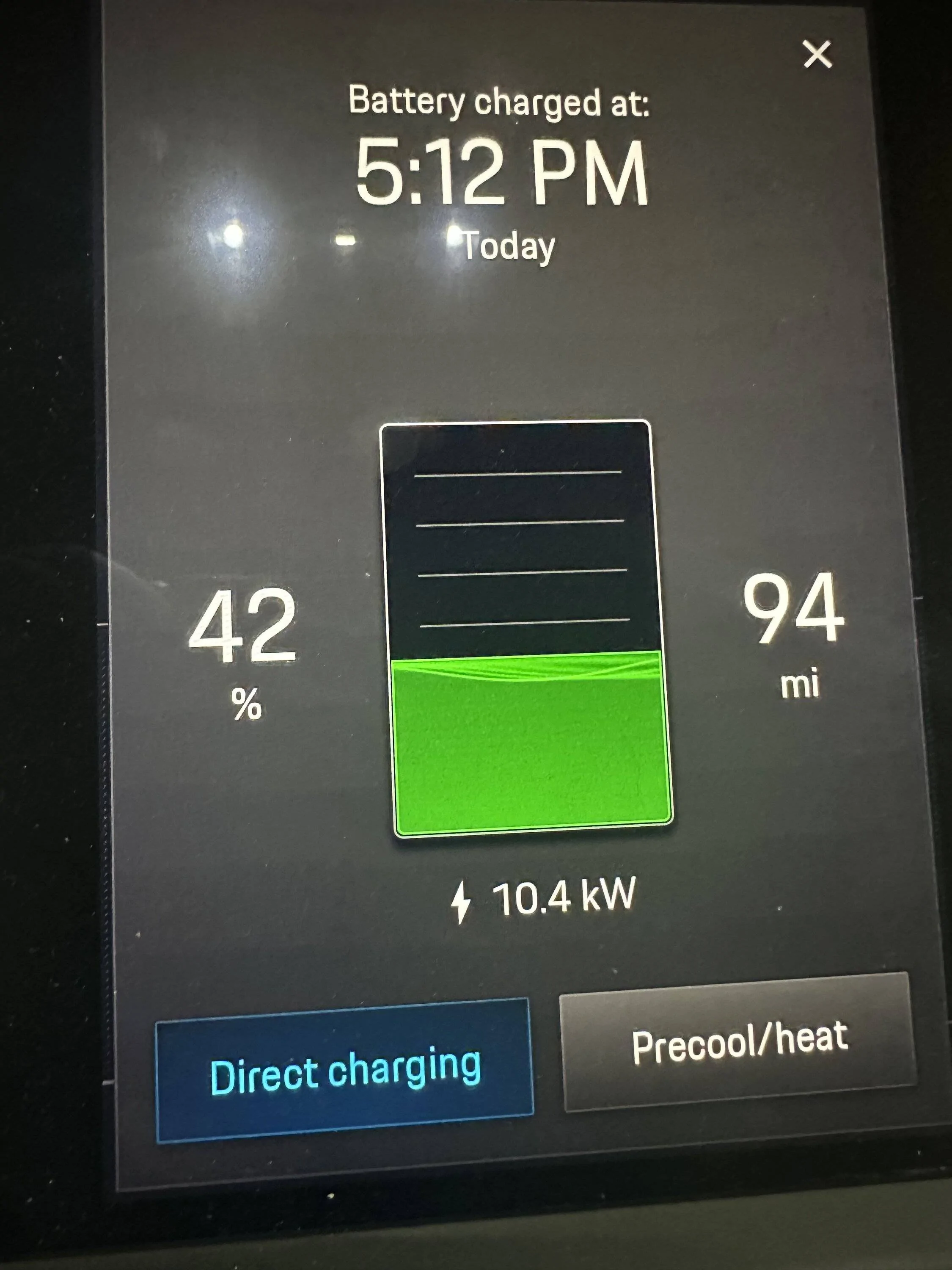

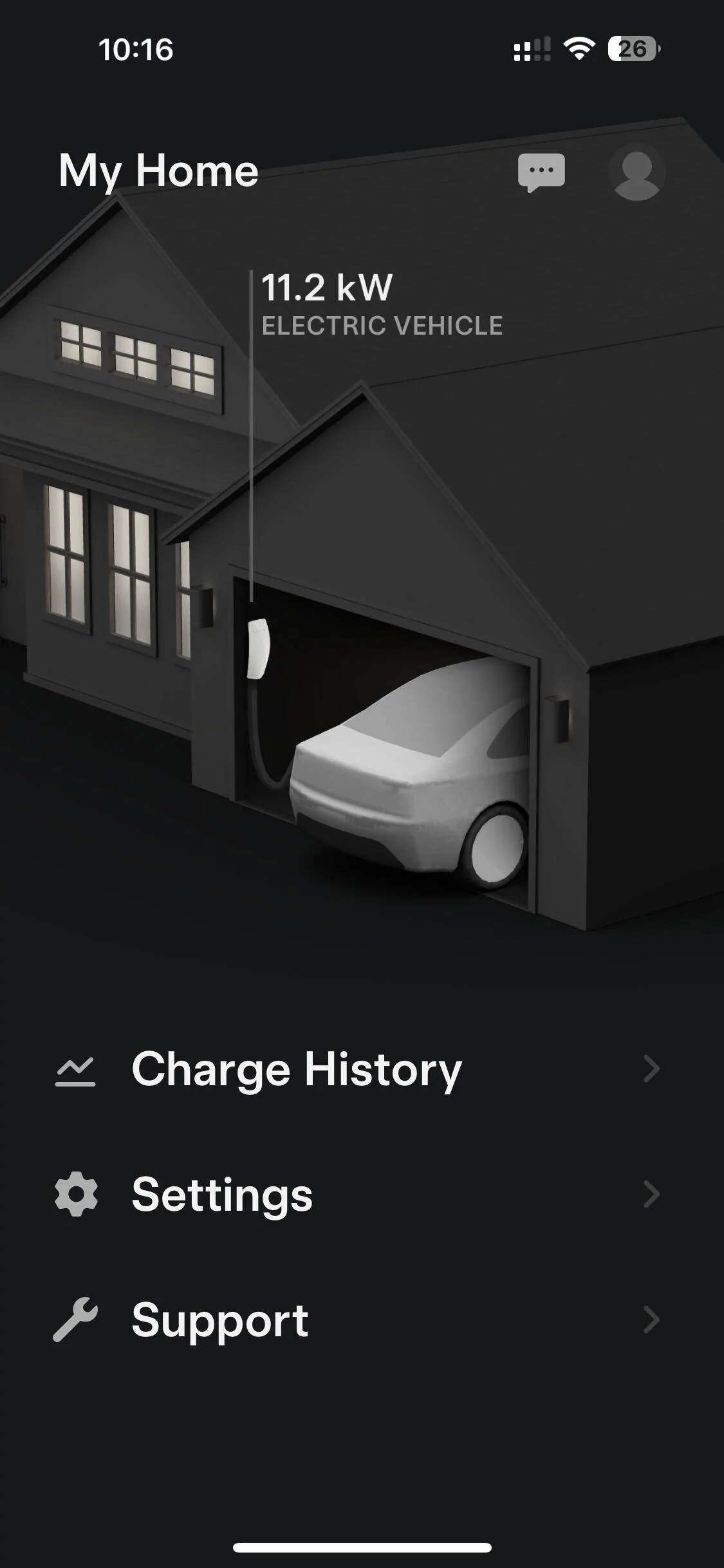

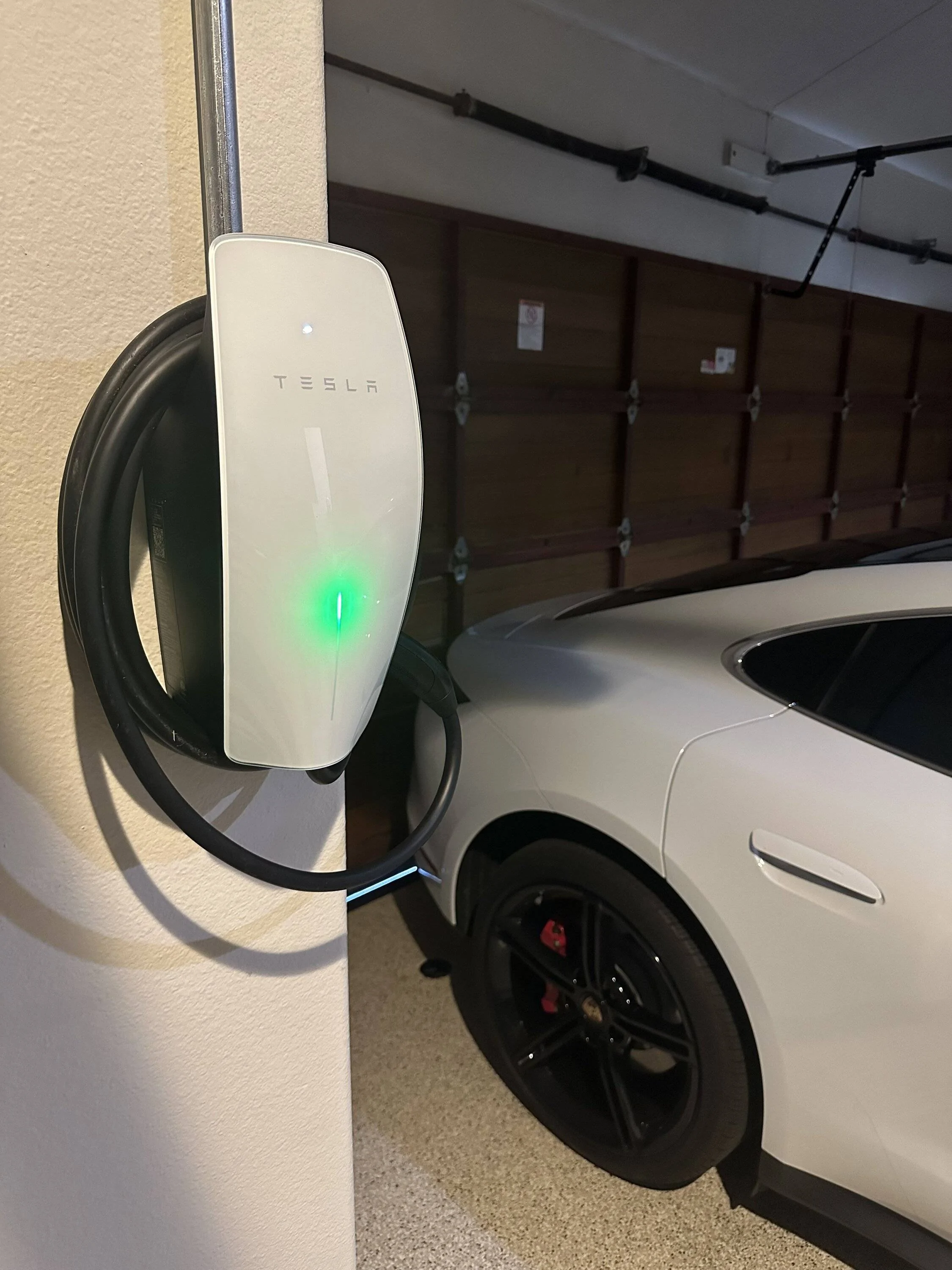

@RAHRCR here are some screen pics of the universal charger.
My set up is a 60a breaker with #4 gauge copper run in about 30ft of metal conduit from the panel.
As you can see in a “cold start” I am reading 11.2kw/h at the Tesla charger (read through the app) and at the same time in the car 10.4kw/h.
From experience the charger gets up to 11.4kw/h and I see 10.6 kw/h at the car.

  • join the Wall Charger to your Tesla "home" via the Tesla app - so you can monitor wall charger charging sessions and download statistics
  • see Tesla.app for "add product" instruction - add a "wall" charger
  • it will take 10-15 minutes and few reboots of the Wall charger
  • no reason to do this other than
    • charging statistics
    • charging monitoring
    • schedule management (EVSE can have restricted schedule)
    • intergration with Tesla solar & battery for power/capacity management
    • FOMO
    • potential future features as Tesla rolls out new firmware and potential clever features.
The universal wall charger is working great for me - Hardware install and physical installation was easy, straight forward, and similar to previous Tesla wall chargers - it was easy because I had the existing circuit - so this install was effectively a "swap" of an existing unit to a new and very similar unit.
Software update and wifi/hotspot administration requires some technical savvy and confort with webbrowsers and isolated wifi networks - once software updates are applied and the unit is "joined" to your home network my experience from the past 18 months is these units are "fuss free" - but you have to get them "setup" and configured
power sharing is slick and I highly recommend it for mulit-EV homes…
for $600 mostly shipped overnight - this is one of the best EVSE's on the market for value, feature setup, charging capacity, quality, ease of setup/install…
