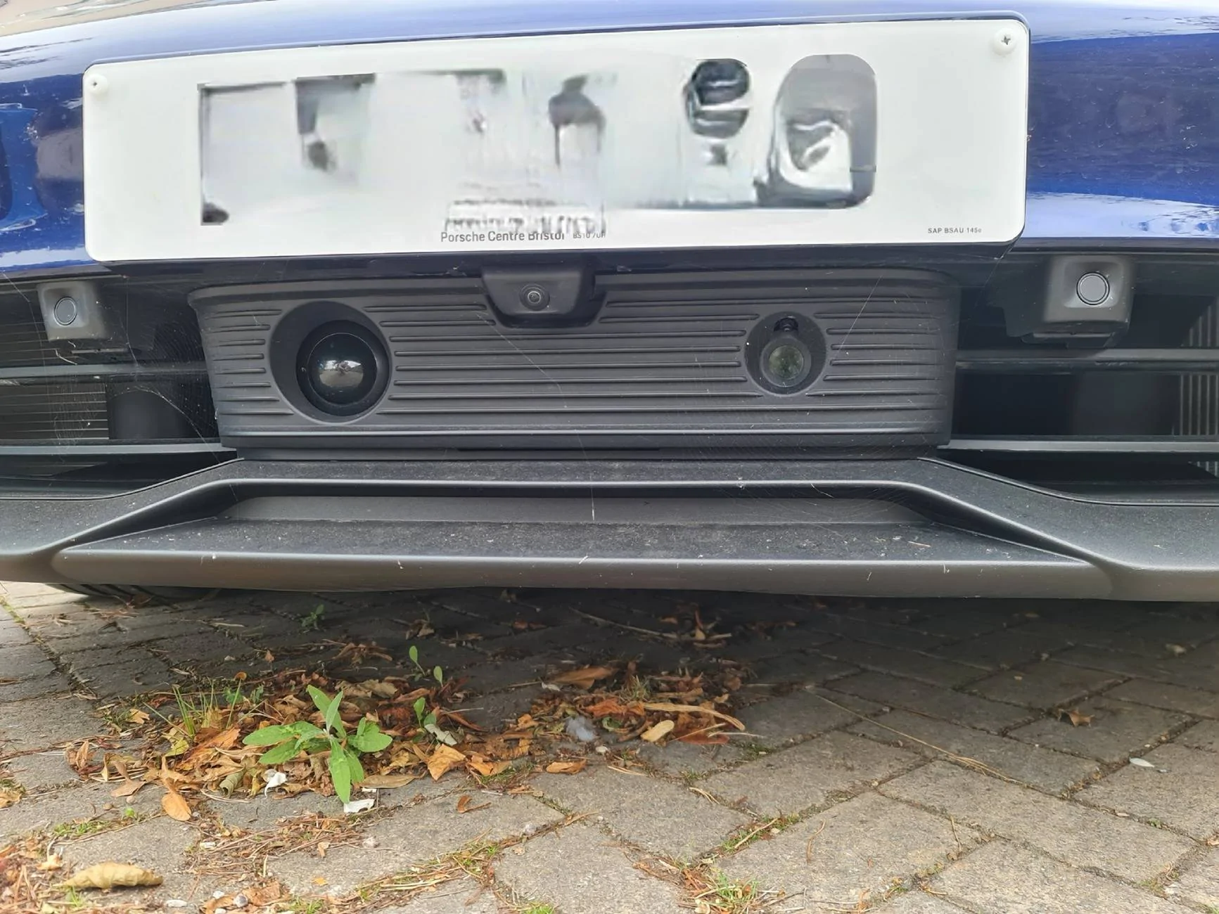

If you want to lower the risk of breaking/damaging the glass you can cover it with a foam pad or similar when not in use in daylight.
NOTE:
The camera isn't available in daylight anyway (BUT the camera is still working as a safety feature and anti-collision device for people/animals).

Update for the thread - because a lot of people are worried.
If you search on eBay for PAB980552 or PAB980552A (latest number), then there's a lot of cameras for e.g. 800-900 EUR.
The camera is used on a myriad of cars - Bentleys, Porsches, Mercedes etc, all the same OE supplier part number - 631226500A
Yes, if you go to Porsche you have to fork out 6000 EUR + VAT, but why?
I also doubt you have to code the camera to the car. There is a control unit for it, which you probably have to, but the camera itself is a very simple device, there's only a 4 pin connection, wouldn't surprise me if it's analog. In fact, I think it is extremely likely the camera for e.g. a Mercedes could work on a Porsche.
