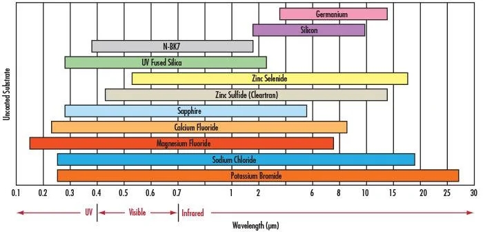

You need a cover for 8 to 14 microns (LWIR) and you need to block out the other frequencies as the camera is based on microbolometers which are sensitive to basically the whole frequency spectrum.
I'm not sure you can get an acrylic sheet which covers these requirements.
And with the new restrictions on exporting germanium from China, it's probably even harder to get a replacement window.
The kit from Flir was under the number 421-0055-00 priced at $300. Maybe there is some specialty shop out there which still has a kit left.

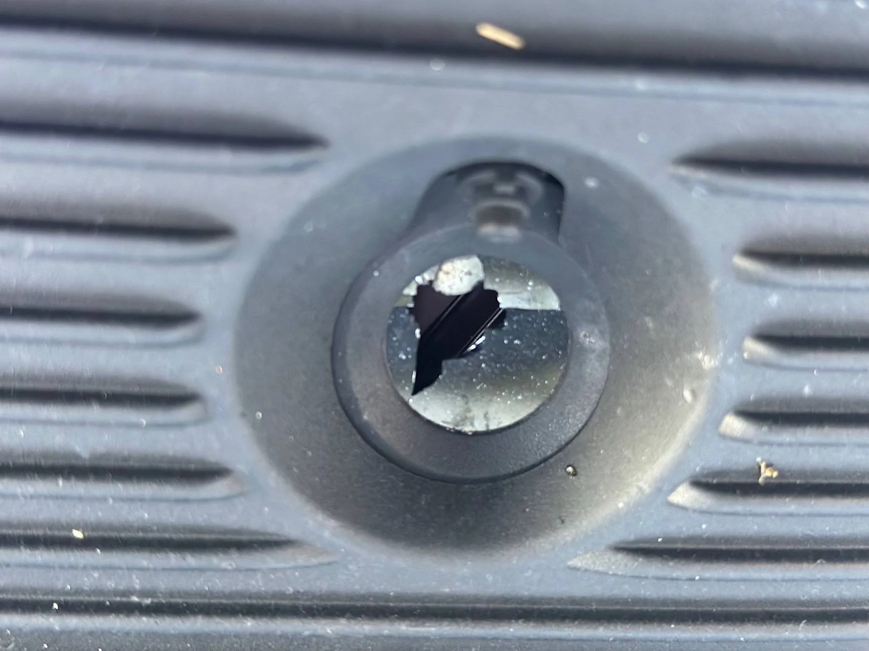

Porsche Taycan Night view camera glass replacement IMG_8684

A smaller diameter will not reach the rubber seal inside. Also thinner than 4mm will not have the necessary clamping force to keep a good seal.

Doesn’t work, most materials out there block or scatter IR in the 8-14nm range. You could try putting brown PET, plastic bottles is a good source for this, but the signal will be attenuated, PET is not as transparent to IR as germanium is.
Side note: the camera inside has the necessary filter for the part of the IR it needs, so theoretically you could put any IR transparent material on top, germanium is the best choice because all other options with acceptable transmission are even less tough.

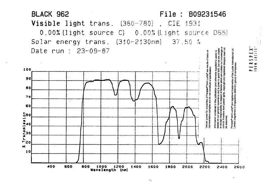

Anyone tried Perspex 962 IR as a replacement. It's an acrylic, so can be laser cut to size. Blocks visible light, passes IR through. ~$12 for a 150mm x 150 mm x 3mm sheet on ebay, which can yield you multiple replacements from a single sheet. Laser jammer installers use this material for stealth installations.

This plastic looks like is only transparent in Near infrared and only 37% on average across 310-2130nm
The spectrum useful for thermal cameras is Long Wave IR (LWIR) which is 8000-14000nm (8-14um) and germanium has an average transmission of >99% in this range with almost no scattering.
Porsche Taycan Night view camera glass replacement fig-4-cmi-0000
PS> Your diagram axis labels are mostly unreadable.
@whitex tnx!, fixed now :)

Just for fun, I took an acrylic IR pass filter (slightly different than the Perspex above, 700-1600nm pass band) and put it in front of a FLIR-One camera which connects to an iPhone (I didn't feel like going outside to try it on my car) and can confirm that it completely blocked the FLIR camera. I'll probably try with a Taycan sometime when I get my hands on the actual perspex acrylic, but pretty sure it will block it too. It's not that I didn't believe you, I just like to "trust but verify". ;)

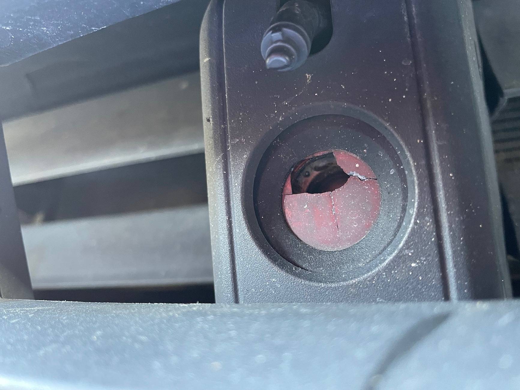

Today I found the glass of the night vision lens on my Taycan GTS scattered. Obviously I asked the Porsche centre for an estimate for repair, and go a €8,583.55 as repair cost…
I know Porsche service is good but expensive, but an €8500 bill to repair an €2500 option after some stone chip scattered a 5cm2 low placed glass panel is still a surprise…
Porsche Taycan Night view camera glass replacement IMG_9736
