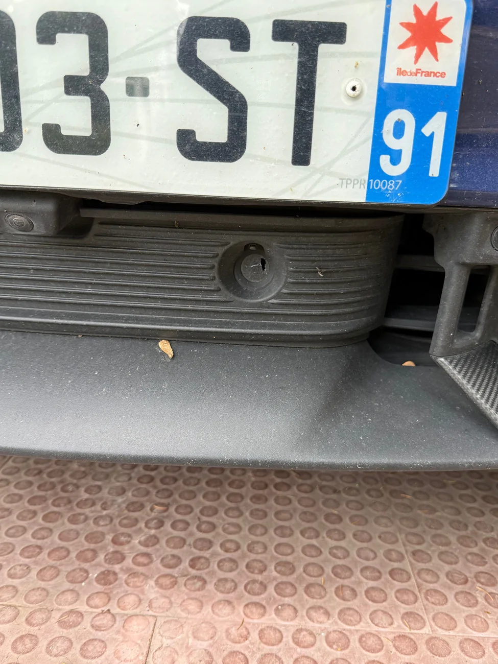

Today I found the glass of the night vision lens on my Taycan GTS scattered. Obviously I asked the Porsche centre for an estimate for repair, and go a €8,583.55 as repair cost…
I know Porsche service is good but expensive, but an €8500 bill to repair an €2500 option after some stone chip scattered a 5cm2 low placed glass panel is still a surprise…

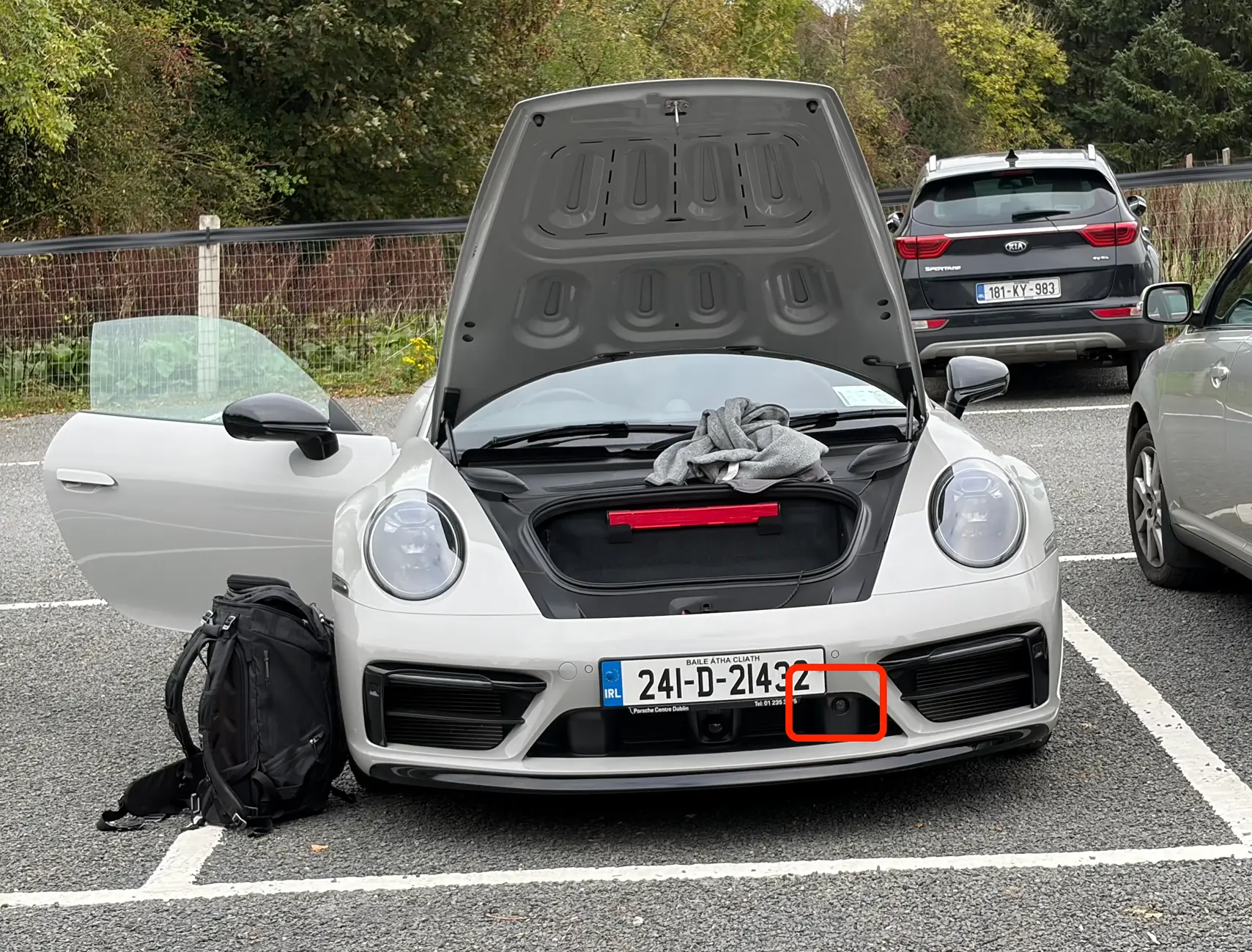

Would something as simple as a "screen protector" like what some folks with mobile phone use – cut to the shape of the glass help with smaller stone chips hitting it?
I'm interested in this topic in general because I have the same camera on my 911 and presume it suffers from the same risks.
No because it's opaque to IR.
