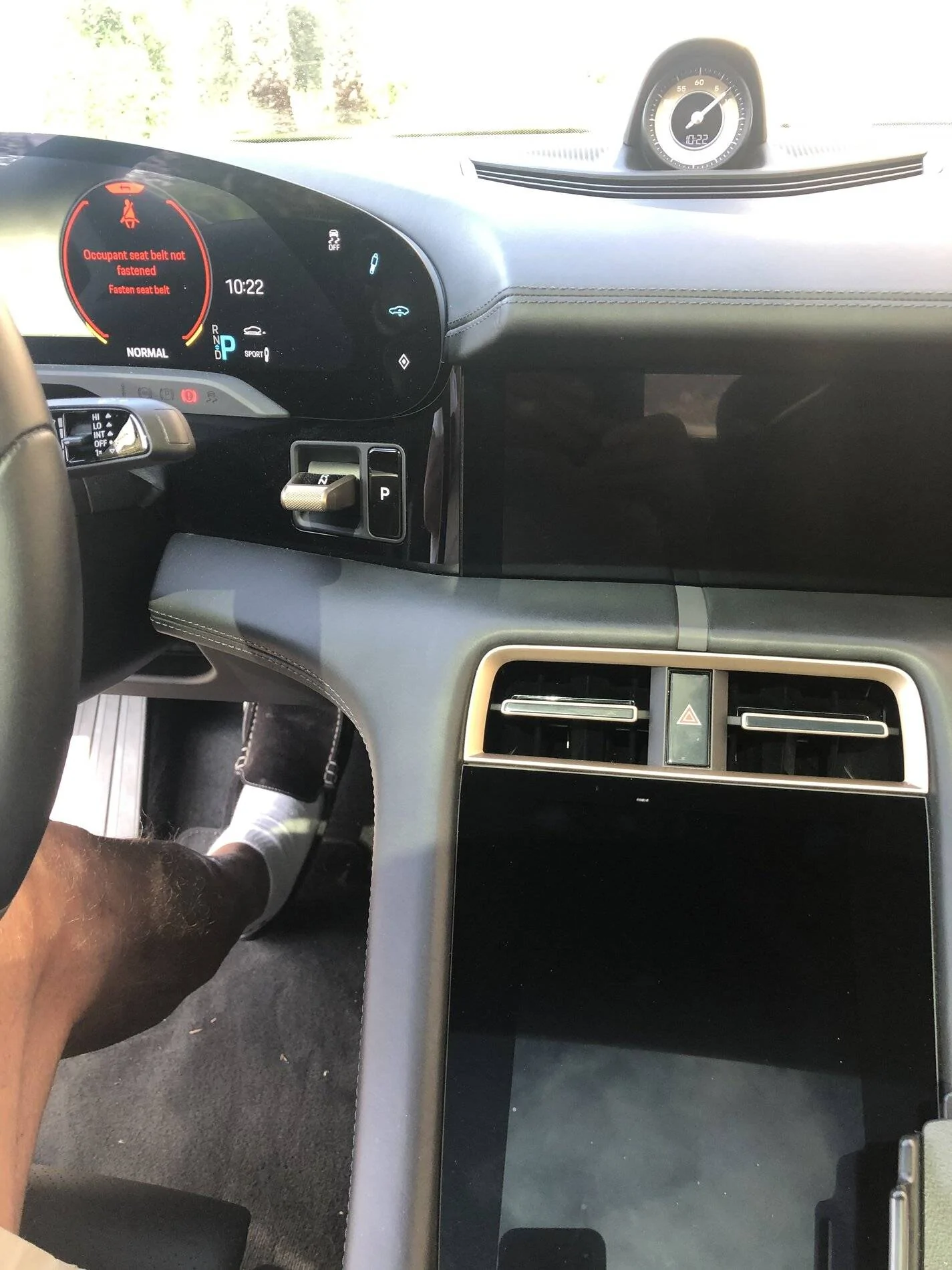

If this is what you are experiencing, then I have the same.
As you see the driver display was working and car worked correctly, but I stopped driving and parked to get it going again.
car has been atPorsche dealer for over a week and no resolution as yet.
They cannot communicate or update the PCM in any way. The dealer is in contact with Germany, but their response rate is only once per day! Not impressed by that response by Porsche DE.

I wonder if your issue is the same as mine and same Q to @nidge - in that were the PCM/Centre console actually working i.e the Radio continued to play, parking sensors audio working, haptic feedback on AC etc but it's just the display is blank/not showing anything so you can't tell what you are clicking on? as that's the issue I have, likewise the workaround fix to get it working again is the 2 finger PCM reboot into Engineering mode and back then again to Normal mode.
i.e. for me this is a software timing issue/comms on start-up to the displays rather than a HW fault I suspect.
If so and your issues are the same I think it's quite worrying that Porsche Assist or your dealers don't seem to know how to reboot the PCM properly into Engineering mode?
FWIW - I also tried a complete Factory reset on mine after the 3rd time it happened, hoping that might reset everything and clear any Software gremlins - alas it didn't and mine's going in next week for this apparent Software fix for the issue that the dealers advised Porsche just release last week.

yes this is the same problem (though mine also includes the passenger display also being blank). Never had the problem whilst driving, it's always been when I've unlocked/started the car and they are blank - only workaround I've found is the reboot into engineering mode and back which then turns the screens back on. Problem then comes back randomly after 2-4 days or so.
Let's see what happens with this supposed software fix, I'm due to get next week. ?
Short Update - not Good news! Car went into Tuesday to OPC for the "new software fix" - the dealership couldn't explain to me what was actually getting updated and that there was no service bulletin to describe the fix or what changed. I read that as they don't actually know what they are really doing and just following Porsche HQ instructions.
Anyway - I checked the PCM version numbers before and after and what I can see from the cars SW version numbers they all appeared the same - perhaps it was some Firmware in one of the control modules - who knows? picked car up Tuesday evening, they said update applied fine, should be fixed.
Brings us to today - unlocked car this morning - same issue - all 3 displays won't turn on and are blank, Engineering reboot again brought them back to life - however, I may now have a different issue in that Online Radio, Weather, etc are all not working no - no connection - though LTE module appears to be ok and Green light in SOS. I didn't get a chance to look into that fully yet, perhaps needs a drive around to pick up connectivity again - will do that over the next few days.
Anyway - called OPC again this morning, stated it's not fixed - waiting to hear back on next steps.
In short a complete PITA by both Porsche and the OPC.
I suspect next steps are back to swapping out some HW in the car.

There is an OTA module too - potentially this and / or the LTE module are flaky.
Sounds to me that they didn't perform recent upgrades in the correct sequence and attempted to reapply leading to no changes. If engineering mode reboot temporarily addresses the issue that suggests to me the boot sequence is different. It shouldn't be this hard and hugely frustrating.
Completely random suggestion but have you tried resetting the PCM totally and deleting all Porsche Connect IDs from the PCM (whilst connected) and starting afresh? You will lose some settings which you can easily re-create.

Yes - did a complete Factory Reset previously in an attempt to fix prior to the latest SW *fix* - like you said had to redo a lot of settings, some are saved in Porsche ID some not.
I've not tried a reset again after latest update. I might try it again at weekend when have some time, I doubt it will work though.

Mine got a new control unit installed today to hopefully fix it. Too soon to tell if it has worked or not. Should be able to confirm in a week if I’ve had no reoccurrence of the issue as prior to HW swap out it would happen every 3 days or so.
What I can say is the opc did half a job in the install as all remote services were not working after the swap out Despite me account being the main user in the pcm.
When I got home I had to do a factory reset of the pcm to then setup and login again with myporscheid to get all the Porsche connect services back.

Yes, so far so good - been a week now and seems to have fixed the issue.
