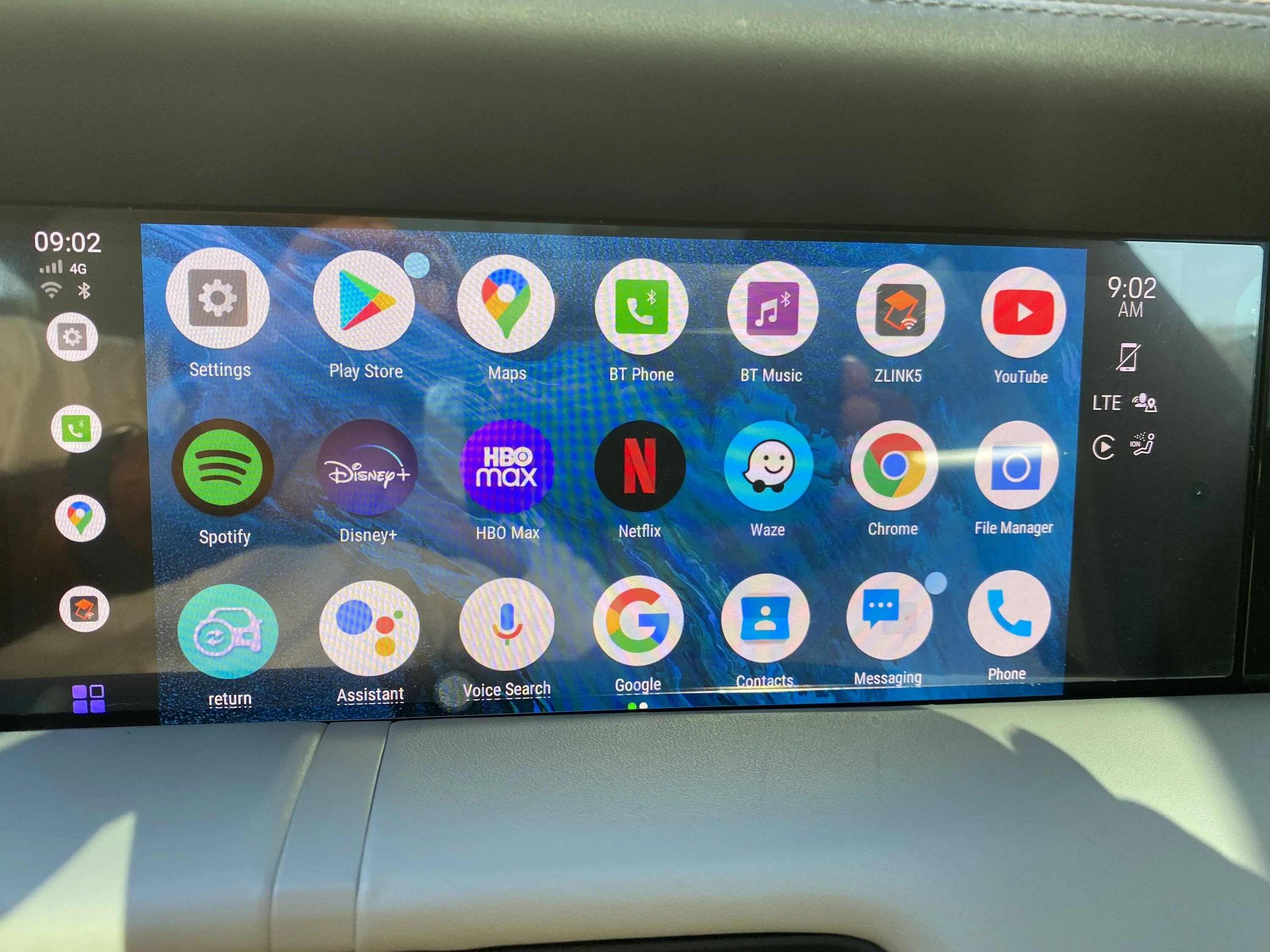

You could add MMB box (CarPlay without limits), its on android and has a hdmi output.
The only thing we need is a proper solution for the seat mounts.
Or like many doing on a Tesla: Just use a suction mount on the glass roof for an iPad.
Already have a CarinMB box - works a treat
Porsche Taycan Passenger screen retrofit F8412870-FBD0-41F2-8E26-C8E1DDA3F506
is that just from plugging in to USB like the MMBBox? Where does CarinBox come from? A quick Google search turned up nothing.
Will that show on the passenger screen, or only the main screen? (I know Carplay, atleast on the 2020 software can only be on that screen)

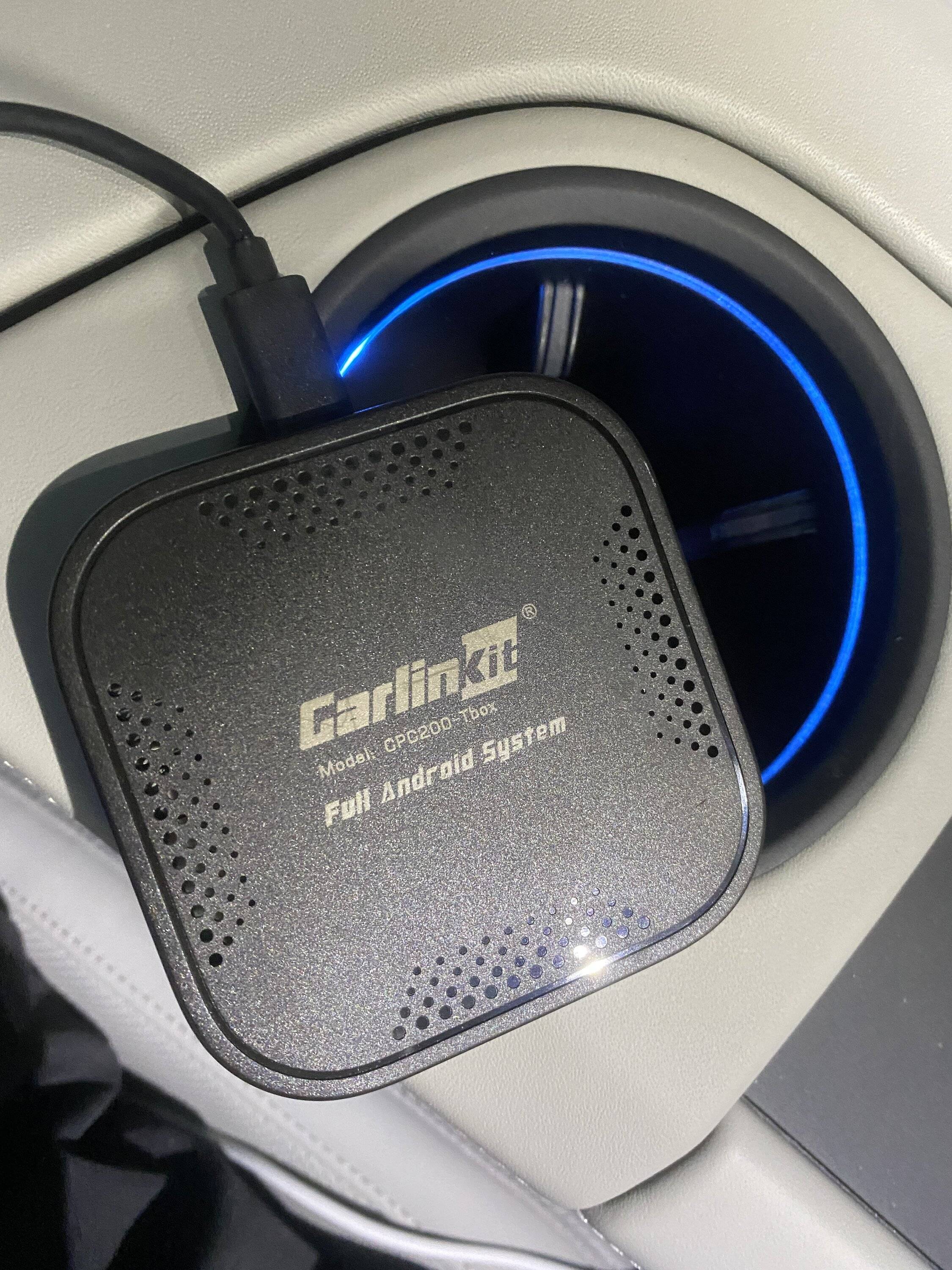

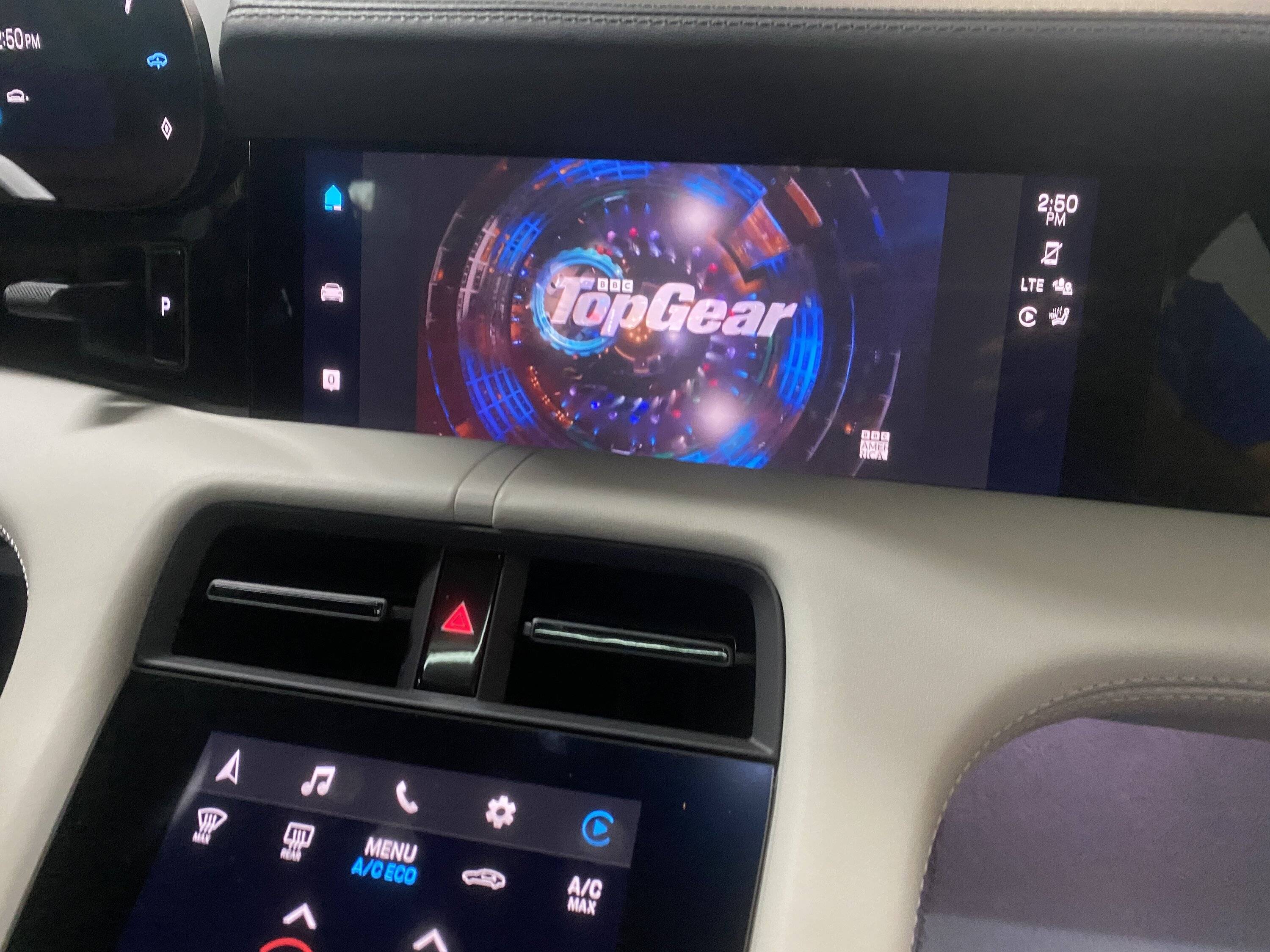

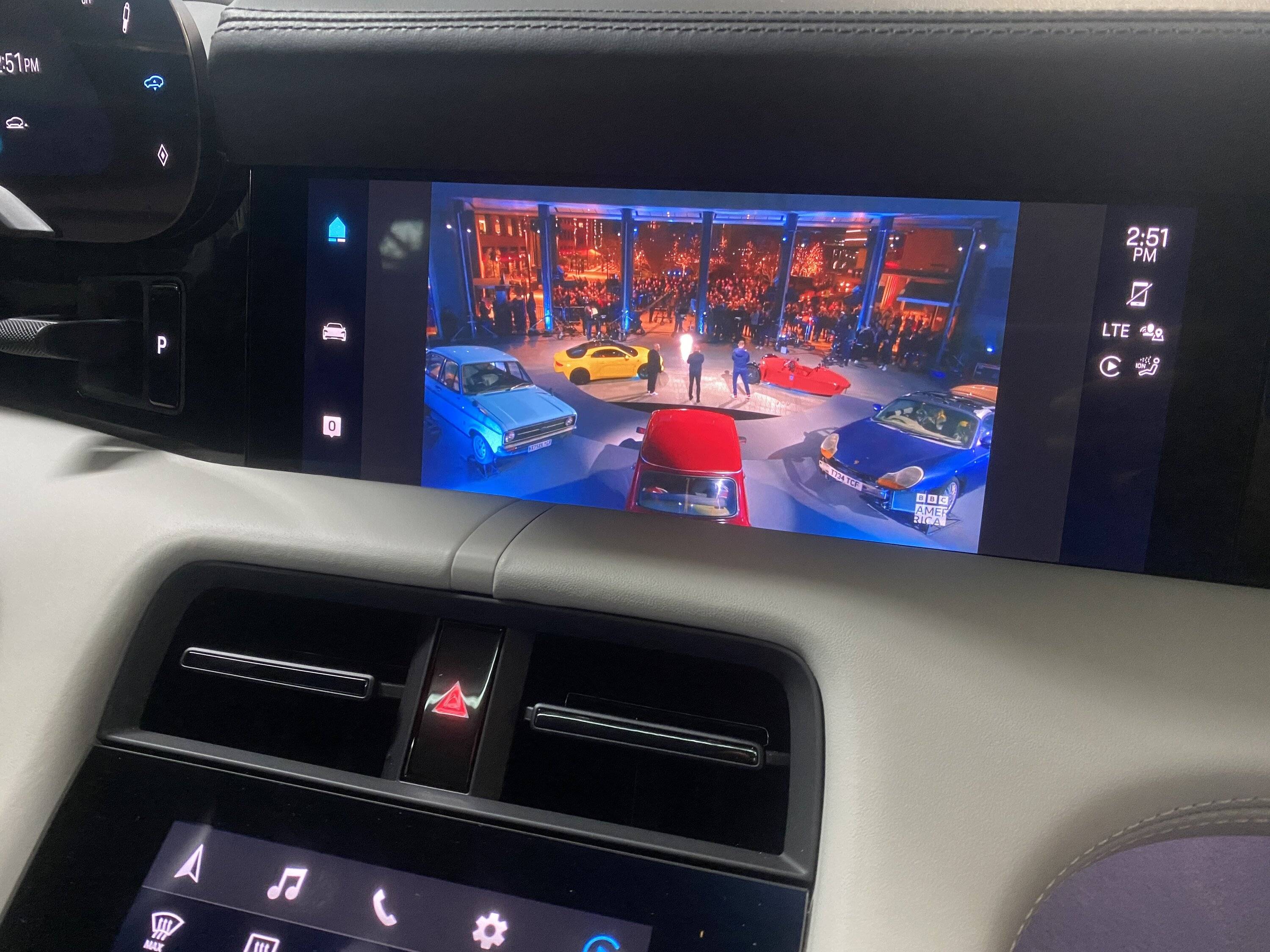

Yep, plug it in and select new “Carlin Kit” CarPlay Box and you get full CarPlay with all apps.
It’s my understanding that Video shows on both screens at the same time. Not super useful but OK.
- sorry about the typo.
Not sure if you’re referring to a plug in box setup or simply the Apple CarPlay from phone but with phone it shows on both screens in my 2022.
Just wireless carplay in general. On my 2020 with the 2021 update it ONLY shows on the middle screen, not the passenger screen. I guess I'll find out when I get mine back from the 2023 update.
ciaranob
Jul 3, 2021
3,547
2,640
Ah right - yes wireless dual screen video std in my 2022 so hopefully if all the 'noise' about this 2023 PCM comparability update is for real then indeed it will be ported to the 20/21 models.

Sorry to go OT for a quick question - I'm about to buy the same box - I use Apple CarPlay (wired or wireless) in a my2020. Works without a glitch (unlike the PCM). But my iPhone is connected to a portable LTE/4g router as it allows quick roaming across different countries (Switzerland, Germany, Austria, Italy, etc.) a bit like the Taycan LTE connection does.
Can I connect the Carlinkit to the portable router in your opinion without having to hotspot the iPhone?
thanks
Yep the kit is a full android device with both Wi-Fi and cellular connection options. So simply connect the kit to Wi-Fi router/hotspot of your choice.
The device also has an onboard Sim card slot so you can actually put a separate Sim card in it just like a phone to connect.
This is the way I use it. I have a cheap Sim card that I keep loaded so I don’t conflict with the main Carplay option on my phone.
The car simply sees another device connected that it thinks is a phone and shows up in device manager. I swap between the two as I wish to swap between the two CarPlay connections.
That being said I haven’t tested all the combinations of router/hotspot situation that the car offers.
