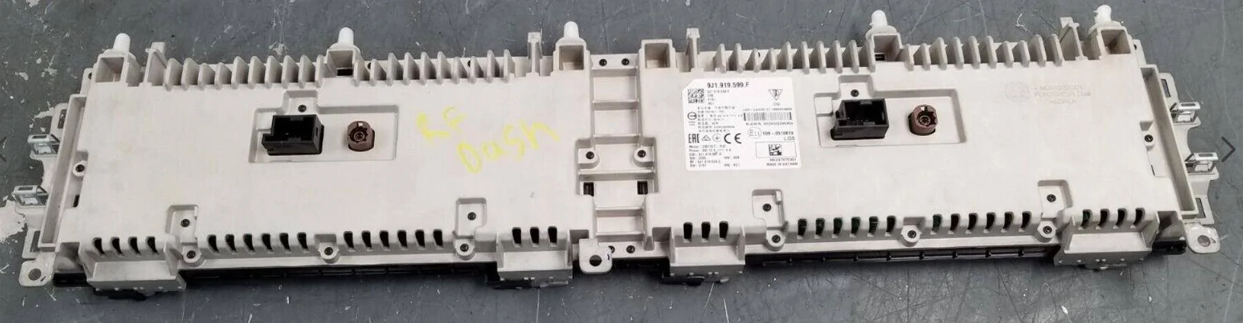

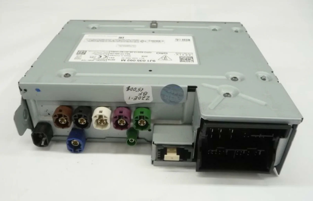

The screens had different part numbers for different model years but possibly compatible. Have you figured out yet how to connect them? The PMCC appears to only have one browns Fakra connector,
Porsche Taycan Passenger display screen retrofit install / swap? 1695617157377
but the dual screen has two (one each screen).
Porsche Taycan Passenger display screen retrofit install / swap? 1695617167219
Each brown Fakra has 2 high speed pairs, perhaps there is a splitter cable you will need which takes one pair to one screen and a second pair to the other one?
(images above from ebay).
