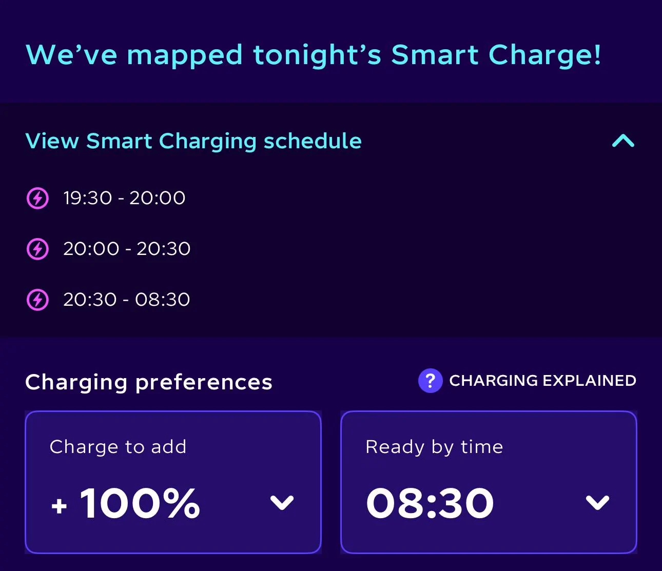

I have also gone the route of integrating OI in to my EVSE (Zappi in my case) and not the car. Works far far better in my opinion. Plus you get the bonus cheap rate hours when it’s plugged in - even if finished charging. Just set the OI app to ‘add 100%’ and it will schedule big chunks of low rate hours:

So, I tend to use mine in dumb mode but are people saying if you plug in with 10% and set a charge target of 100% and enough time at 7kw per hour is available before ready by time it will charge the whole battery at 7.5p ? Has anyone validated this and that they haven’t been charged at peak rate for the surplus?
If so I might go back to using OI to control it on the odd occasion I need more charge…
See what is scheduled for me in my screenshot - 13 hours at 7p. There is no way for the EVSE (and therefore OI) to know the current SoC. I had plugged in at 60% and had a profile to charge to 80%, yet because I always leave the Octoous app set to ‘add 100%’ it always tried to schedule as many hours as possible, and therefore more cheap hours for the house! Doesn’t matter if the car is actually charging (as long as it’s plugged in).
Even more confused now. If your battery was at 60% it would get to 100% in the allowed 6 hours at cheap rate. It’s not charging for 13 hours, It spreads them out over a longer period but could be charging at 2kw an hour at times so no benefit at all on the EV. Are you saying it would do this if you plugged in at 10% battery and charge all at 7.5p to 100%?
Also, are you saying the house gets 7.5p for all those hours? I thought the house was dumb as such and just got 7.5p for set hours and it’s irrelevant to the car charging?
Is the schedule (the charging plan) shown in your screenshot actually executed? Have you reviewed bills to determine the unit rate that was charged to your billing account outside the regular reduced rate period of 2330 to 0530
My understanding is that only recorded ‘intelligent devices’ get the reduced rate during ad hoc intelligent periods - the entire household, including any EVs or Chargers not recorded as OI devices, get the reduced rate only between 2330 and 0530.

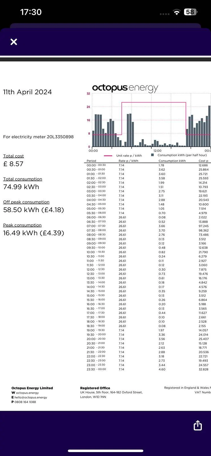

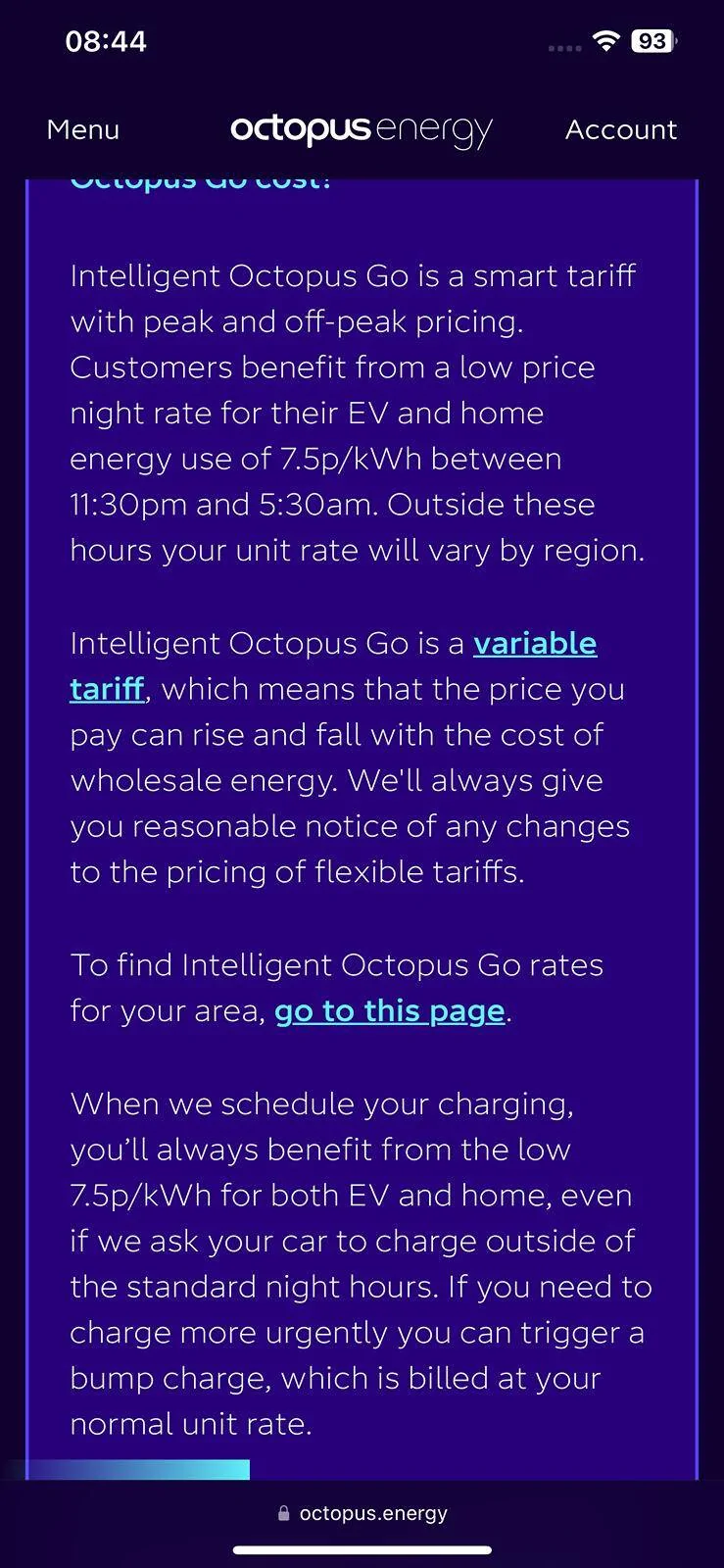

So, bn8959s post caught my interest. Only been with OI 3 months but I never knew the whole house got 7.5p when the OI plan was applied ( thought the house was just the fixed 6 hours). I’ve now read various internet sources and tis true…
I’ve ratified it also, OI FAQ,

And also looked back on my bill when I accidentally left it to charge longer than I normally do, and just presumed I’d been charged peak rate for the difference over 6 hours but apparently not.. ( see 7pm rate onward )
Porsche Taycan Octopus intelligent last week issues IMG_1161
Genuinely didn’t know this so thanks bn8959 ! I’m going to switch back to smart charging now.
This is why I love having OI integrated to the EVSE. When integrated to the car, OI knows exactly how much energy you need to top up. So if you only need to go 60% to 70% SoC, OI won’t likely give you extra hours beyond your 6 hours. But with the EVSE integration, and setting the app to ‘add 100%’, OI will usually give you up to 12 hours, sometimes more, of low rate - even if you only add 5% SoC to your car in that entire time! (Just have to leave car connected).
