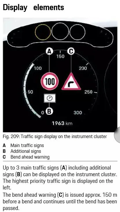

Anything like B shown here?:
Porsche Taycan Odd Clock Symbol Flashed Up 1742918544095-3i
If so it's something to do with roadsigns, though the manual's "additional signs" isn't very helpful.

I can confirm that sign means a temporary speed limit only active during certain time periods. If the clock is displayed, it means it is during that time period.
In the Netherlands, all motorways are restricted to 100 km/h between 0600 and 1900.
Why you would be seeing it on a UK B-road, however, is beyond me.

I think I can confirm @Throb's findings about time-specific speed limits. I believe I've seen the clock icon you describe when driving near schools that have reduced speed on days when school is in session.

Yep, get it most days. I’m just up the road from a primary (or junior as they call it down south) school. Normally a 30, but 20 during school start/ kicking out time.
