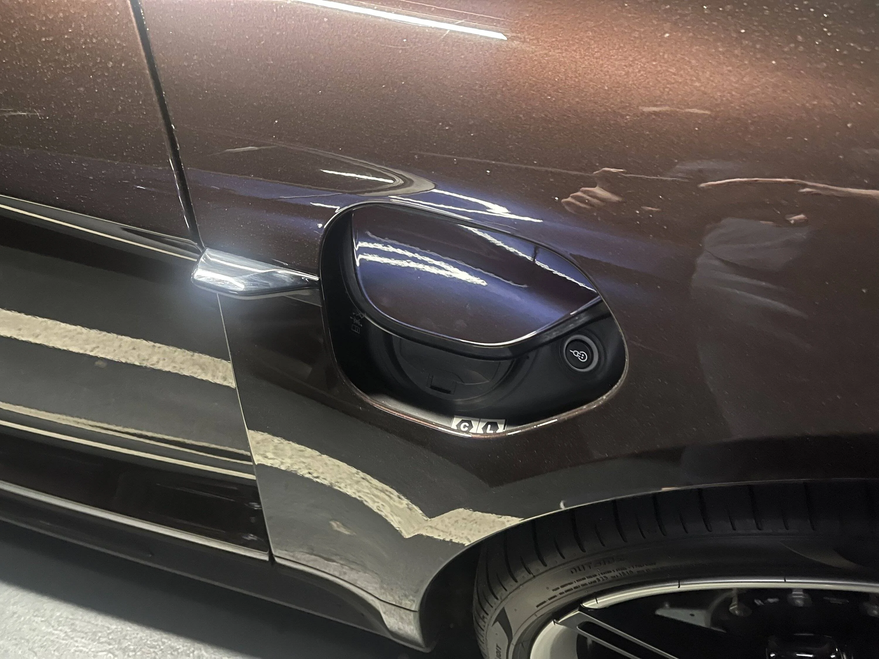

I’m two months and 800 miles into ownership of my 2023 Taycan, and today the same problem presented itself on my car! First, I received the message Charging Port Impaired. It was referencing the passenger side AC/DC port, which has never even been used so far. My Porsche Wall Connect Charger is to the left of my car, so I always just use the driver’s side charge port for AC charging. Seeing the error message, I got out of the car and tried to open the passenger charge port (I have the motorized covers) and it would not open! I then went to the driver’s side and tried to open that door, and it opened half way, and got stuck not fully opened! I tried hitting the stop charging button next to the charger port and it didn’t do anything. I tried swiping the actuator and the door tried to shut but would bounce back up to the partially opened position.
I tried walking away from the car with it locked and coming back an hour later, but the problem still persisted. I thought I was going to have to drive to the dealership to bring the car in for service…..until I read ciaranob’s post above! I followed his steps of swiping the actuator, and stopping the door from coming down a few times, and on the third try, the door fully opened! The door then shut fully and ever since then, it’s been fine! No more error message, and both doors are working fine now.
I’m not happy with the quirks of the car, but for now I’m glad I resolved my issue, and I’m grateful to @ciaranob for his post, and for this forum for the great sharing of knowledge of this fine car! ??
Pics of my situation:
Porsche Taycan Driver's side Charging Port door won't close and Passenger side won't open. IMG_2819
Porsche Taycan Driver's side Charging Port door won't close and Passenger side won't open. IMG_2820
