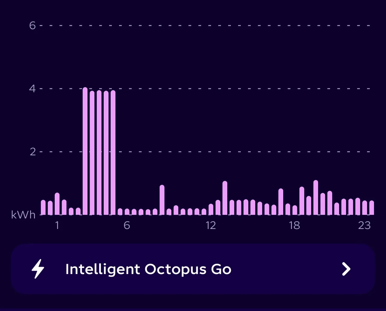

New Taycan Turbo S owner here coming from the Tesla ecosystem and I too was very confused with the Porsche charging setup. After a few nights of trial and error I think I’ve finally sussed it.
I have Octopus Intelligent Go, a Tesla Wall Charger and still have a Tesla Model 3 Performance which is configured with Octopus.
in my situation I don’t commute so don’t need to leave at any specific time, but I would like 85% charge so the car is ready to go in case the mood strikes. Sometime I have to do early morning trips to visit clients, in which case I do have a target departure time and want 100%.
Here is what works for me:
General Profile [enabled]: left as standard - 85%/optimised charging.
Home Profile [enabled]: Location set to home/25%/Preferred charging period/23:30-5:30.
Timer 1 [enabled]: 9AM/Repeat all week/Climate disabled/Charge enabled/85%.
Timer 2 [disabled]: 9AM/Repeat disabled/Climate enabled/Charge enabled/100%.
This setup gives me 85% ready to go every day, and I’ve checked the Octopus app and can see that Porsche is doing the majority of its charging within my preferred window, only falling out of it if my car is lower than can be charged within the 6 hour window. It also leaves it as late into that window as necessary, which is great.
You can see in the attached screenshot that Porsche started my charge around 2:30am until sometime into 5am, because my car was around 50-60% charged when I plugged in, which is ideal behaviour for me.
Then if I need an early start, I disable Timer 1, enable Timer 2 and set the departure time on Timer 2 to whatever time I need to leave.
Note: I have a feeling I could leave Timer 1 enabled and this would still work, but I haven’t fully tested it yet.
Porsche Taycan Off Peak Charging - could Porsche have made it any more difficult! IMG_6793

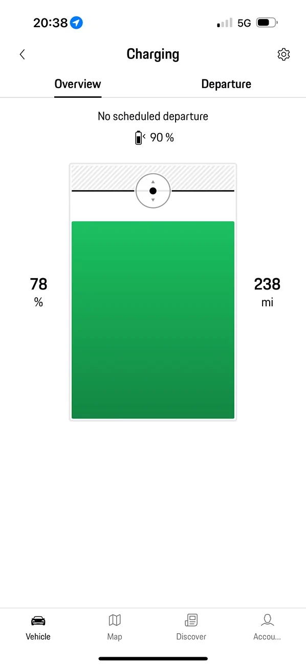

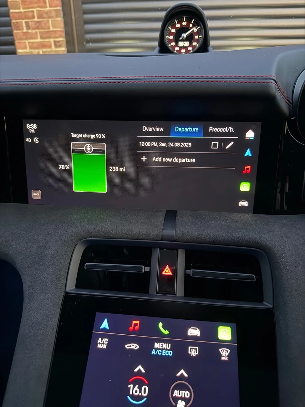

SWTaycanSTgts
Aug 22, 2025
united kingdom
25 Taycan GTS, Range Rover Sport, Maserati Levante Novitec
Porsche Taycan Off Peak Charging - could Porsche have made it any more difficult! IMG_0486
Porsche Taycan Off Peak Charging - could Porsche have made it any more difficult! IMG_0484
I cannot find any where on the app or PCM in relation to profiles. I’m quite stumped but assume I must be doing something wrong. Images attached for reference.
The app is connected to the car and I’ve been using it to control various things, successfully, all week.

How funky. The BMS on your MY25 is different to my MY22 In that you appear to have the ability to set the target charge level via a slider. But you have no Profiles any longer. Does the Charging section of your manual still mention charging Profiles? In the absence of a programmable timer on board, you would have to fall back on programming the charging window via your charger. Which is what a lot of folk do anyway.
11,016
6,805
Profiles aren't part of MY25 onwards. Slider was introduced as part of MY25 updates. Various other enhancements to the charging process and capabilities also added.
11,016
6,805
Removed for MY25 (J1.2) onwards.

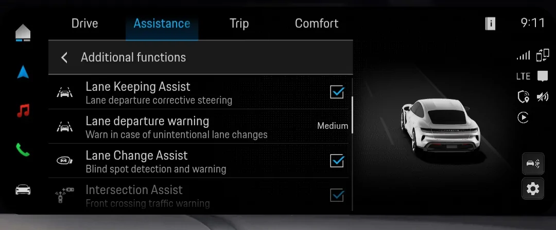

SWTaycanSTgts
Aug 22, 2025
united kingdom
Also cannot seem to get blind sport monitoring to function, or find it, and active cruise control. Nothing in the manual on the app corresponds correctly. Almost seems as if the car doesn’t have them.
11,016
6,805
Various sections are missing from the online Owner's Manual.
On PCM select Car then Assistance then Advanced.
Depending on options fitted to the car there are short cuts on the steering wheel stalk to control some of the Adaptive controls and speed limit controls.
Obviously the car must have these options for the menu items to be displayed.
Porsche Taycan Off Peak Charging - could Porsche have made it any more difficult! Screenshot_20250824_093359_Chrome Beta
