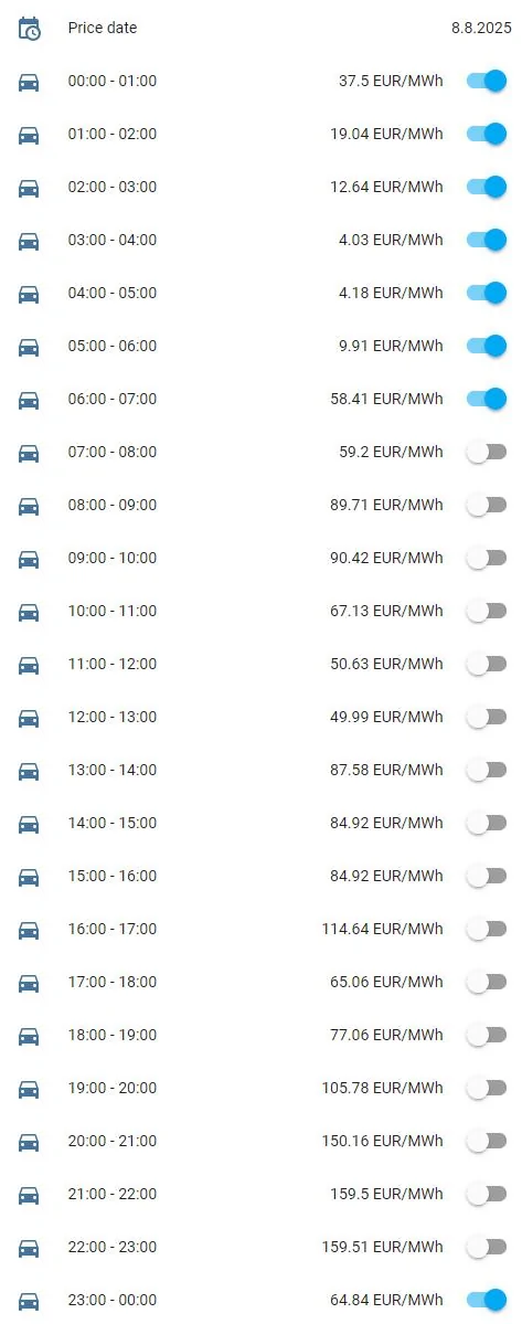

I solved it much simpler.
Wired a SONOFF TH Elite into my Wall charger's disable/key contact (it's there so that they can be turned off from inside with e.g. a key).
Added a little logic to Home Assistant to control it:
Porsche Taycan Off Peak Charging - could Porsche have made it any more difficult! 1754668307196-i
Now I have the prices per hour, and I can flip a switch next to each.
We have two EV's and two chargers with load balancing. They also talk to each other and the master forwards the "key" status to the slave. Otherwise I would have to faff around scheduling on two cars.

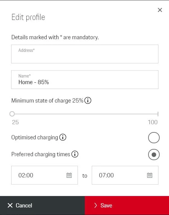

In addition to the Porsche software being overly complex, some of the answers are pretty confusing, at least to me.
Here is a simple goal:
1. Plug charger in at n time (say 7 p.m.)
2. Want to charge to a maximum of 85%.
3. Want charging to begin at n-x hours (say 9 a.m. the next day)
4. Want charging to end at y (say 4 p.m. the next day)
Would someone kindly point me to the steps needed to achieve something like this with the Porsche charging setup? Or is this not possible?
Profile + Timer
You'll need a recurring timer in order to control the end of a specific charging session or if not you'll have to remember to remove your cable by 16:00.
My example here is for a J1.1 4S from 2021 using Porsche Mobile Charger Connect (PMCC). 85% target charge, ready by 07:00 and charge within preferred hours (off peak). Car charged within parameters set when connected on days chosen.
Porsche Taycan Off Peak Charging - could Porsche have made it any more difficult! Profile - Preferred Charging Tim
Porsche Taycan Off Peak Charging - could Porsche have made it any more difficult! Daily Timer
