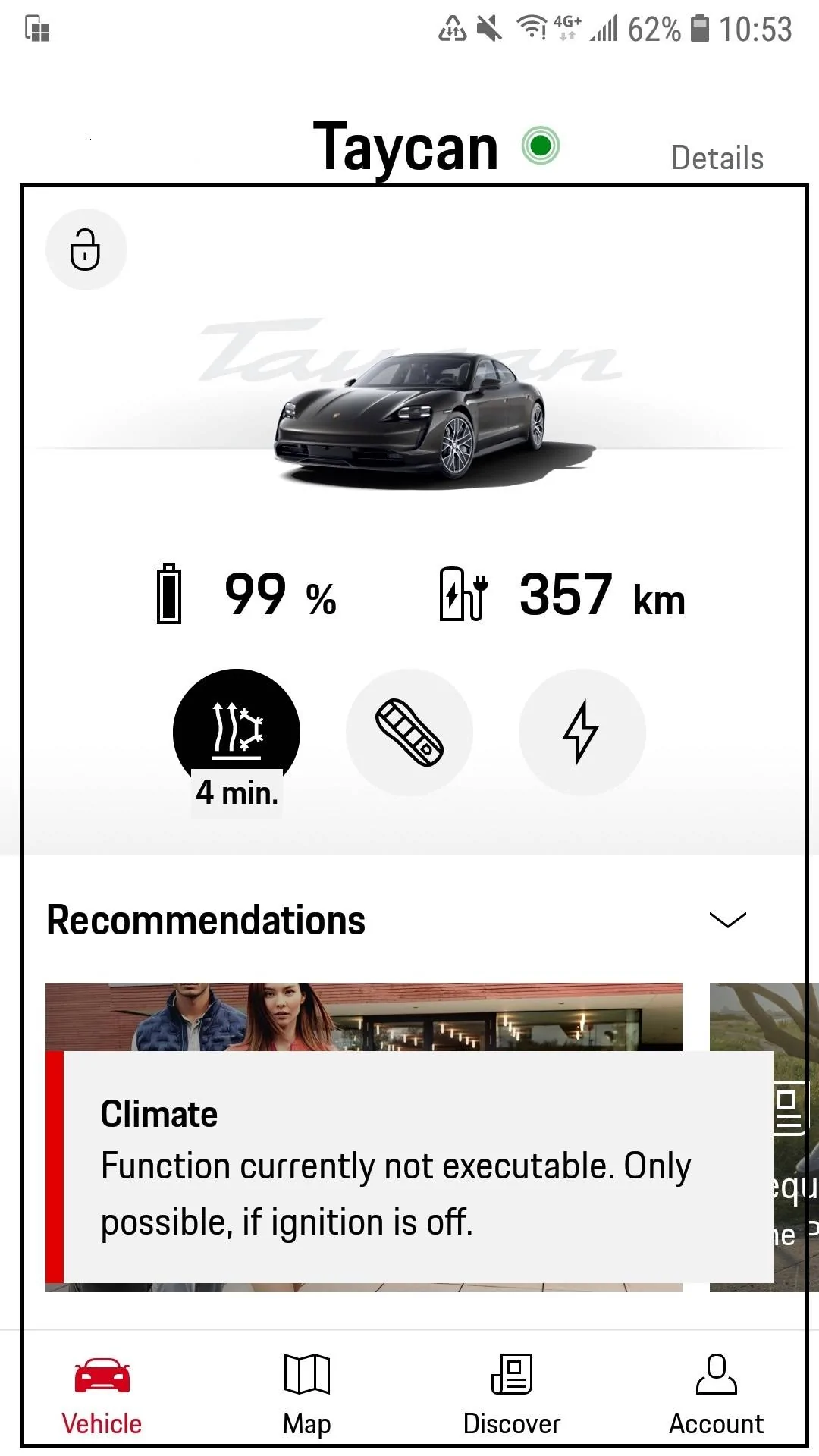

Porsche say Heat Pump is ONLY working with "Activated air-conditioning". Means Heat Pump is only saving energy when AC is activated. That is a different thing AC OFF saving energy by not using the compressor.
I am confused with it a bit, since -according to the description- HP is only working with AC ON, that uses a compressor that uses extra energy....
So should we keep AC ON below 20C to enable HP or saving energy of compressor with AC OFF and not using HP that questioning the meaning of the HP at the same time (???)
It seems to me the (AC) compressor is an active part of the the HP system that is why it should be kept on, otherwise it became a deactivated/useless equipment of the car .

I am still not sure about that, keeping AC off lets the HP system working... According to the description clearly not.
