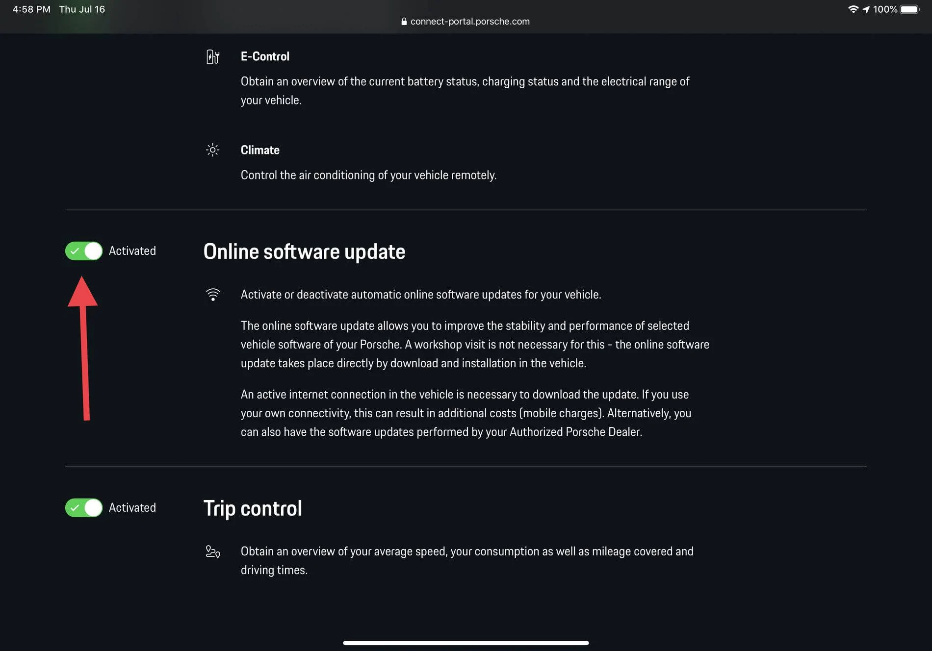

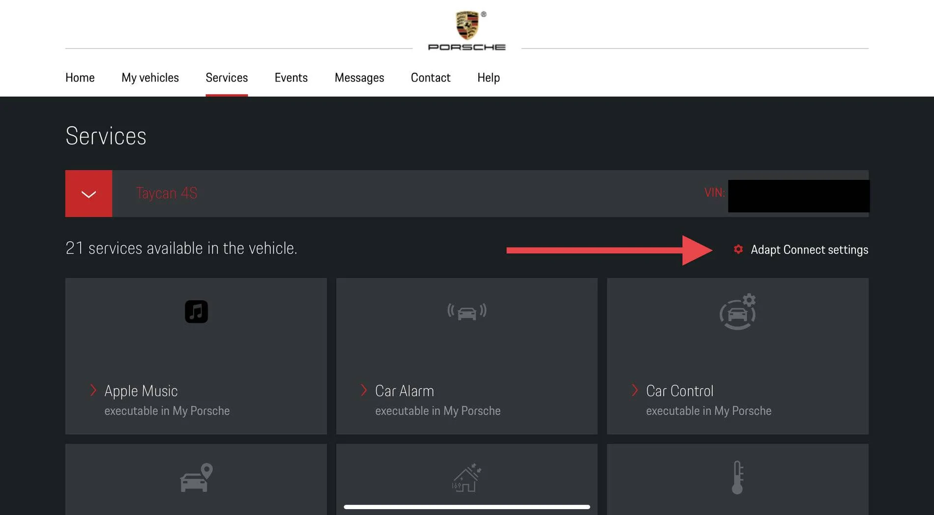

For OTA updates, one thing you need to do after getting the car setup with your Porsche ID and the mobile app connection confirmed, is head to the web portal for Porsche Connect and make sure Online Software Updates is enabled, per my screenshots below.

Thank you for that. My dealer's Taycan expert was sure everything is on for OTA updates. Looks like he missed on this spot - it surely was off.....
That was a good advice! Surprising if that was not turned on at delivery!
