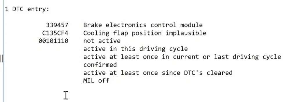

Quite a few error codes. Just a few stuck after a clear.
OTAFC:
Porsche Taycan Part 1: MapEV Diag 1751996317935-u
and
Porsche Taycan Part 1: MapEV Diag 1751996374397-y

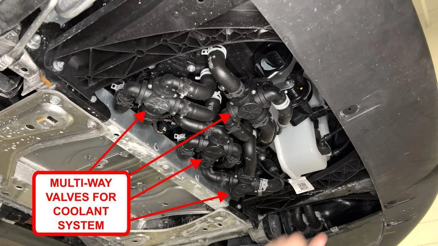

Quick google search returns some hydraulic unit as part. So seems to be one of the many hydraulic pumps valves /flaps in the shitshow that is the cooling system of taycan. I suspect this error is just a software glitch resulted from the 3 or 5 revisions Porsche did on the cooling block on taycan thought the years.
Initial shitshow
Porsche Taycan Part 1: MapEV Diag 1751997945433-63

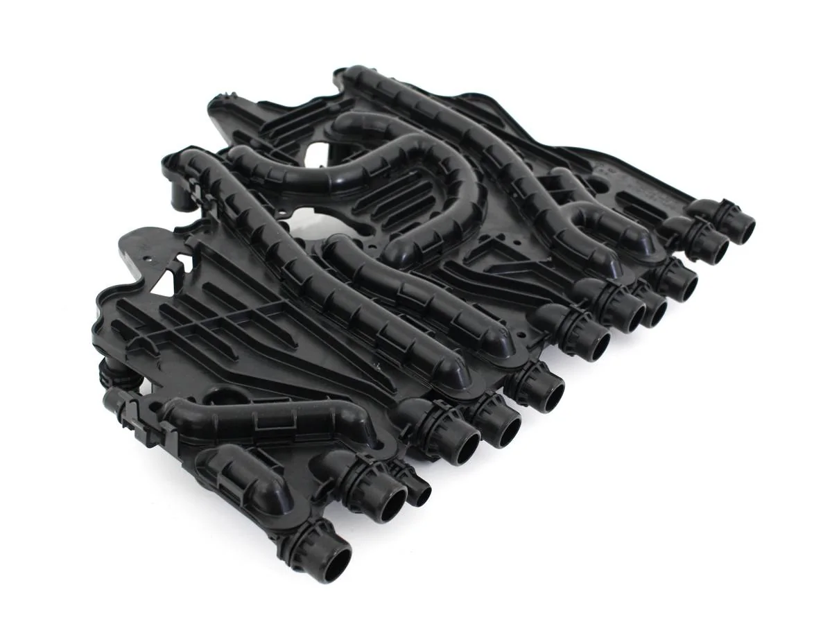

New replacement since my2022 is some sort of metalic monoblock similar to below, can't find picture:
Porsche Taycan Part 1: MapEV Diag 1751997992861-cn
There is a non-zero chance most cars that went through a heater replacement had this mono block also changed, resulting in some valve sensors remaining useless, hence the error above.
Never went under my car to confirm however; so could also just be the complete opposite, where a manifold is expected in the software, but instead you have the old shitshow.
I'll just leave all the codes gather from now, and see what porsche says.
