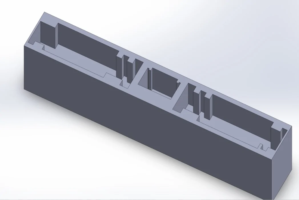

I think extending the harness is the way to go:
Porsche Taycan Part 3: The Quest for the Perfect Tune 1777066229717-yu
Marc has gotten started on modelling the connector, then we probably need a small PCB and then pot the entire thing, and make the harness.
I don't think in limited quantities this will be particularly cheap per unit, I'll consider it a sucess if we can manage to keep that under $300 and very glad if it turns out to be around $200.
Of course if we ordered a big run of them from China then it would be a LOT cheaper, with the current volume we'll probably have to 3D print and hand assemble everything in the USA, which has the pricetag to match.

That would have to be a massive flap, and on the CT the liner is made of hard material, as it's more structural, so that's a non starter.

Would a low tech version just be an extension harness and some Velcro to hold it in place? The unit itself doesn’t seem super fragile and it’s pretty light.
The lions share of the expenses is labour for the loom and creating the custom connector.
Making a slot-in frame that locks into place is cheap, I'd say under 30$, it's literally a couple sticks arranged in a particular fashion with a slot where you can click in the ECU.
But sure, some Velcro stuck to the back of the unit would work in a pinch as well, but I don't really see the point when you can do it properly and it doesn't add much expense.
Ironically your reaction shows very well how the customer sees a frame and thinks THAT is expensive, but a bunch of wires is seen as cheap - it makes even more sense to do the frame then, as the customer feels that they are getting more for their money ;)
Unfortunately custom connector and then terminating like 50 wires to it is what is going to be $$$ unless it's mass produced in China, but we're never going to have that volume, I don't see myself ordering like 1000 units of that (which would be needed to drive cost price sub $50), that said I do expect to hit 1000 cars tuned by MapEV in the not very far future, but I think only a fraction of the customers will go for the extension loom.
We are definitely going to work on it though. Much more relevant for the sport- and cross-turismo customers. It still takes me around 20 minutes to swap the ECU on my CT and I've done it over 20 times. All the little clips and having to take care of them and then re-aligning the trunk seal each time just takes time. Plus on the CT you have the additional torx and the speaker cover.
Ah that makes sense. Didn’t realize the connector/wires used a custom/unique setup.
And I have zero interest in splicing 50 wires with longer wire! :oops:
