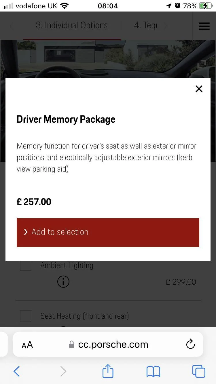

Also worth noting for OP perhaps and anyone following this thread that the dipping passenger (only) side mirror is not a function with the base 8 way seats unless you have Driver Memory Pack. Standard with 14 or 18 way seats.
It actually is included with even the base seats, at least in the US. I have the feature.
Always subtle differences between Euro and US spec. I just checked the configurator. You still need Driver Memory Pack in UK at least if you only have 8 way seats.
