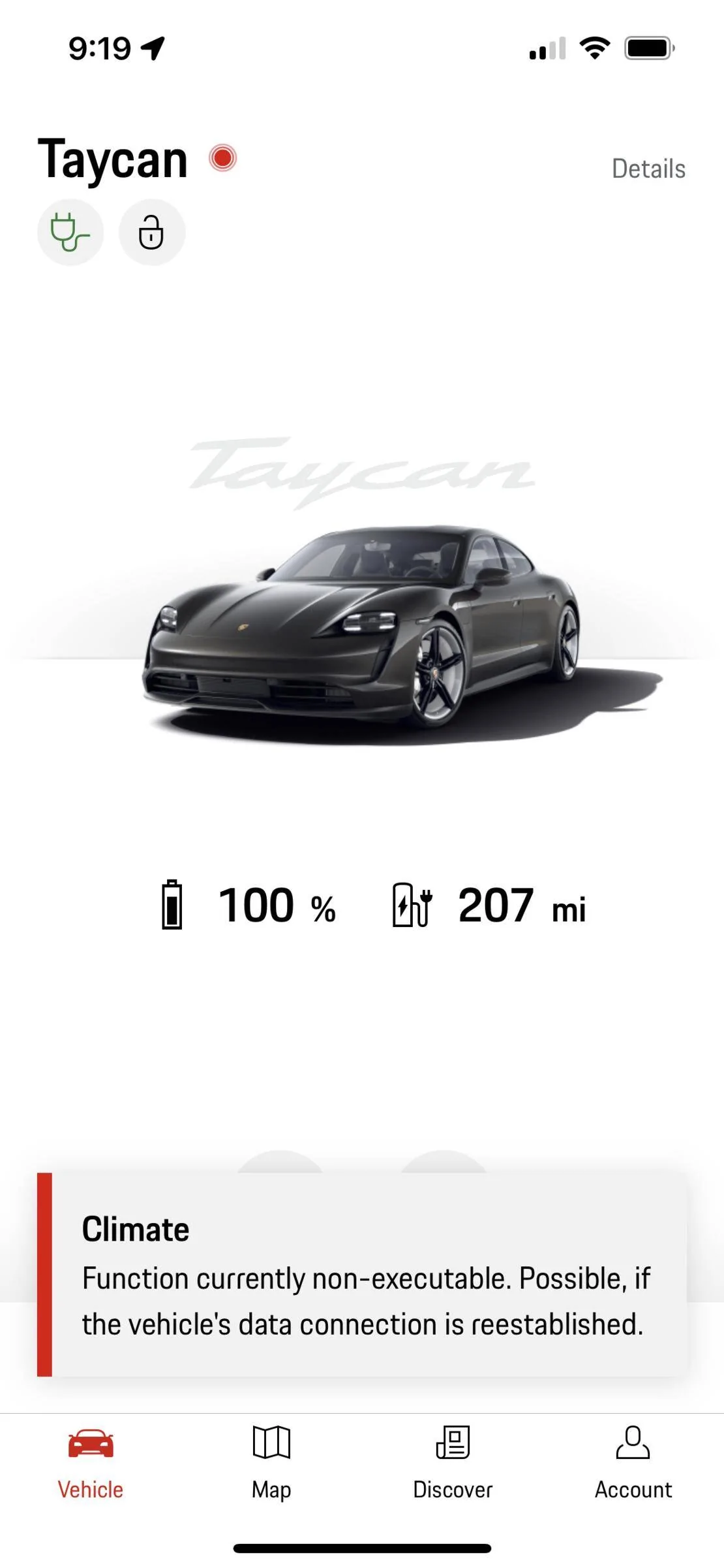

I can’t turn on the heat or cool anymore via the app. All of a sudden its been saying the below. Ive tried restarting my wifi, also just using LTE. I tried shutting off the wifi in the car and back on.
Any advice?
“Function currently non-executable. Possible, if
the vehicle's data connection is reestablished.”

Do all of your other connectivity features work in the car? Bluetooth, Apple Music, Online voice recognition?
My Communications Module crapped out and I lost all of this. It needed to be replaced at the dealers, took a day for them to resolve as the parts were in stock.

When you turn on the car, you up in the overhead console you should have a solid green light, this is the LTE connection. If you do not have the light after several minutes, you have an issue with the communications module or sim registration.
