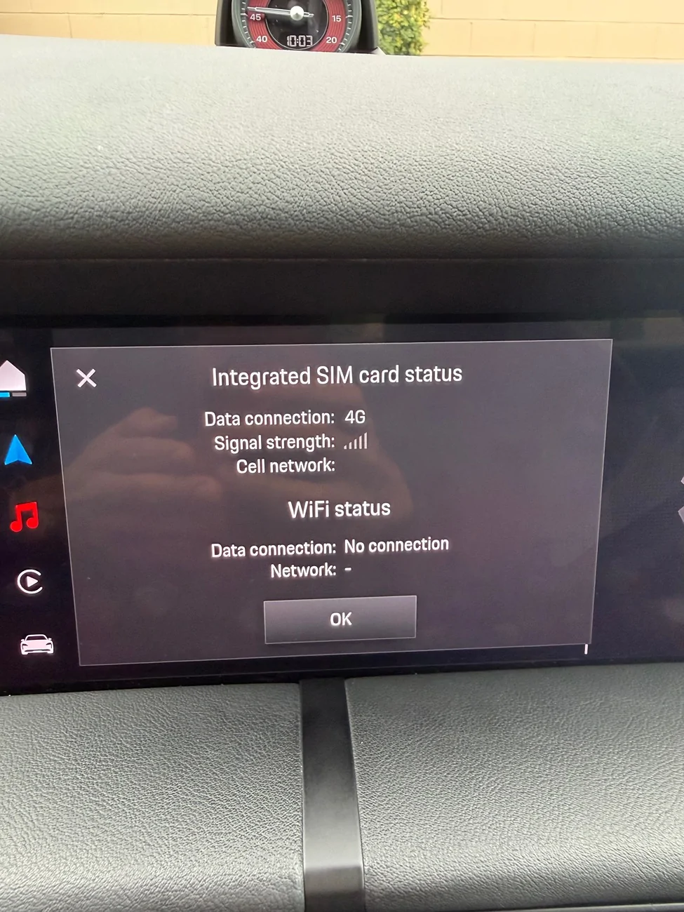

There is a cell sim in the connbox, that sim has a data plan that most likely has no data available.
You can see the PCM indicates about an error when you with check the connectivity menu (I can recall how exactly to get to it) that says “data not available”
I found a photo of Thai when I was sending it to the Connect support team:
Porsche Taycan J1.2 Latest PCM version + Connect/communication module issue. IMG_9316
