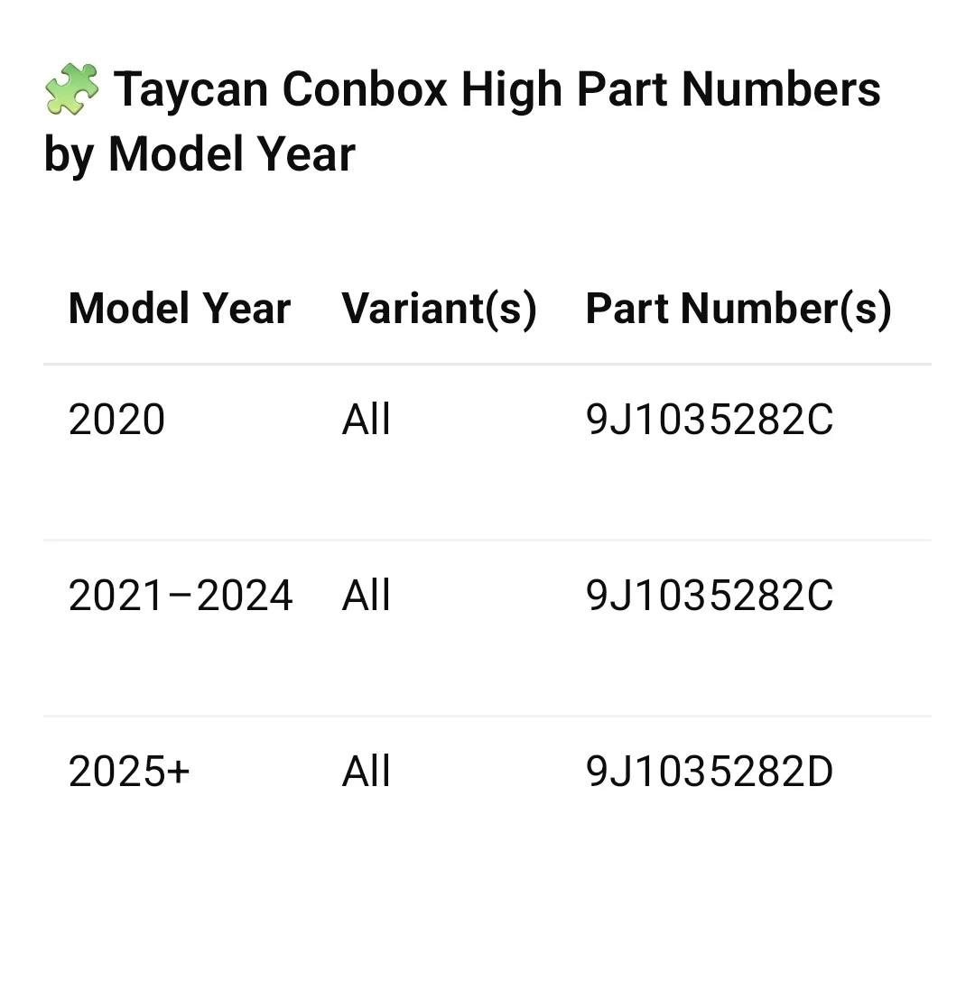

Slight mod to the Conbox High to accommodate 4G.
Porsche Taycan J1.2 Latest PCM version + Connect/communication module issue. Screenshot_20251018_214912_ChatGPT

I wonder if someone with a MY25 J1.2 Taycan has 5G as a signal as the ConBox should be the same as MY26?
I have 4G, but windering if the hardware is 5G enabled.
I was wondering the same thing. Maybe check the part numbers?

I don't believe the '25 Taycan is 5G enabled, I only see 4G in the PCM even when I have 5G on the cell.
Yes, likewise with mine. The question is could it be updated to 5G without new hardware. Interestingly the Macan EV, which is of course Android Auto so completely different, just had an OTA update which enabled 5G.

The hardware in the MY25 (and even in MY24 AFAIK) is 5G enabled. The regional eSIM cards are the limiting factor. Germany has a Vodafone service that is 4G limited. If I drive to the Netherlands and on roaming, I get most likely 5G ( to be tested though )
The MY26 cars have a 5G Vodafone eSIM contract from the outset.
