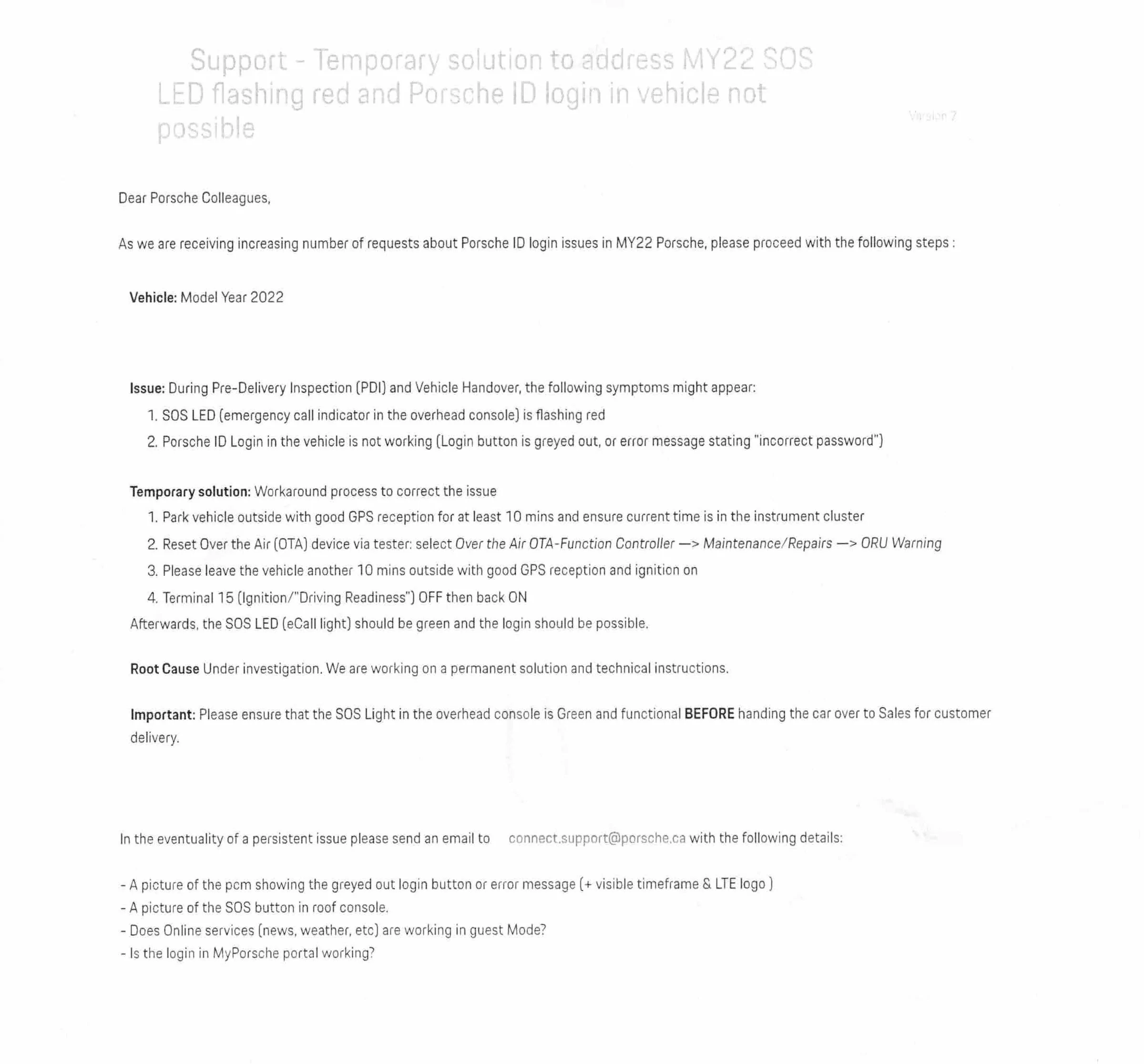

Hi guys, We took delivery of a '22 Taycan 1/4/22 from a northern CA dealer. The SOS module was red. We were not able to log-in. We hardly really drove the car. I tried several times to log-in but it was stuck in guest mode. We received a base loaner Macan 1/21/22. The dealer said they tried resetting the PCM several times but that did not work. The dealer is still waiting for guidance from PCNA. my wife & I paid cash for the car. We are clearly frustrated. Any advice as to what to do? Should we hire an attorney to make a lemon law claim? Do you think they will buy-back the car and give us any cash compensation? Thanks, -Andy
Sorry this happened to you. Did you try the “terminal 30” reset discussed earlier in this thread?
A common experience among the members of this forum is that we have to point the dealerships to the solutions we find here, as for some reason they often can’t get this information from Porsche.

Hi Genau,
we did not try that, but I just got off the phone with a support manager at PCNA.
He was able to pull the history. He said the issue is a software issue on the back -end in Germany dealing with he Verizon sim card and a profile update. It was just escalated on 2.16.22 but we have not heard a response yet. Thanks. -Andy

Hi Genau,
Send this to your dealer and asked them why the car was delivered with red SOS button when their service bulletin specifically said not to. This is a failure of PDI which we all paid good money for.

5 1/2 week in, and still stuck in private mode. I have tried every possible "fix" in an attempt to resolve the issue, with no luck, including 2 plus hours at a local dealer. I had my car flatbed to my originating dealer about an hour away to have them keep it until they fix it. I gave them my log in information/password/4 digit code and told them I do not want it back until it is fixed and they can log in with my account. If not, i am going to just sell it, its not worth the irritation every time i get into the car.

per my multiple emails on exactly the same issue, solution was to replace the over the air module. They can try resetting everything possible, it still will not work. That module needs to be replaced to get functionality back. All the best for a swift resolution.
