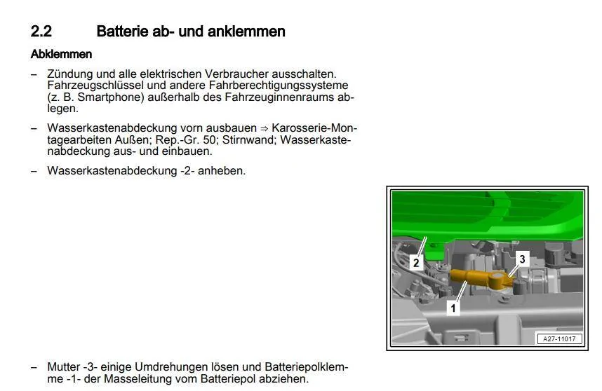

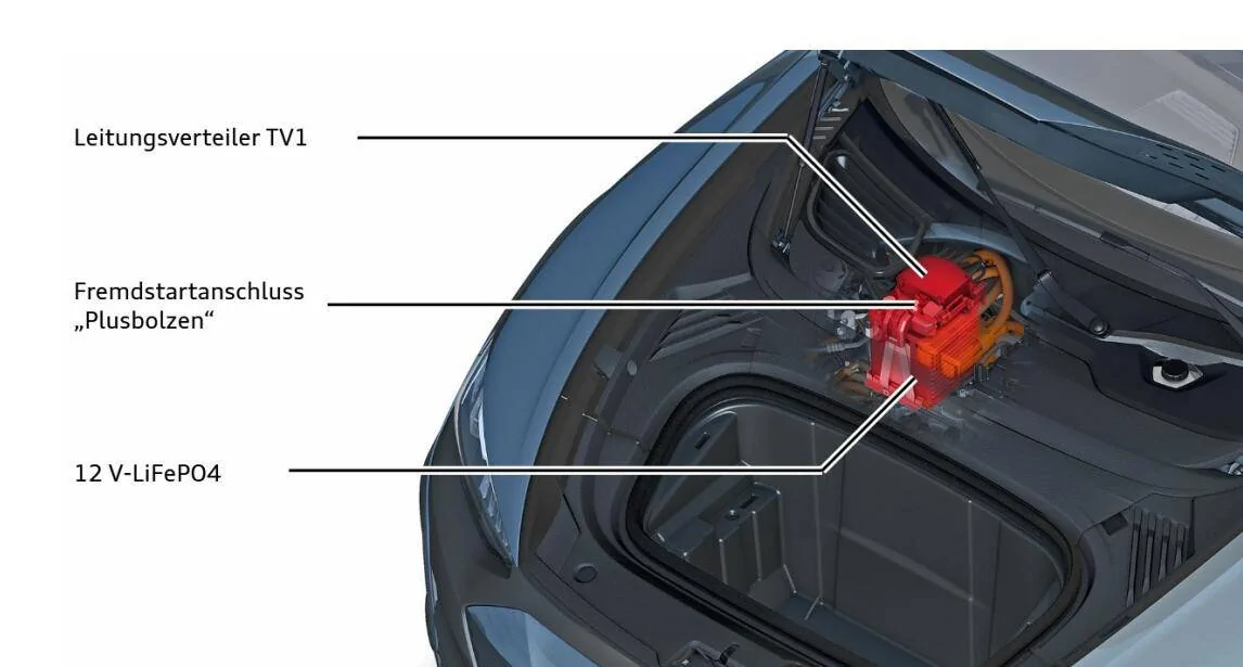

rs38
Nov 16, 2020
703
763
Düsseldorf
Taycan,GT2,i8,Tesla
where is 12v and how do you disconnect? Mine is stuck deeper as you mention. Thanks in advance.
passenger side , frunk under a plastics bonnet.
Porsche Taycan PCM stuck in Guest Mode 1643718670956
Porsche Taycan PCM stuck in Guest Mode 1643718689625
in short:
keep key fob outside the car,
lift plastic cover (2),
loosen the 10mm nut (3),
lift the minus cable (1) for ~1 min.
