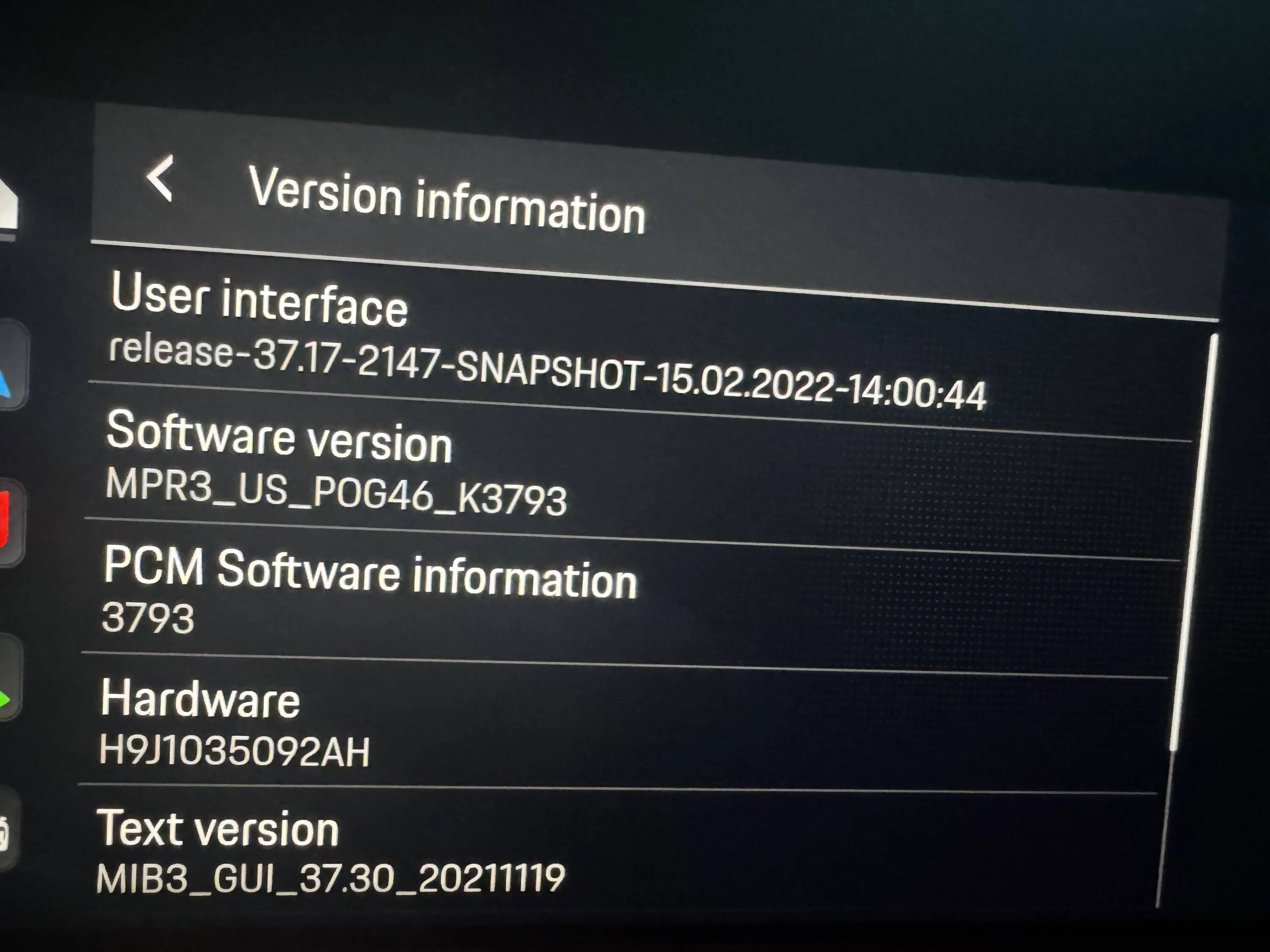

Mine is the older version…
Porsche Taycan PCM Stuck on Porsche screen IMG_0868
88
8,365
7,376
Perhaps take in into service to get it upgraded. Technically it was supposed to be updated over the air, but 2 months after receiving the email from Porsche that my car will OTA, the dealer just did it while the car was in for a different service.

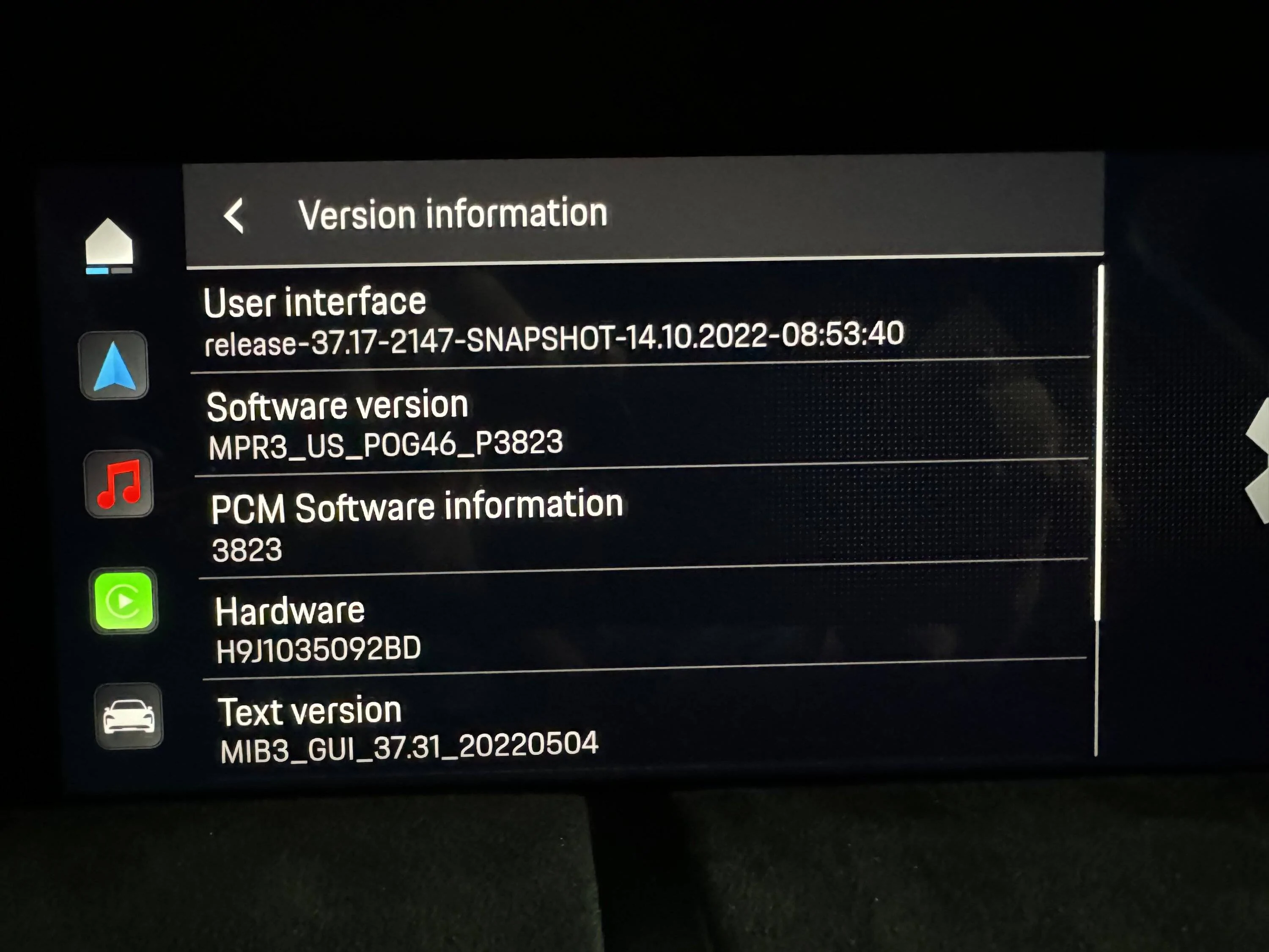

Porsche Taycan PCM Stuck on Porsche screen IMG_4131
My version as of yesterday. Haven’t had the black screen issue in a long time.

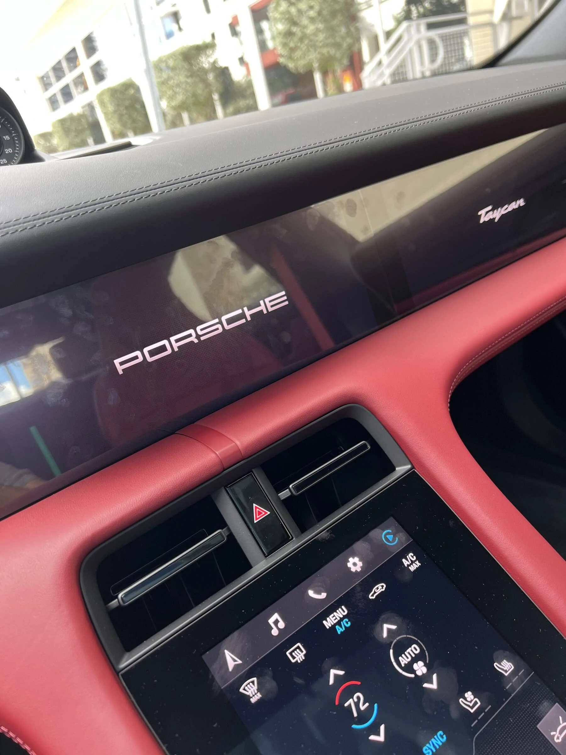

Hey wondering if anyone has seen this before. My new 2022 Taycan 4s is stuck on the Porsche screen... Drives fine and everything. CarPlay still seems to work, but no map in the driver display.
I rebooted into engineering mode 3 times and restarted. No luck. Any ideas here gents? Otherwise I'm taking it to Porsche tomorrow.

Shut off the car for a half hour, usually clears itself. The only time it didn't clear itself for me in the past when I left the car parked in a state park with very spotty LTE coverage, had to wait until I parked it somewhere with solid LTE.

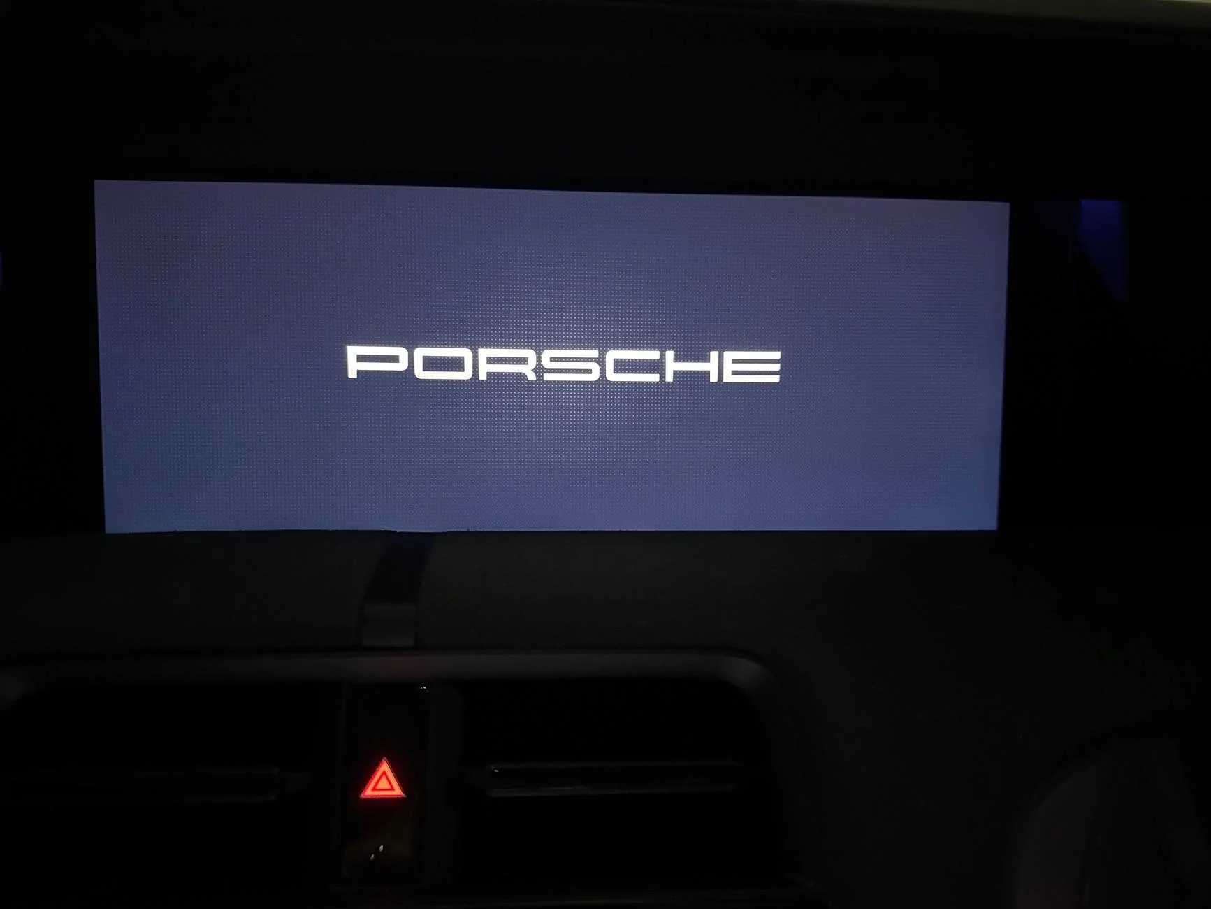

Let’s see what a day at work away from the car does for this issue
Porsche Taycan PCM Stuck on Porsche screen imag
SergeyIndy
Sergey
Dec 19, 2021
2,493
1,905
Indianapolis
This is known to happen from time to time even when the car is in full drive. Leaving it locked and alone for some time cleared it for me. Happened 2 times.

Your backup camera/surround view still works. Actually, even apps on the PCM are running, so you can still use phone hands free if previously paired. Even navigation works (if you navigate by voice) and you can see directions on the instrument cluster. Essentially, every time this has happened to me it seems everything is alive under that PORSCHE splash screen, just software engineers forgot to remove the splash screen at the end of boot. The fact that they haven't been able to fix this in 5 years is a kind of sad. At least they should just add an option to disable the splash screen and just show us the raw boot messages and then eventually the screen. Sure, not a pretty solution, but at least functional.
