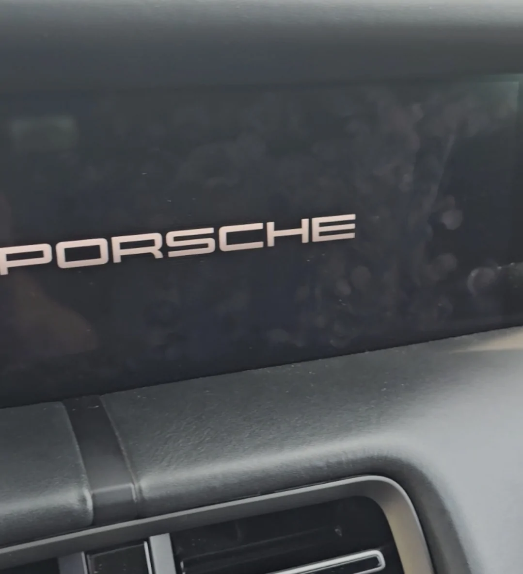

Im in the uk, death screen been on for 2 days now. Did not resolve itself after an overnight lock. Removed the fuse waited for 5 minutes and added back
I have exactly the same since today. Oit of the blues.
I am on the new software 3892 for a few weeks now.
The screen, even after reset, even after >15min wait, does only show Porsche. Can't get in anymore.
Call porsche assistance?
Porsche Taycan PCM Stuck on Porsche screen Screenshot_20260712_132726_Gallery

I would try to disconnect the 12v battery, wait for 30 minutes or so, connect it again, makes everything do a clean reboot.
Isnt that sth to do by Porsche? Otherwise they may claim I temper with the system or so....i may call Porsche assistance and ask. Because normally owners do not disconnect the 12V system no? Just wondering if that is common practice.
Thank you
Update just now.
Waited 20min+ and turned car on thereafter. It worked again, no error codes.
Weird!

Happening to me too a few times now recently. I just lock the car and let i be for a few hours then it comes back normal.

Step 1: At the top right of the screen, hold two fingers, and it should push you to the engineering menu. Select the full reboot option.
99% of the time, this should work, but if you are the 1% like me, then you should open the fuse panel on the passenger side. I think it's row 2, PCM fuse. Remove the fuse, wait 5 minutes, and plug it back in.

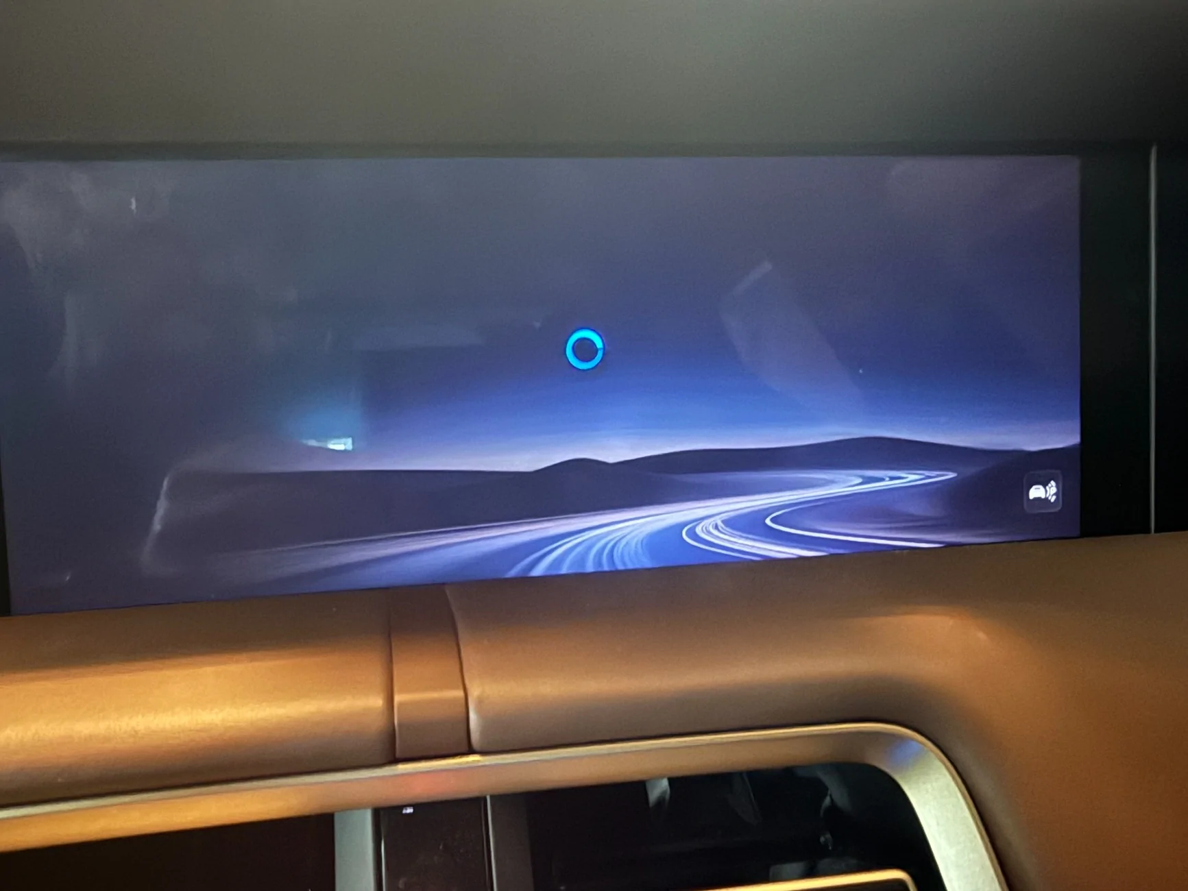

My 2026 PCM is stuck in circling endlessly. I've tried letting it sit overnight, still circling.
The only thing I've gathered from this thread is that disconnecting the 12V battery might help. Is that the current state-of-the-art reset procedure? Anything to be aware of - something more so than doing the same with a conventional ICE 12V battery?

only other option is to pull the fuse for the PCM. Battery disconnect the same as an ICE.

Is that the passenger footwell? I know how to open the passenger side panel, but I don't think its there. Google says its behind the glovebox and to remove the cardboard/felt liner, but google also gets confused on driver side/passenger side.

Gave up and just disconnected the battery. It was easier. Didnt make me recalibrate anything.
