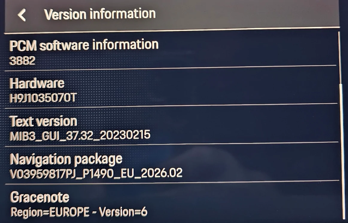

My Nov 2020 controller is 9J1 035 070T

My own asumption, the difference is what software they come preinstalled with (3882, 4360 and 4578)
Replacing the PCM seems to be a quick job, took less than 2h for my car. Put it in privacy mode, take out old part, put in new part, pair it to VIN with PIWIS. Done, no extra coding.
They do have to gather logs/diagnostic before ordering the part.
