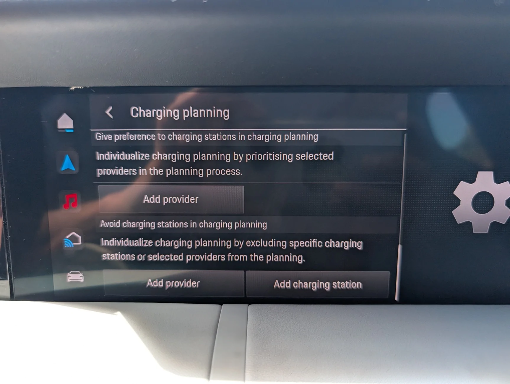

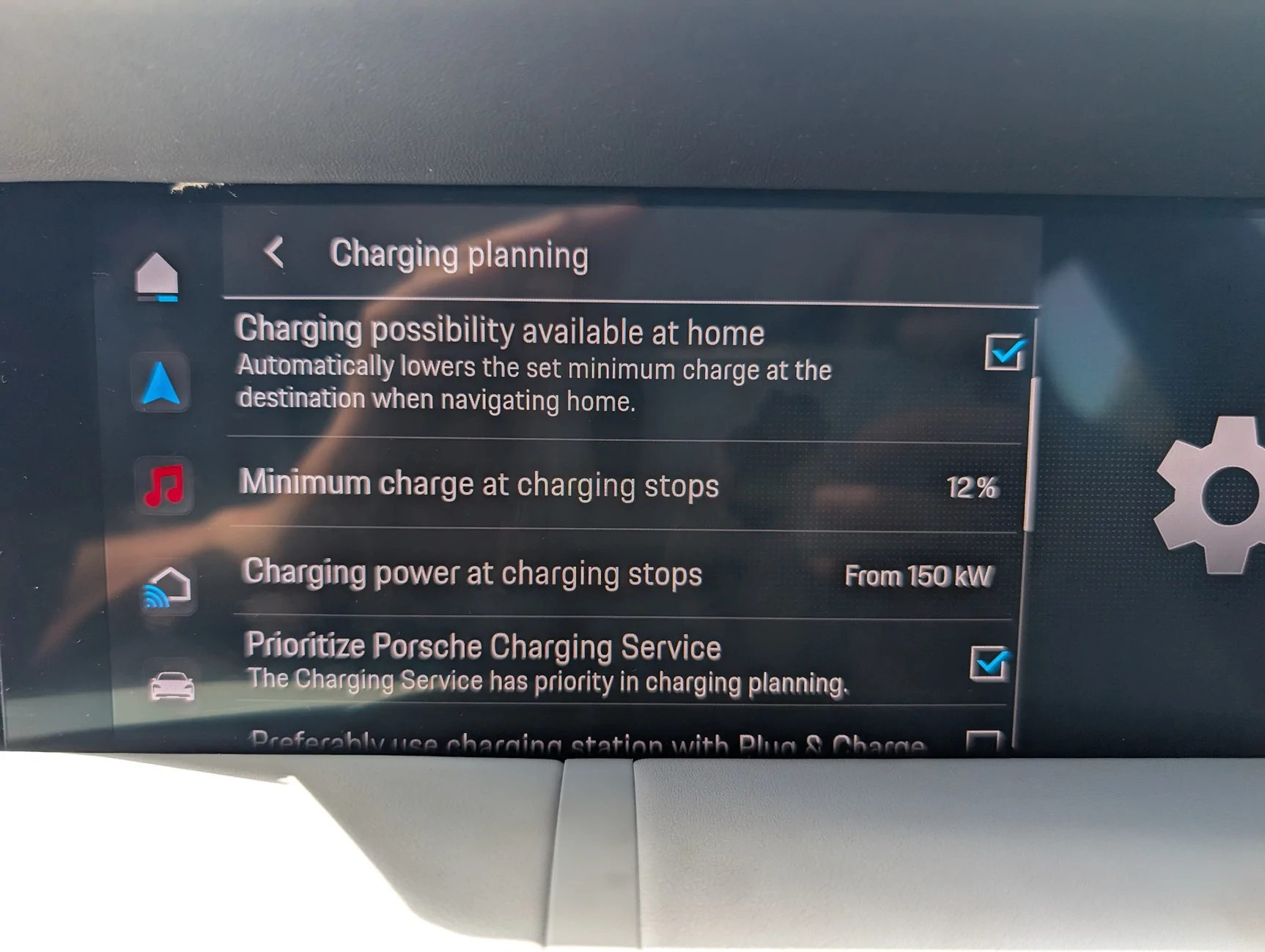

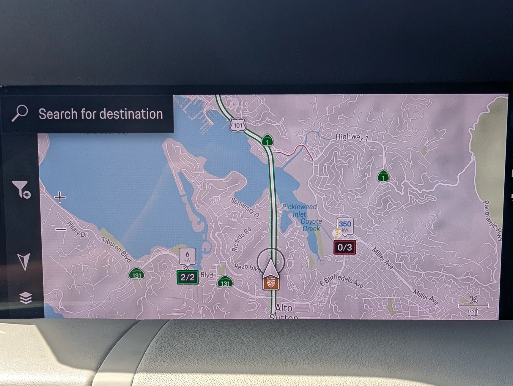

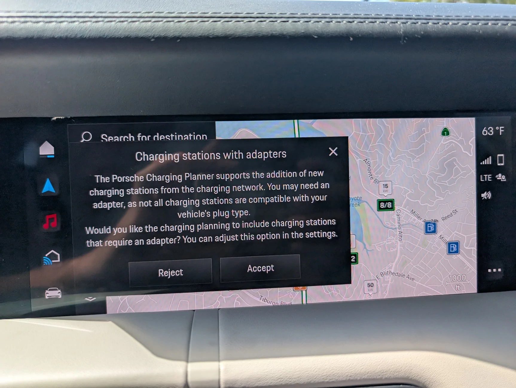

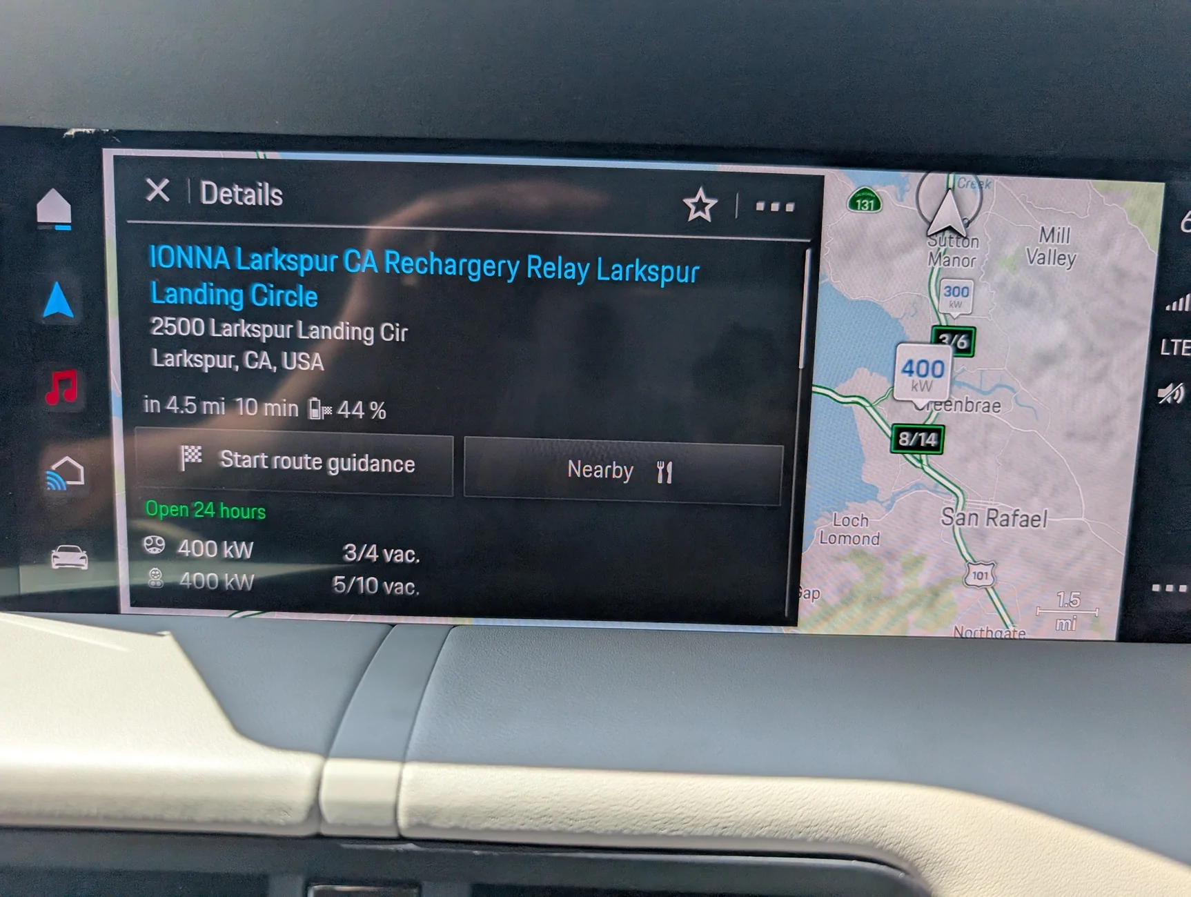

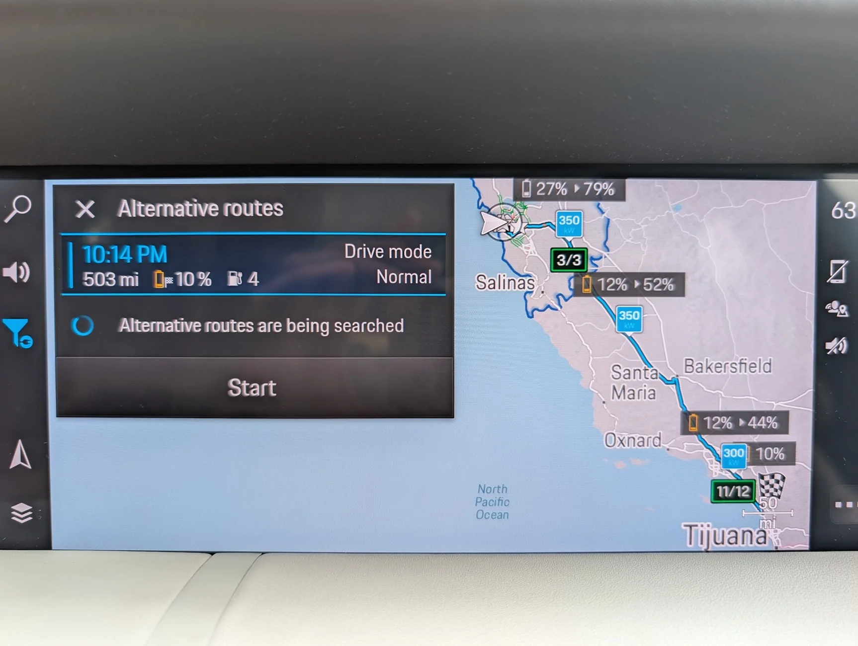

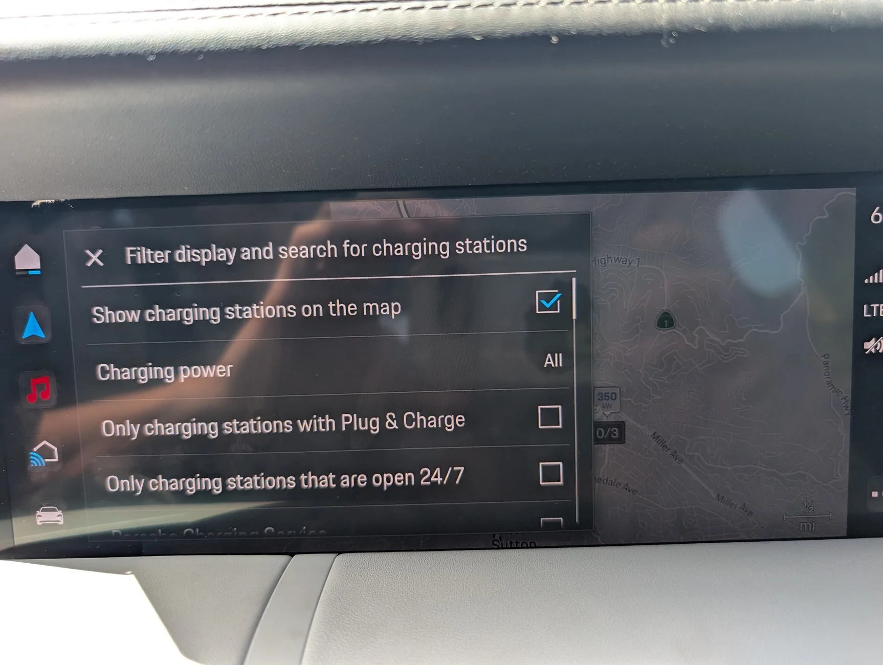

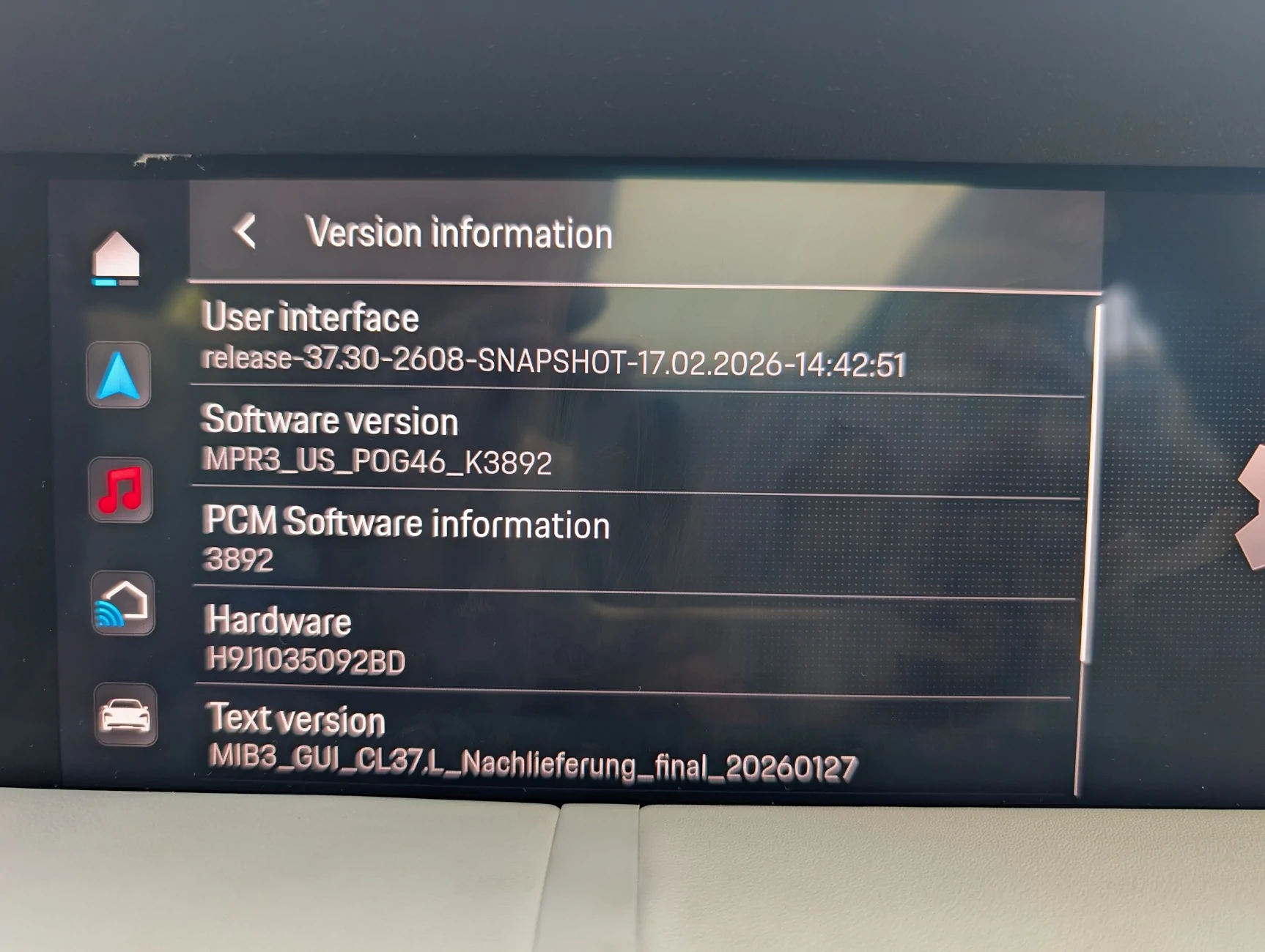

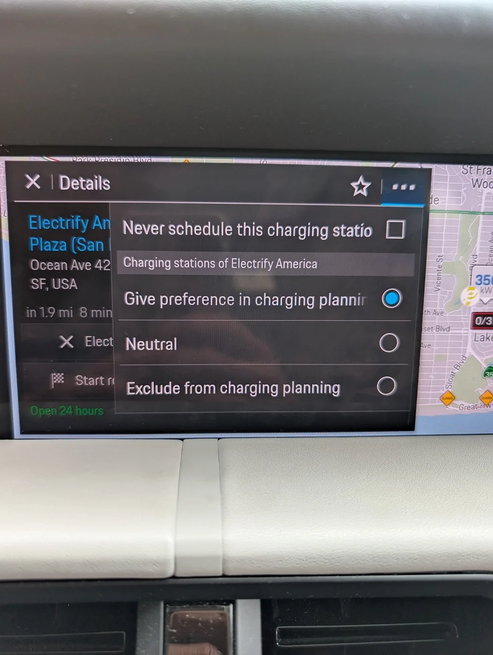

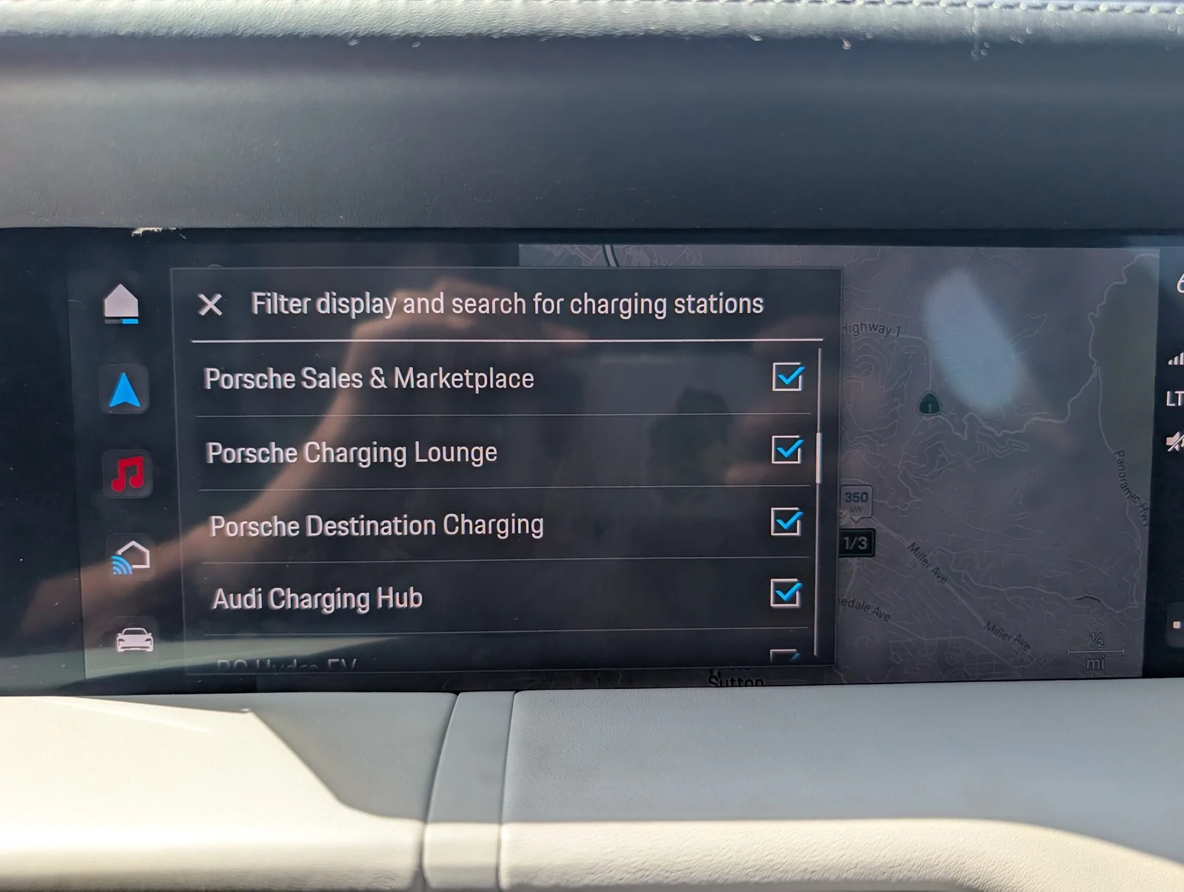

Success! I received the update to v3892. Based in North America, perhaps this is relatively rare? Features and impressions:
1. The major feature additions are related to the charge planner preferences for CPOs. This is a game changer IMO, especially if you don't have the 400v booster as now you can exclude Tesla sites. This is also very important for roadtrippers who prioritize certain CPOs and high-speed charging (Rivian, Pilot) etc.
2. The overall look of the UI of the map has changed. I can't quite describe exactly what is different but colors and fonts feel different. Enriched CPO site information is now directly on the map. Business information menu is also rearranged, CPO preference shortcut were added if CPO is the business selected.
3. The map's overall responsiveness has improved. It feels zippy when you zoom and move the map.
4. The charge planner's computation appears to be slower now. The more adverse impact is the alternative route suggestions appears to populate slower too. This is likely bc of the new charge parameter filters, bc if the trip doesn't require multiple charging stops on the planner, the computation responsiveness is just as quick as prior version.
5. There is a shortcut to plan a round trip after you start the trip planner. This is a nice feature which allows you to plan for additional charge stops if needed.
Overall if you road trip, don't have the 400v booster and use the native PCM planner this update is a must! I cannot believe I've lived with 3882 for the last 2 years.
