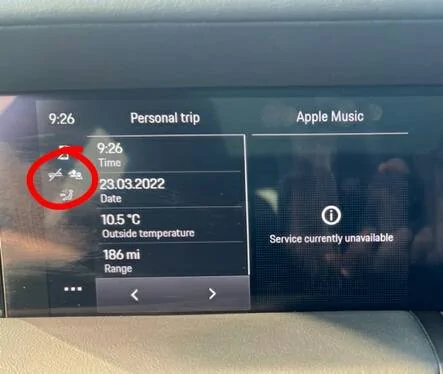

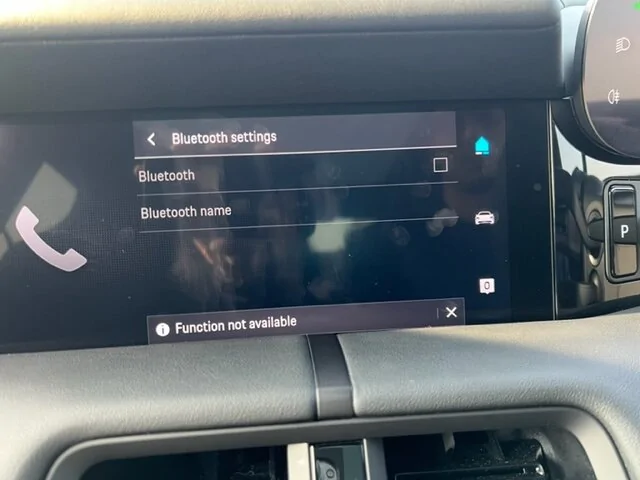

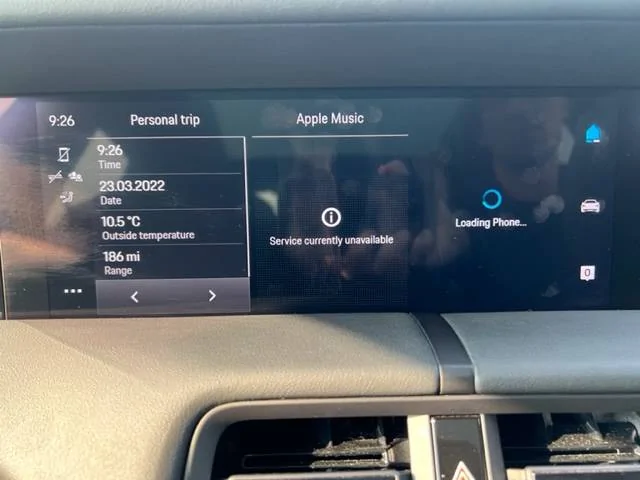

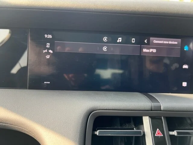

I have the same issue described by @tigerbalm in his opening post.
It has so far never happened to me after the vehicle has been stopped for a prolonged period of time (e.g. overnight) but happens frequently after being locked and left for a shorter period (e.g. 10 mins to 2 hours). It usually fixes itself the following time I lock and leave the vehicle for a while.
Doing the PCM reboot on the central display has solved it for me a couple of times but not always.
Porsche Taycan Communications Issues [PCM/App/Porsche Tracking] IMG_6023
Porsche Taycan Communications Issues [PCM/App/Porsche Tracking] IMG_6024
Porsche Taycan Communications Issues [PCM/App/Porsche Tracking] IMG_6025

Porsche Taycan Communications Issues [PCM/App/Porsche Tracking] 2022-03-23_19.09.54
This image shows there's no cellular connection (the =/=).
This also occurs on low/poor covered areas.
It isn't necessarily the PCM's fault but the cellular network for whatever reason (provider issue).
At my work I sometimes can't "see" my car in the app, you guessed right, it's a poorly covered area...

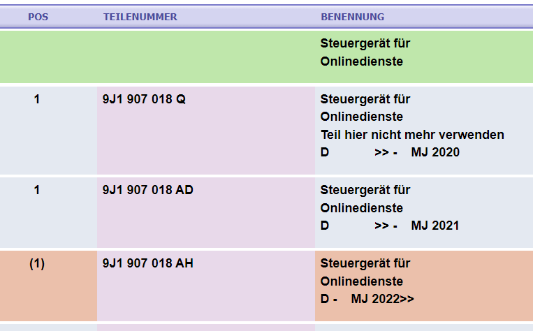

PAD 035 282 B same as
9J1 035 282 C : Steuergerät für Notrufmodul (ECU for Emergency calls, new to me, dedicated ECU with own antenna, I will check further) is this CONBOX high?? Has an own battery?
9J1 907 018 AD: Steuergerät für Onlinedienste (ECU for online services aka OTA Box aka Communications box aka phone box ) This ECU has already been replaced in my car too
9J1 907 468 C: Steuergerät für Gateway (CAN Gateway ECU
Where is your car parked when this occurs?
I think you've spotted a symptom, not a cause.
There is no cellular connection nor internal bluetooth/wifi connection whatsoever - see photo 3 showing 'Function not available' on the display when I attempt to enable the bluetooth (which should ordinarily be enabled already since I did not switch it off).
The internal bluetooth connection cannot be explained by low cellular network signal regardless of location. For completeness sake since you asked, the particular example photo I posted was taken outdoors in a suburban area of high cellular connectivity.
The crux of the issue is that all wireless communication devices installed in the vehicle, both internal and external, stop functioning at the same time. It's as if the comms system doesn't 'wake' correctly on some occasions when the vehicle is switched on.

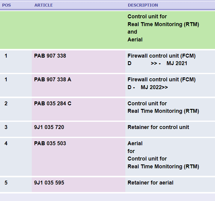

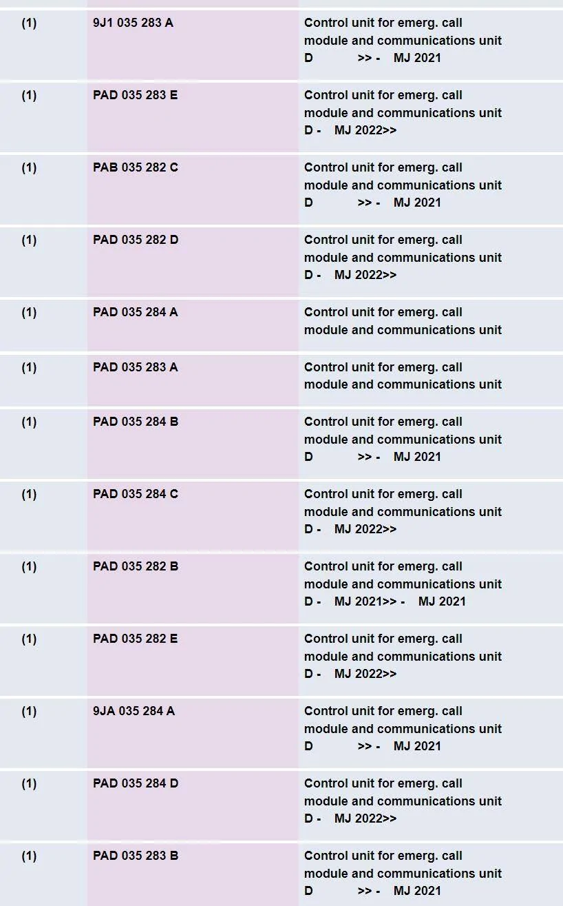

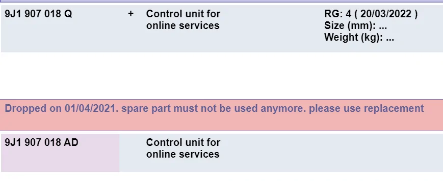

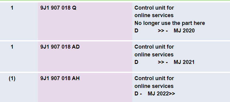

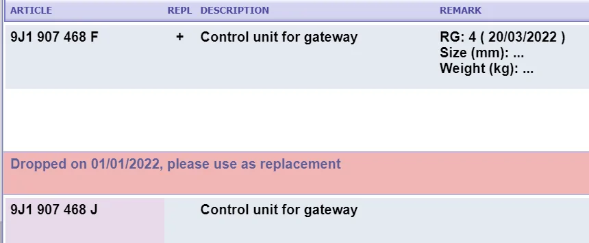

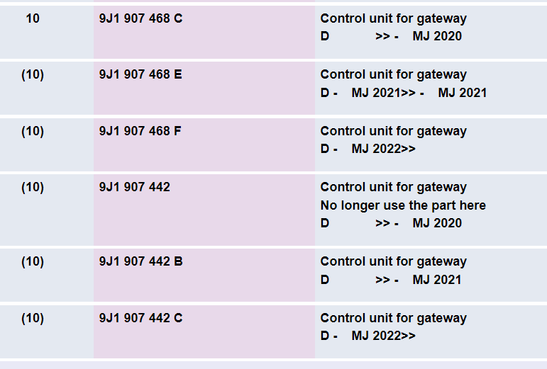

here some partnumbers and replacements MJ specific of the above mentioned ECUs:
Porsche Taycan Communications Issues [PCM/App/Porsche Tracking] 1648461019065
even the lastest MJ22 has been replaced?
Porsche Taycan Communications Issues [PCM/App/Porsche Tracking] 1648461594032
Porsche Taycan Communications Issues [PCM/App/Porsche Tracking] 1648461093197
this is only fraction of all parts because they obviously contain region specific stuff:
Porsche Taycan Communications Issues [PCM/App/Porsche Tracking] 1648461208508

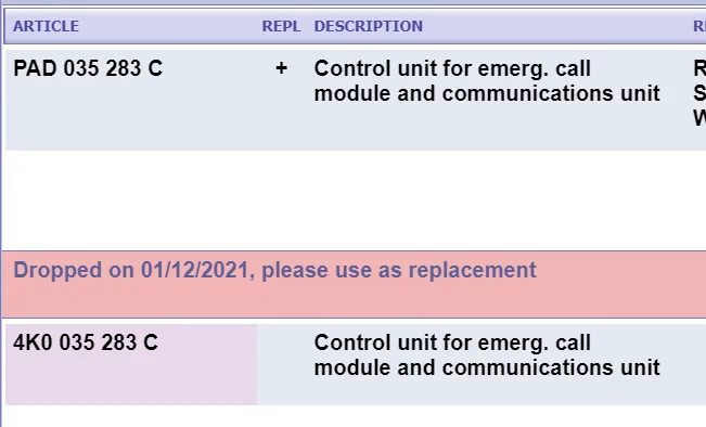

and now it get's really weird or proves the Audi/VW Mix:
(4K0 part number)
Porsche Taycan Communications Issues [PCM/App/Porsche Tracking] 1648461719423
Porsche Taycan Communications Issues [PCM/App/Porsche Tracking] 1648461263572
Porsche Taycan Communications Issues [PCM/App/Porsche Tracking] 1648461835287
Porsche Taycan Communications Issues [PCM/App/Porsche Tracking] 1648461024334
Porsche Taycan Communications Issues [PCM/App/Porsche Tracking] 1648461238250
Porsche Taycan Communications Issues [PCM/App/Porsche Tracking] 1648461748418
