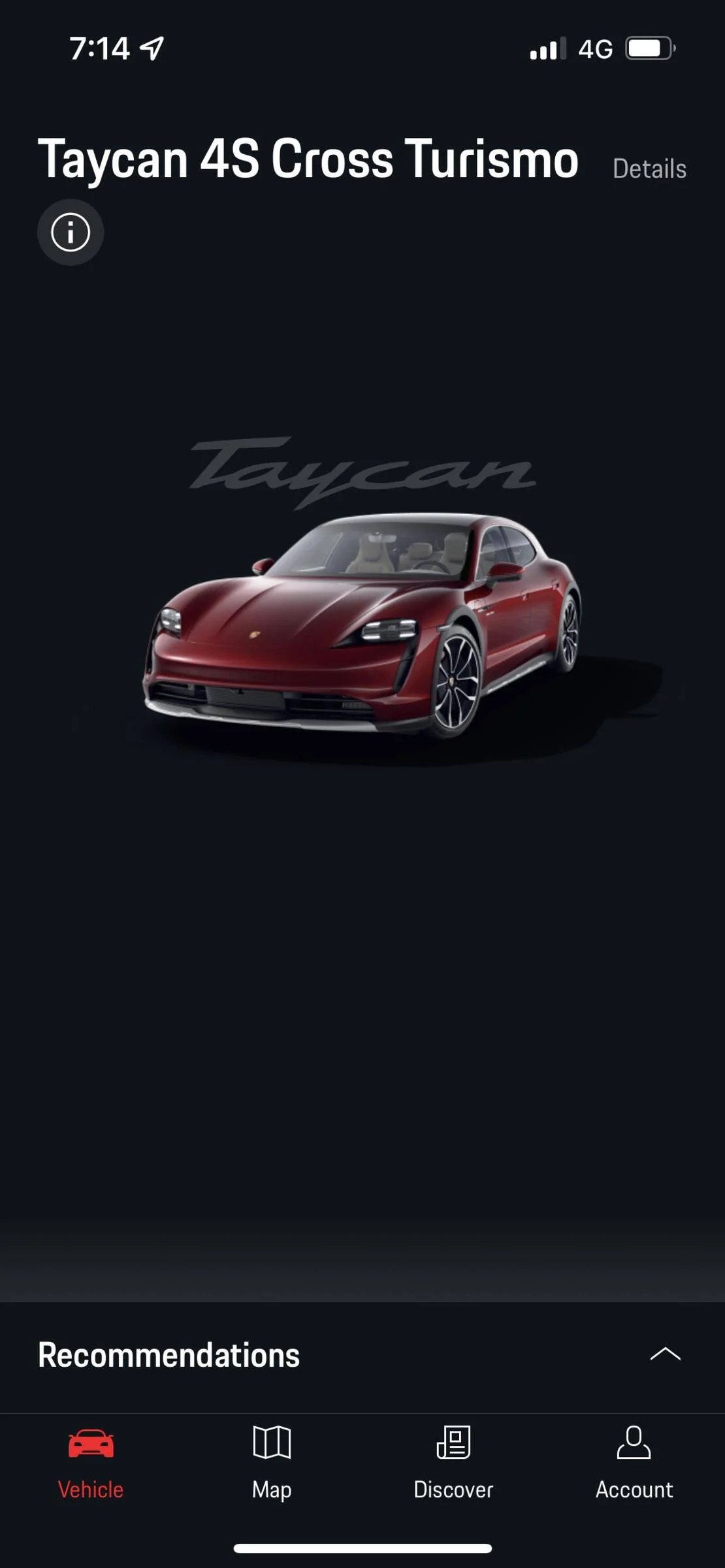

My “My Porsche” iOS app stopped working in the last week … it no longer displays car status, battery level, location etc:
Porsche Taycan Communications Issues [PCM/App/Porsche Tracking] BEBED8FE-806B-499F-81EF-70D39CFA2490
However, the web app (my.porsche.com) accessed on the same device still works. So the car is communicating its status with some server but the app is not talking to the server.
I’ve tried logging out, reinstalling etc to no avail.
Anyone experience similar and have a solution?
I am having the same issues, and have contacted dealer waiting for response.
So far I've read to go on your car's PCM, log off, and log in again with your Porsche ID (User-->Guest-->User). This helped solved it for some peeps around here, but didn't work for me.
chylld
Jonathan
Oct 30, 2021
126
107
Sydney, Australia
CT4S
i can see how this would work… when I clicked … next to my account, the last sync time was 4 days ago, around when the app stopped working.
Changing to guest then back to my account updated the sync time, but the app is still not working.
Deleted my account from pcm and added it back, also didn’t work… plus I had to enter my security code which I almost forgot haha.
will give it some time and see if it rights itself

Still unresolved for me. On iOS the app updated to version 3.0.1 ("Small bugfixes and improvements") which appears to be the update that broke it.
Tried to submit a bug report via the app store, but my enquiry ended up at my local dealer; not sure what they can be expected to do in this situation!
chylld
Jonathan
Oct 30, 2021
126
107
Sydney, Australia
CT4S
App is working again! Looks like it was an issue with whatever server the mobile app connects to.
