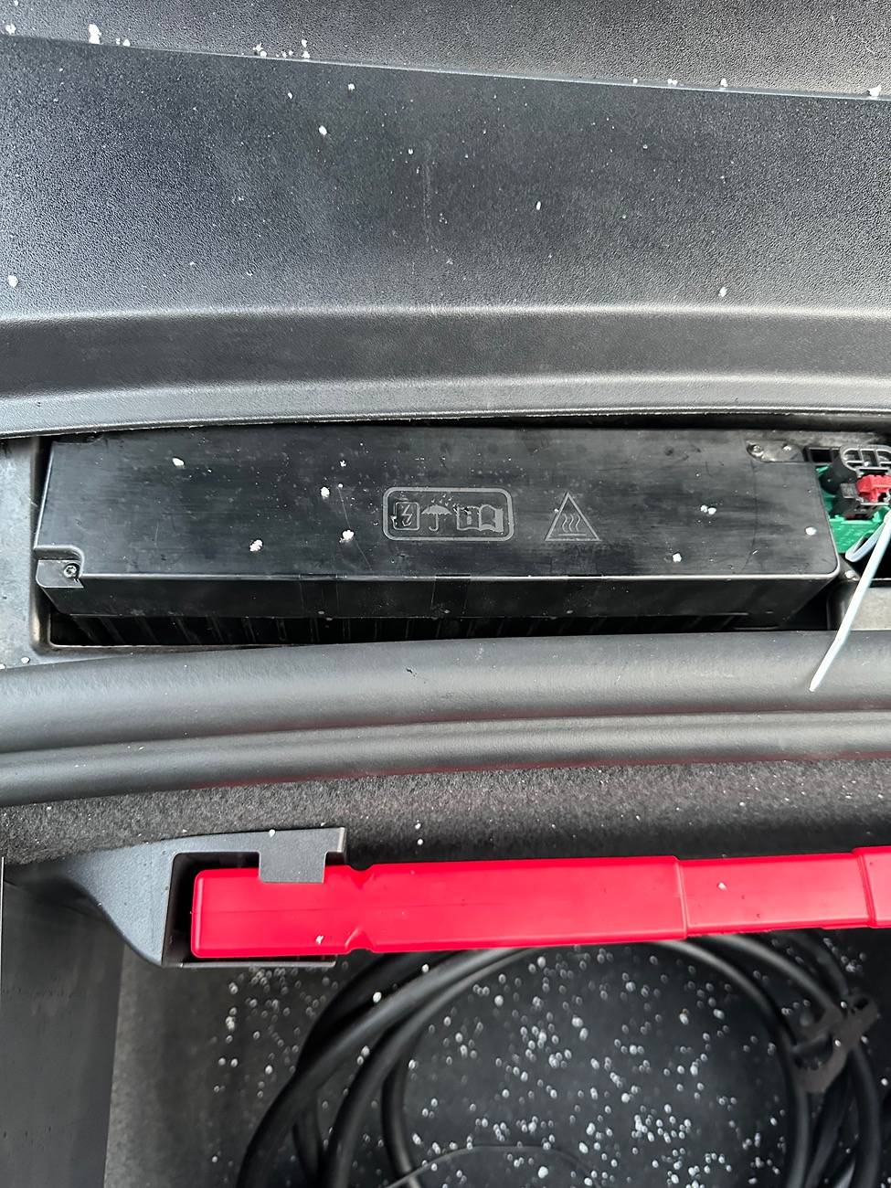

I just checked the fuse box in the front of the car next to the safety switch and all the fuses are good, nothing blown!!!?
Now next step ,I'm going to start dismantling the right part of the trunk at the back to access the fuse box located there, but first I still have to find out where it is.
Porsche Taycan Piwi diagnostic program for Porche Taykan IMG_8313

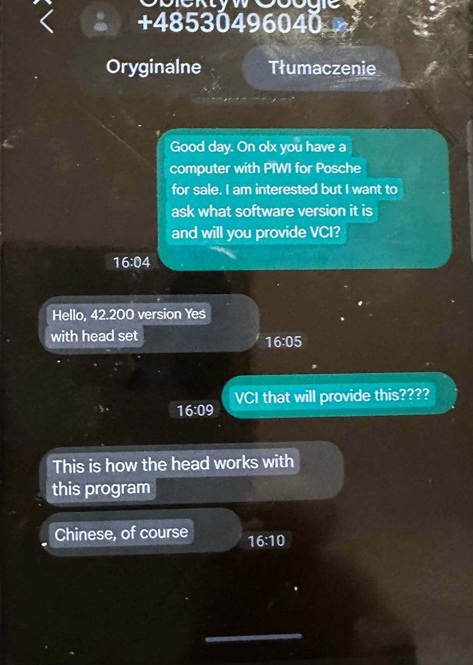

ok, here I have the information regarding the white leptop regarding the black leptop you said you would send it to me!!!
Porsche Taycan Piwi diagnostic program for Porche Taykan IMG_8314
Porsche Taycan Piwi diagnostic program for Porche Taykan IMG_8301

Need to confirm this software has the engineering mode and ask whether he can supply the latest software, but this may be a decent option if the price is good for you.
The VCI shown in the image is the Chinese cut down version that I showed you a picture of a couple of posts ago.
Just so you are aware a genuine VCI without the software or laptop is easily going to cost the same or more than you are paying for the bundle.
Also you need to be aware that the only advantage of buying this way is that you are bypassing the software installation and also depending on whether you have an old Windows laptop you could use.

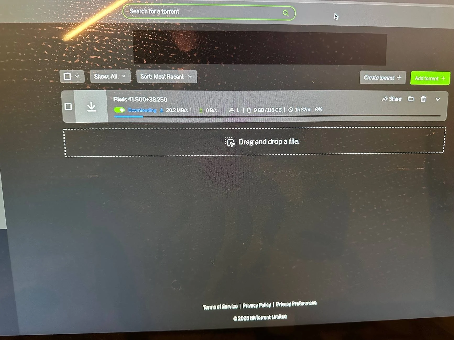

I'm going to read what you sent me, it's quite interesting! Look, do you remember the torrents file you sent me earlier...??? I'm currently downloading the file with torrents, I have a laptop available at home and I think it can be installed with ease. If this download has everything...this looks to me like version 41.5 + 38.25 if the file comes out and I can install it later then I need to buy a compatible VCI...let's see I think the download will be done today.....the total file is 118 gb
Porsche Taycan Piwi diagnostic program for Porche Taykan IMG_8315

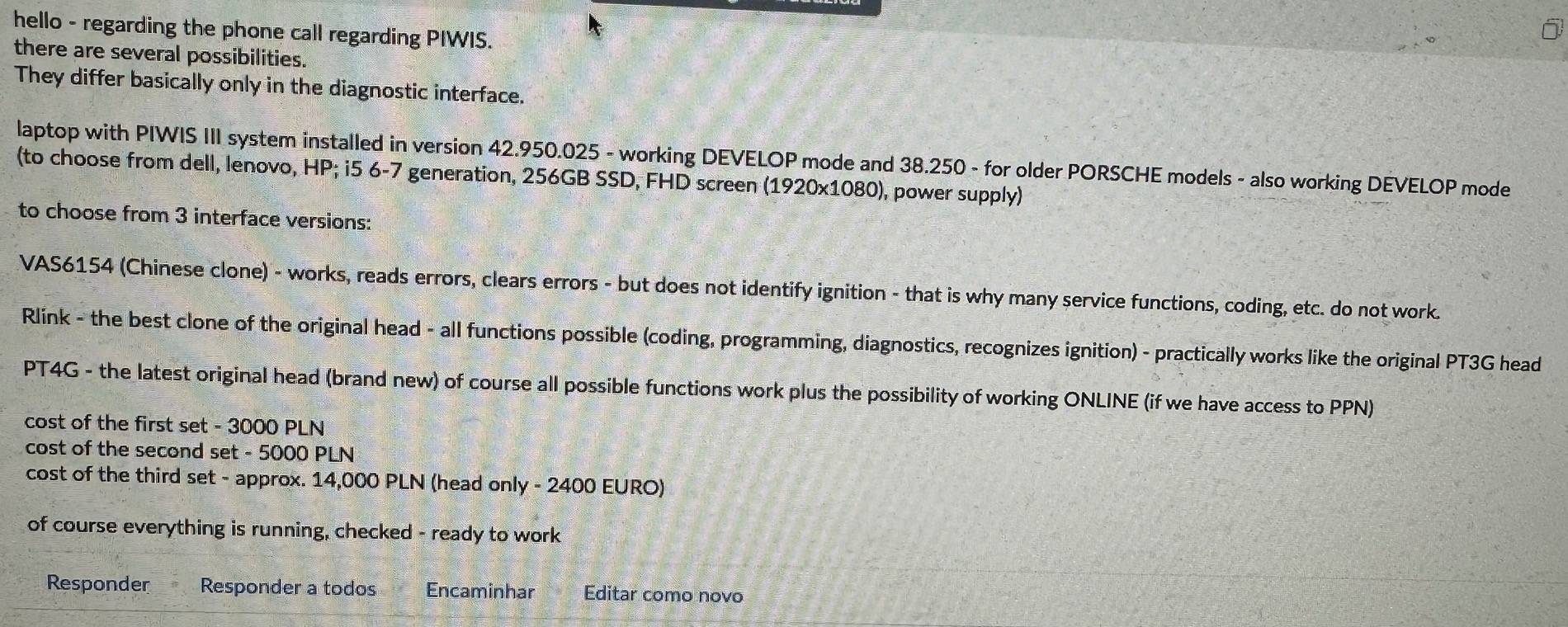

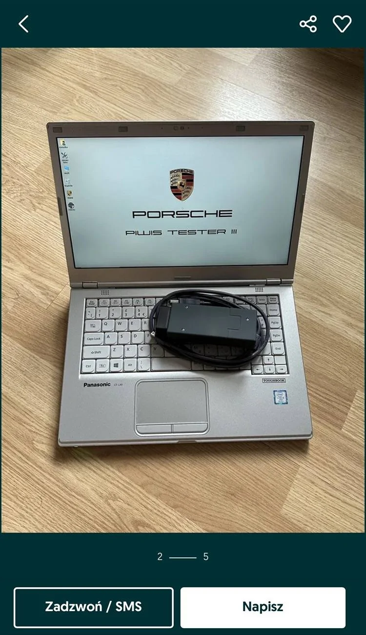

Well, in the meantime I ended up receiving a response from another individual regarding the black computer piwi and apparently it's not just this piwi that's for sale……?
Porsche Taycan Piwi diagnostic program for Porche Taykan IMG_8316
Porsche Taycan Piwi diagnostic program for Porche Taykan IMG_8294

Once you have the torrent downloaded, you can follow the instructions in the PIWIS for $75 I posted 20 minutes ago.
All you need is the clone VCI once you have the software installed and working.

This looks good.
Latest software, I am not sure why the chinese clone does not recognise ignition on, but may be the latest version VCI 1.6 that has a problem, the 1.5 does recognise ignition on and has all the functions except component protection.
Not sure what Rlink is, but might be the VCI that bigcraig was offering you, they are definitely faster, but it is functionality that you need more than speed.
