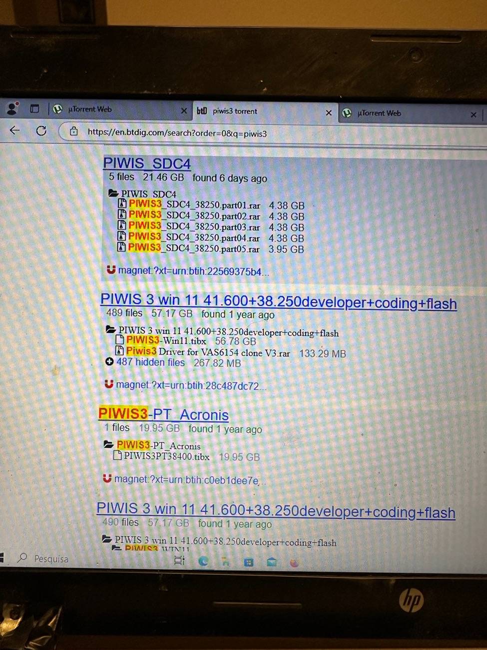

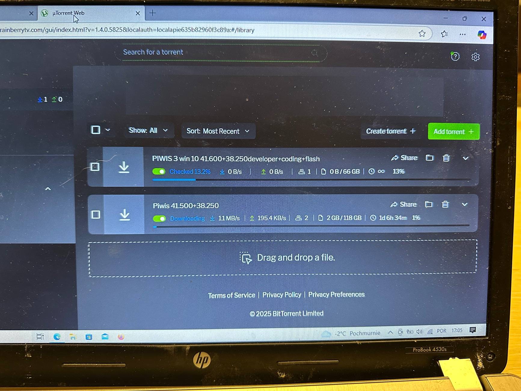

Good afternoon everyone, here on the forum, for those who are interested I found a website where you can download several versions of piwi 3 on torrent! For those who want to try it, I already have downloads in progress, let's see if it works!!!It seems interesting and necessary to me because someone like me may also need it?

After the download everything , I just don't know how I'm going to install all of this, I imagine you have to have a virtualbox VM, etc., etc., but honestly I don't even know where to start, so if anyone could give me some tips I would be extremely grateful!Laptop lenovo i5 ideapad nvidia geforce 8 g ram, I think that's enough...!!!

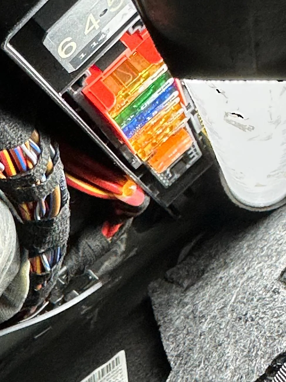

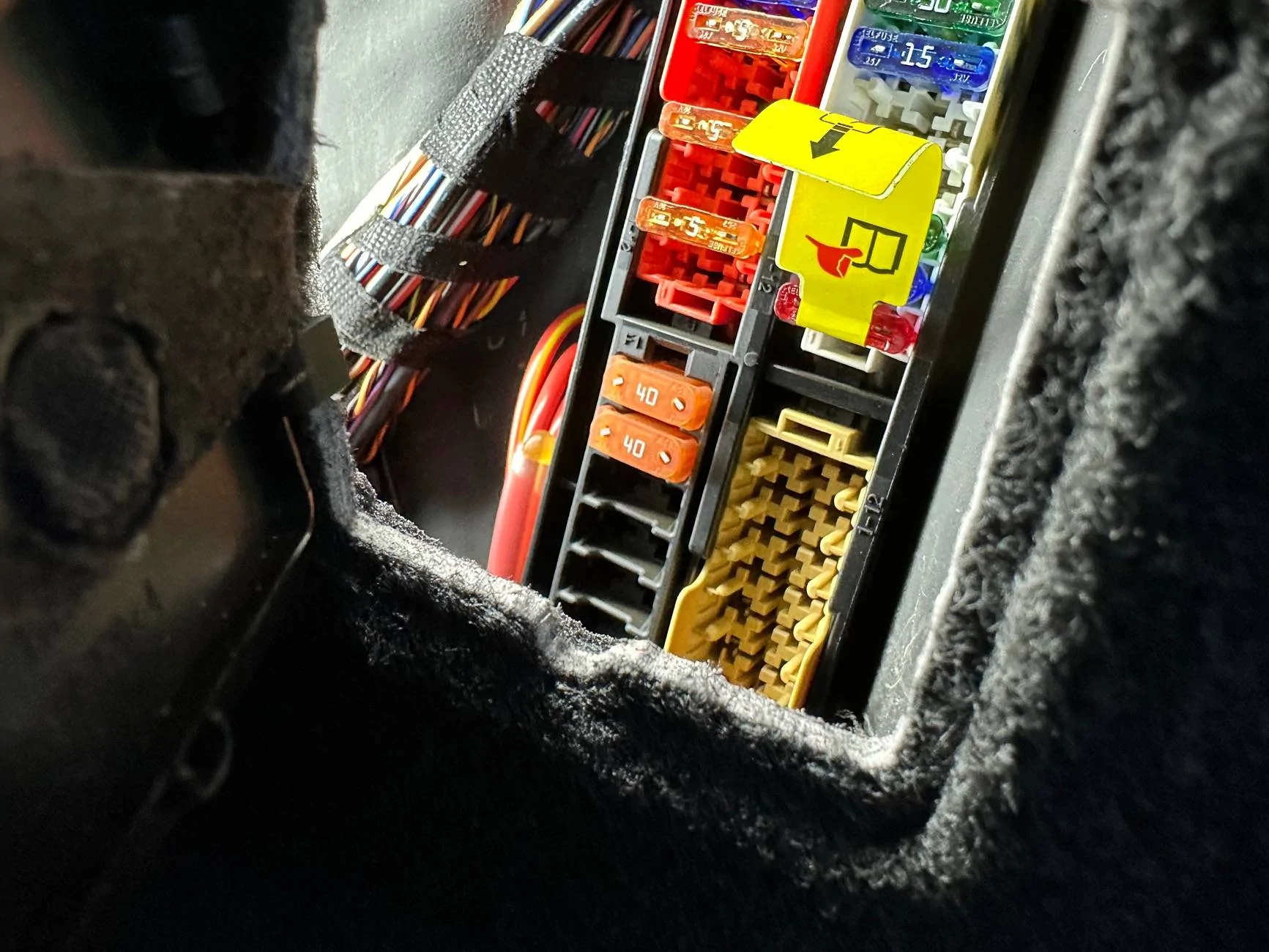

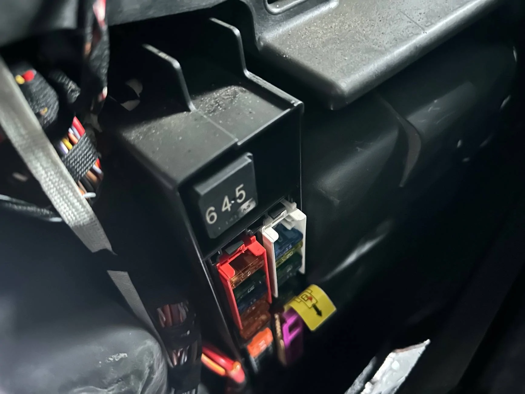

Shug ,I leave here the photos of the location of the fuses on the back right! I just checked the fuses and nothing was blown, all the fuses beeped on the voltmeter continuously, that is, all the fuses are in good condition, I didn't find a blown fuse in the car, places checked (driver's place on the feet, on the driver's place on the dashboard, passenger seat on the feet, passenger seat on the dashboard, black fuse box on the hood of the car, right rear trunk)!If there is another fuse box other than these places, please let us know…!
