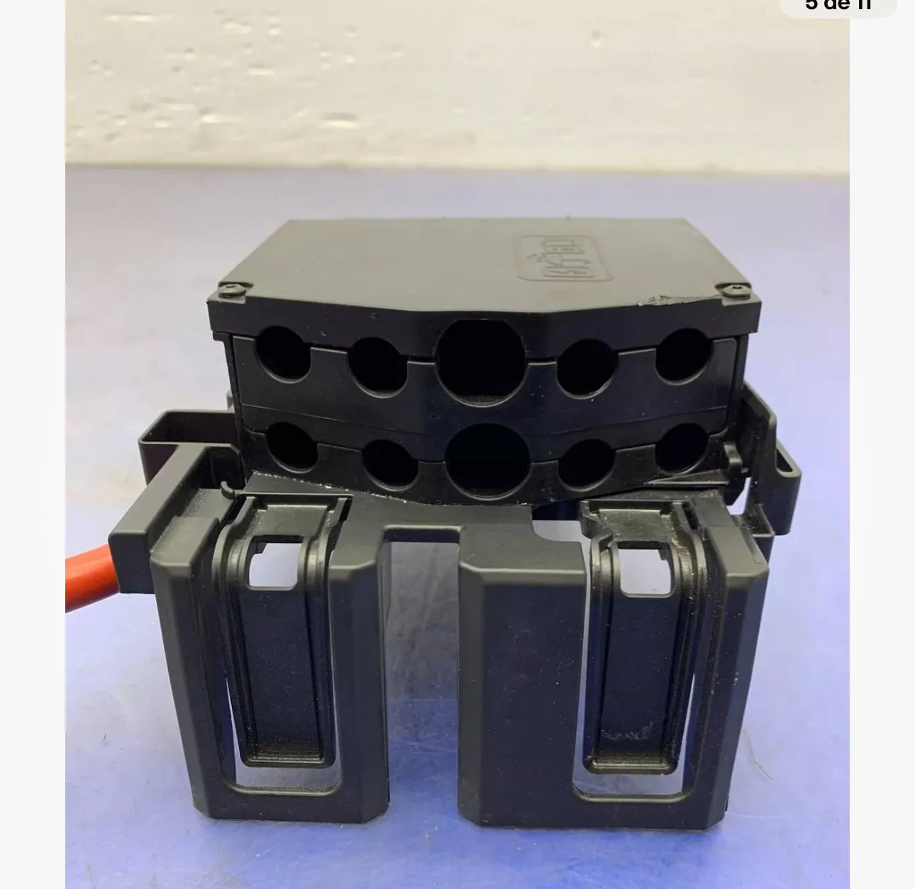

What about the fuses on top of the battery?
You can now plan to successfully troubleshoot when your VCI arrives.

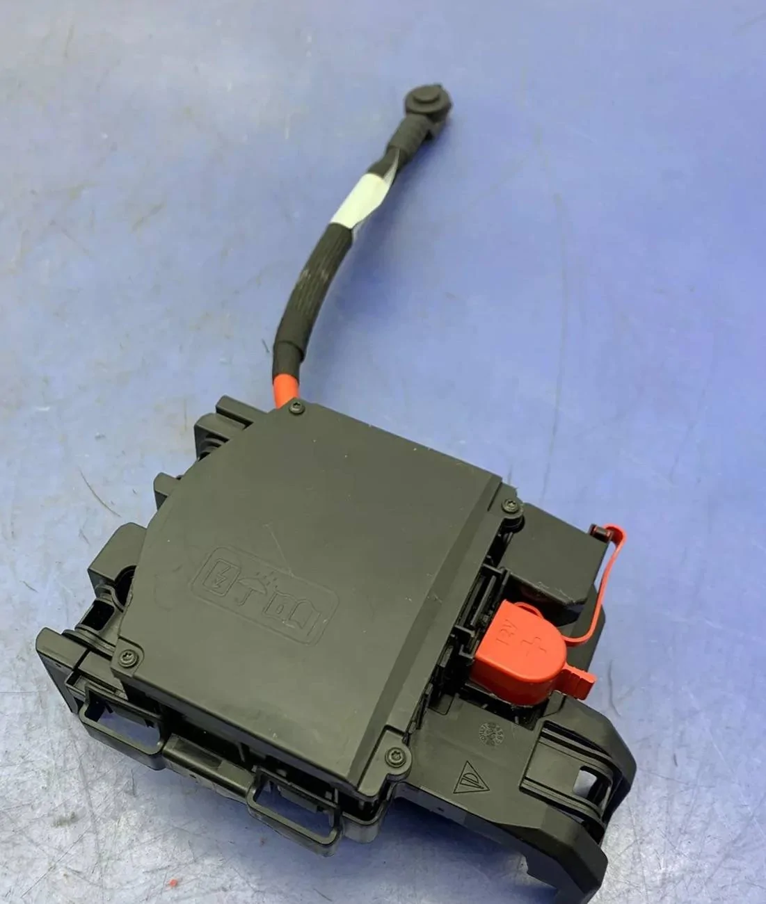

Well done Carlos,
Shug? Are this fuses on top of the 12v battery…..where….????Give me the location please so I'll check tomorrow in the morning...??
Another think I managed to find out the 12v battery was new and been replaced in September 2024 ,do you think there's a chance this 12v battery that was changed in September would also have problems...? ?

It's unlikely the 12V battery has any problems, PIWIS will get you the answers there.
The lid of the battery has several wires going into it. If you look closely, you will see that the lid separates and you will see there is a fuse connected to each wire.
Thanks??o yes, I was looking at the battery cover and I assume that you have to remove these 4 screws, but first the windshield wiper cover also has to come out because the windshield wiper cover is right above the 12 v battery. which makes it difficult to access it at the top….(I leave here some photos of the 12 v battery cover just for confirmation)
Porsche Taycan Piwi diagnostic program for Porche Taykan IMG_8339
Porsche Taycan Piwi diagnostic program for Porche Taykan IMG_8338
This top is just above the positive terminal of the battery where there are 4 screws that are removed from the outside and inside there are fuses...!!!

That is the battery top that you need to pull apart Carlos.
ok, I'll dismantle this part of the battery tomorrow morning and check the fuses inside ?I'll let you know later if I found any burned, thank you shug

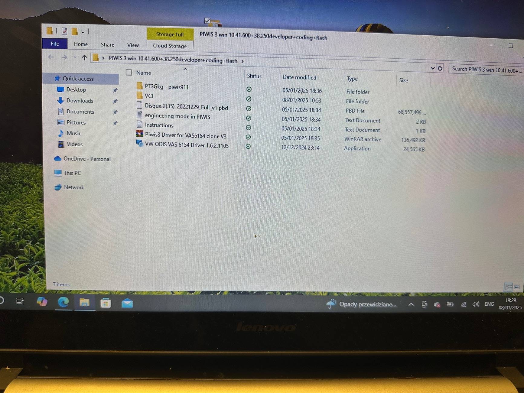

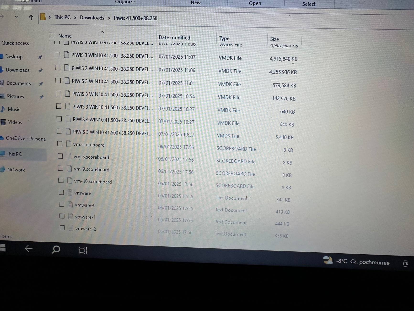

Shug - I haven't been able to check the fuses on the positive side of the 12V battery yet because it's been snowing here, but as soon as I have a day with a positive temperature I'll remove the windshield wiper blades and the plastic to access the fuse cover of the 12V battery (it's held in place by 4 screws)! Another thing, I already have the download of piwi 3 Windows 10 41,500+38,250 developer+coding(VMWARE) 118GB I'll leave photos attached of the files.

In addition to this I have another piwis 3win 10 41,600+ 38,250 developer + coding + flash file that appears like this… file have in total 65.6 gb
Porsche Taycan Piwi diagnostic program for Porche Taykan IMG_8386

Carlos,
Windows 10 41,500+38,250 developer+coding (VMWARE) will be fine for you to get going with.
I can see there are instructions with your download and also a driver for your VCI.
If you get stuck with the install, send me a link to what you have and I can try to troubleshoot for you.

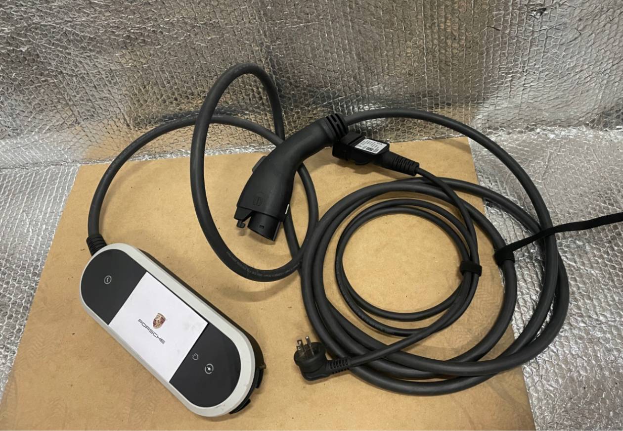

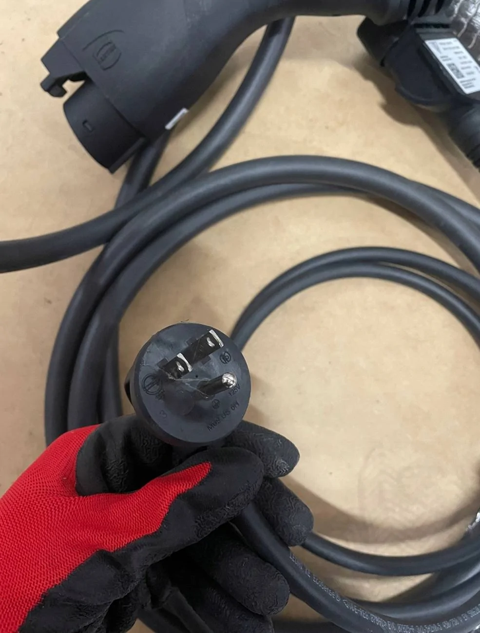

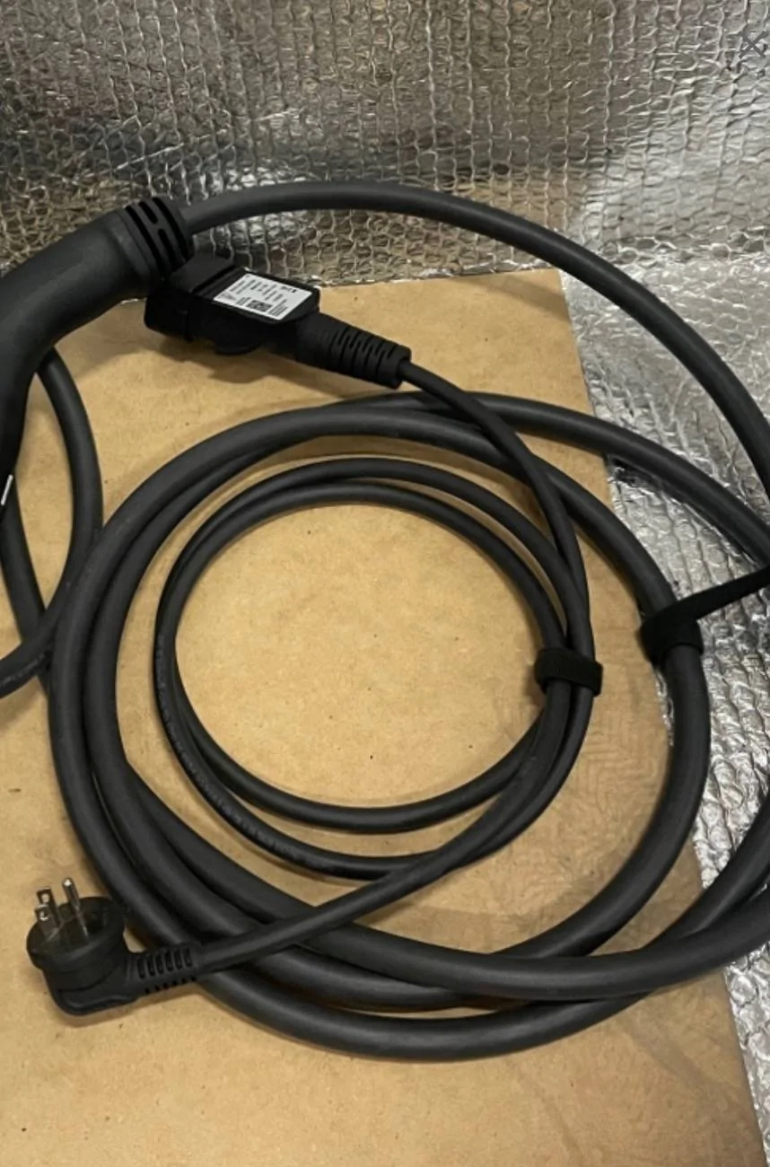

A small aside about the problem with my car, but can anyone tell me if the charger for the Porsche Taykan from the United States works for the Taykan in Europe? Obviously, if you remove the electricity connection terminal, which is different, you will have to use a USA to Europe converter (which I have).
I assume that by removing the terminal the rest is all the same…..!!!??
I leave photos below charger home USA
Thanks
Porsche Taycan Piwi diagnostic program for Porche Taykan IMG_8385
Porsche Taycan Piwi diagnostic program for Porche Taykan IMG_8362
Porsche Taycan Piwi diagnostic program for Porche Taykan IMG_8377
Porsche Taycan Piwi diagnostic program for Porche Taykan IMG_8356

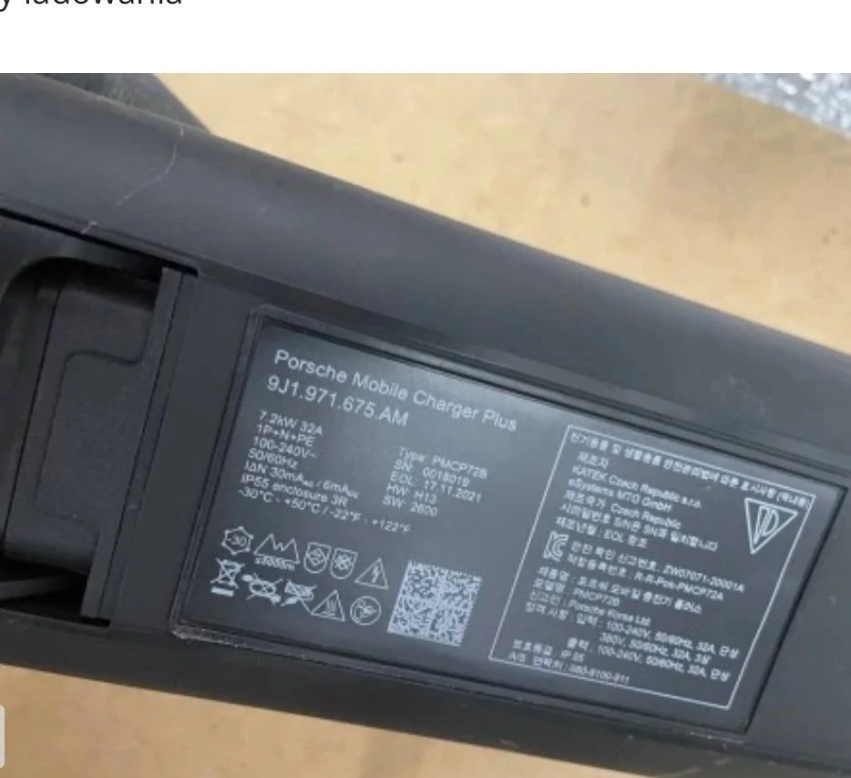

My UK charger is happy with all voltages.
Check the back of the charger you are looking at for details.
Porsche Taycan Piwi diagnostic program for Porche Taykan charger

so this means that the charger does not fit into any of the car's charging ports, neither the right nor the left, but only the electrical plug terminal, but also the charging ports….! And the adapter for the port must be a not an easy thing to fix ?
