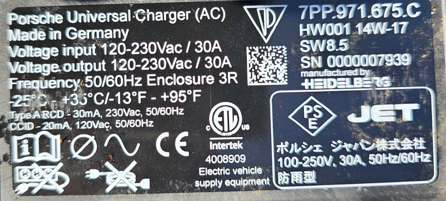

My UK charger is happy with all voltages.
Check the back of the charger you are looking at for details.

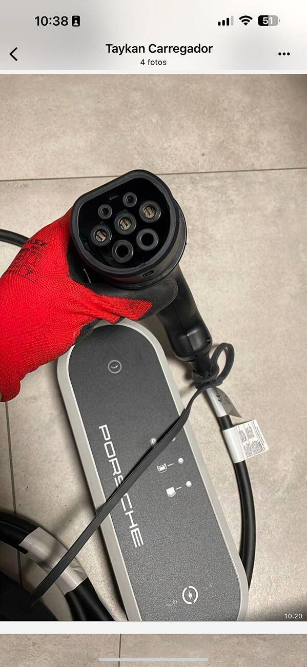

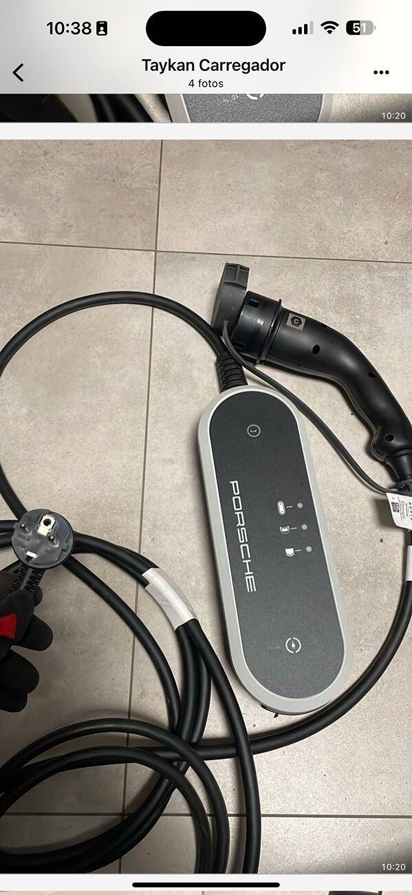

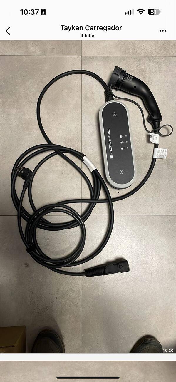

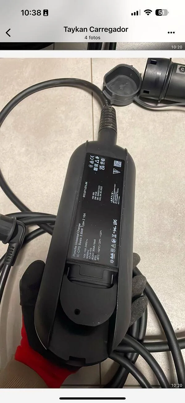

Hi Shug I ended up changing the charger for this one, which I send photos of, European and universal, I think this one works….????and relatively new
Porsche Taycan Piwi diagnostic program for Porche Taykan IMG_8394
Porsche Taycan Piwi diagnostic program for Porche Taykan IMG_8397
Porsche Taycan Piwi diagnostic program for Porche Taykan IMG_8396
Porsche Taycan Piwi diagnostic program for Porche Taykan IMG_8395
89
8,425
7,422
so this means that the charger does not fit into any of the car's charging ports, neither the right nor the left, but only the electrical plug terminal, but also the charging ports….! And the adapter for the port must be a not an easy thing to fix ?
There are adapters, like this one (it was the first one that popped up on my quick search):
Porsche Taycan Piwi diagnostic program for Porche Taykan 1736415587357-s5
But why would you buy a North American EVSE for your EU car in the first place?

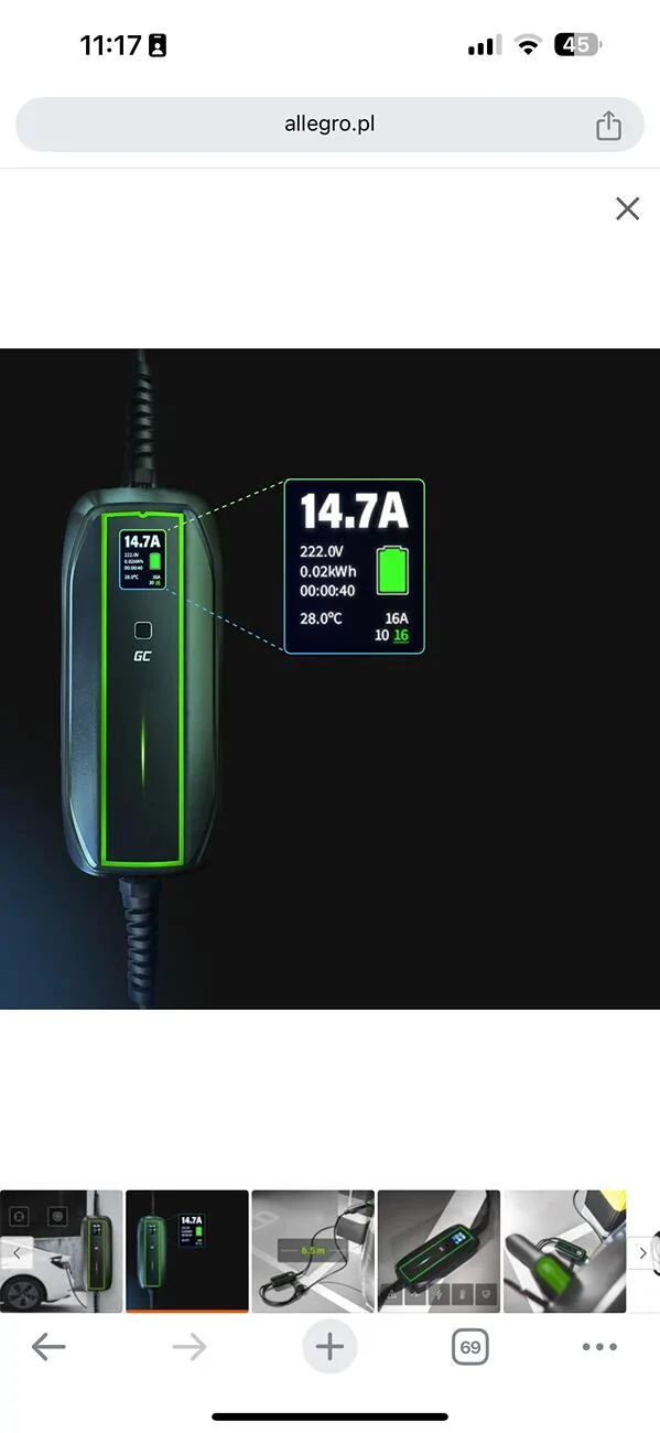

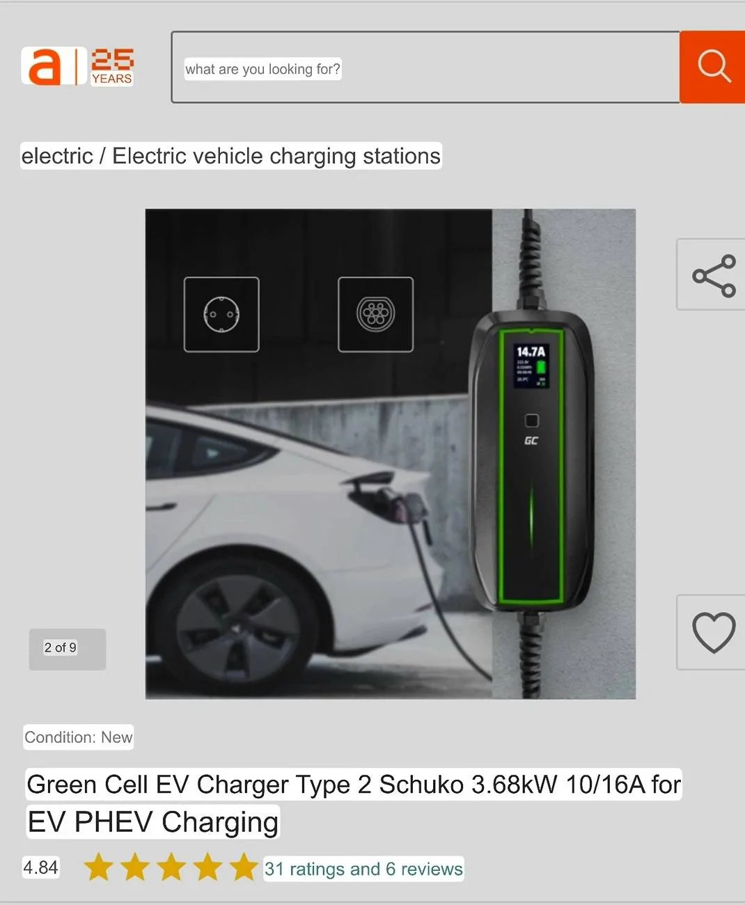

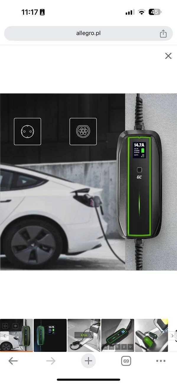

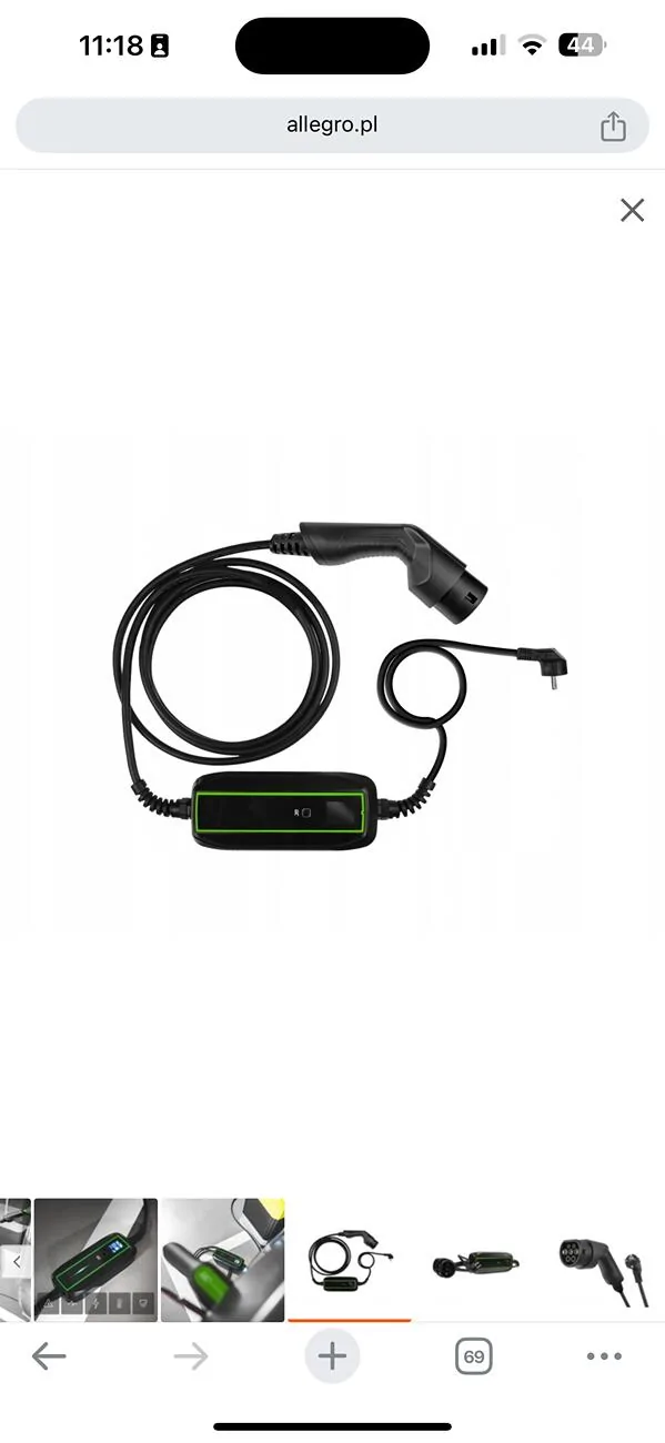

Can I still cancel the charger order... there is still time!!! In your opinion, for example, will this be enough to charge my car...?
Yes, it will do the same job (both this one and the Porsche one are rated at 16A, so same max speed of charging). It might even be better, as it has a screen showing some data. It's probably less expensive too (Porsche charges a large premium for their products).
ok?I will cancel the order for the Porsche charger and I will order this charger, not to mention the price between the 16 A universal charger and this one, the price difference is huge …!!!
