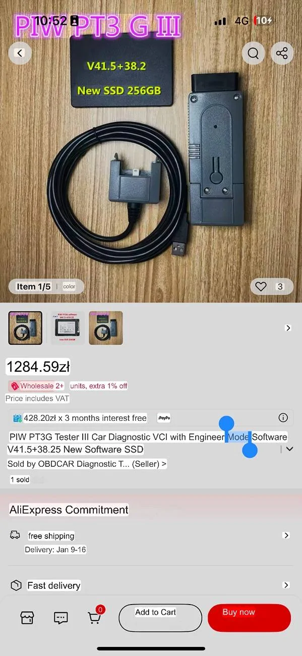

but what is your opinion, do you think that what this seller presents works on AliExpress ????….it was the link you sent me at the beginning, as for the genuine piwis subscription I can deal with that later, what I need now is to have the hardware and software to read the car, because I even suspect that the problem is really in the 12 V battery, but to know that I will have to start somewhere and without a program, whether it is with access or without and without hardware….nothing done

This would certainly allow you to get going and investigate what the problems are.
The cloned software can also be used to correct errors, so would be a decent start if it works OK.
I have no connection with the seller, so cannot confirm, but my guess is you would be safe since you can return on Aliexpress.

My guess is that Bigkraig will be able to support you if you bought from him.
MARS is also a go too but be aware that none of these guys offer a manual on how to use the software, so this is not a plug and play option, it will require some effort on your part to work out what is required to access faults with the software and then what you might do about fixing the fault.

Would it be possible to send me a link to someone where I could buy the hardware and software together, who has knowledge that it works properly, it could also be this Bigkraig system, as I am not very familiar with the Porsche scanning system and everything for me now is as if it were the first time
You can get a cracked Chinese PIWIS3 which works without a live Porsche subscription. It will probably run you ~$1,500 with the laptop and DoIP enabled adapter that is needed for it (DoIP needed for full capabilities for Taycan work). You can also register with Porsche as an official third party shop and get the subscription for a few days, weeks, or months. HOWEVER, given your comments so far, while it will give you the same capabilities the dealer has, I doubt it will give you what YOU want. All you'll get, after you figure out how to use it, is the same list of errors you already have. The next step is actively diagnose the problem, i.e. start taking things apart, look for obvious issues, rerun diagnostics, etc - typically a time consuming process, and you need to understand what connects to what, and what can cause individual errors (e.g. maybe the rain sensor fails to respond because its power or CAN/LIN bus is not connected - you then disconnect the power and/or CAN/LIN bus and see if the error has disappeared, if not, then you know it's the problem with one or both of the connections, and you continue digging).

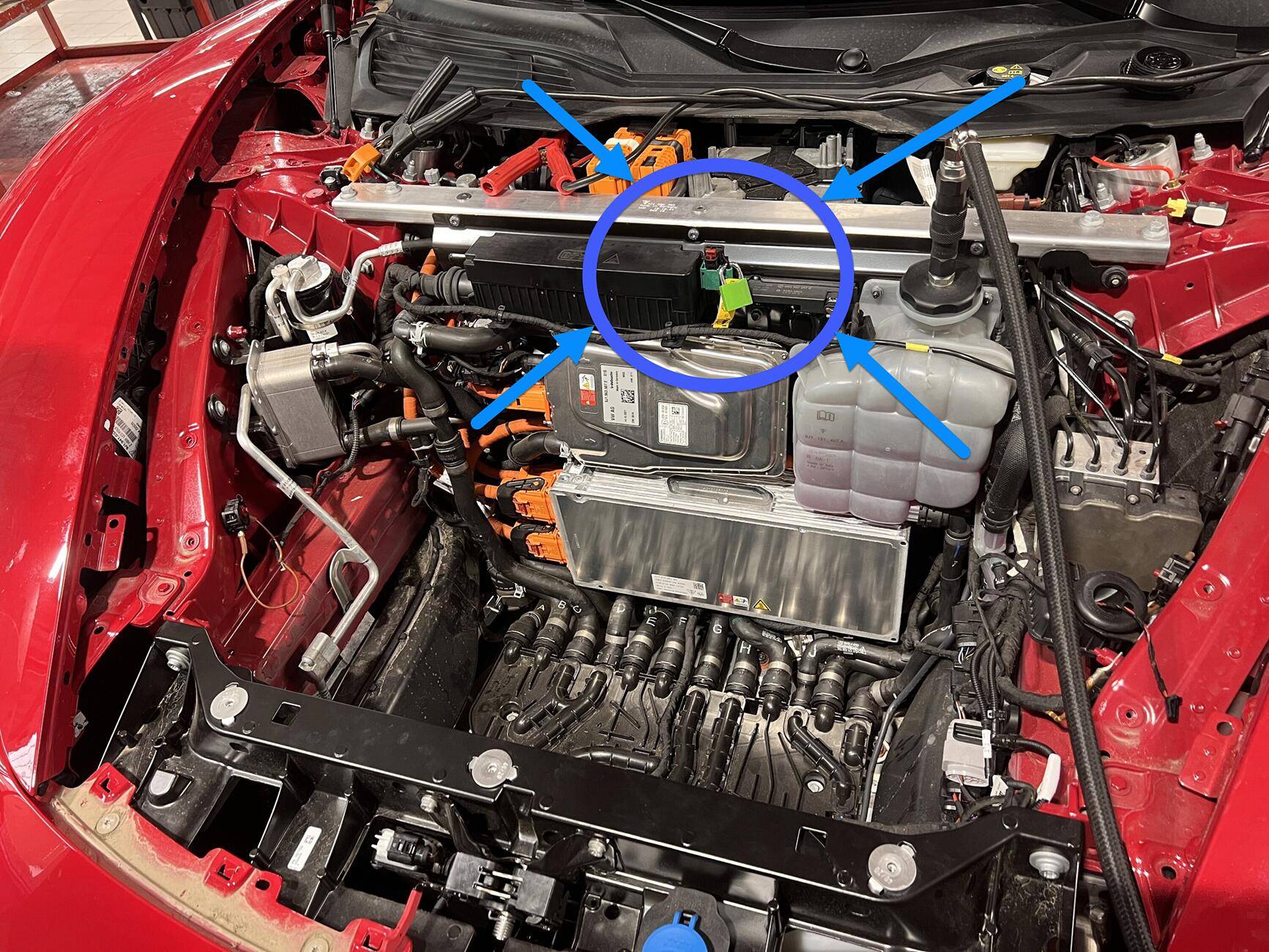

Another thing can you explain to me more or less where it is located in the trunk (safety disconnect in the trunk) to disconnect the 800V battery?
Double check with your specific model year user manual, but below is a picture of said switch which I found on the internet (I think it's the interlock with the green padlock). Full disclosure, I never touched any of my high voltage components in my car, so I know this from theory only, therefore personally cannot guarantee the 800V will be off everywhere, especially if someone messed with your car in the past (they could have bypassed this switch for example, people do stupid things sometimes when trying to get cars to run).

I really appreciate all the information, yes sometimes people do pretty stupid things, anyway! So this switch turns off the 800v load, I assume that to reconnect the battery load and just turn the switch back on, I also don't want to mess with absolutely anything that has to do with the high voltage of the battery, in fact if in the case it is the DC/DC that is broken I will have to find someone to do the change for me! I just want to check the interior of the car in terms of the interior wiring, nothing else could there be any tangled wires inside or something like that and that's it and obviously I want to check for safety I don't like to take unnecessary risks!

Last piece of advice, stay away from bright orange wires, they are always high voltage (you can see some of them on the picture with the safety interlock, connected to the heater and the onboard charger).
