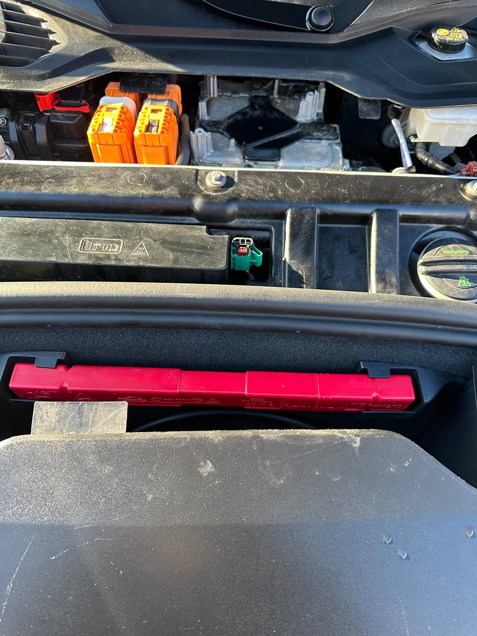

Double check with your specific model year user manual, but below is a picture of said switch which I found on the internet (I think it's the interlock with the green padlock). Full disclosure, I never touched any of my high voltage components in my car, so I know this from theory only, therefore personally cannot guarantee the 800V will be off everywhere, especially if someone messed with your car in the past (they could have bypassed this switch for example, people do stupid things sometimes when trying to get cars to run).

This raises some questions for me: so according to this added file, in order to have all the high voltage systems off, it is necessary not only to disconnect the high voltage system at the front on the hood but also the second option by removing the fuse at the back next to the rear seats, or is it enough just at the front on the hood….??? The next question: Let's imagine that for safety reasons we deactivate the primary emergency point on the front hood, after finishing the work we had to do, we activate the switch again and everything goes back to normal?????
You only need to remove the front switch to disable the high voltage electrics, the rear switch / fuse is very hard to access as I described.
There is also nothing you are working on that has high voltage, so no need to disconnect. There is a message on your dash telling you it is disconnected to confirm.
Disconnecting the electrics with doors open etc leads to issues with where the windows sit after you connect the power back on again.
front switch In my car!!!

Black box to the left of the 800V isolator is full of fuses.
