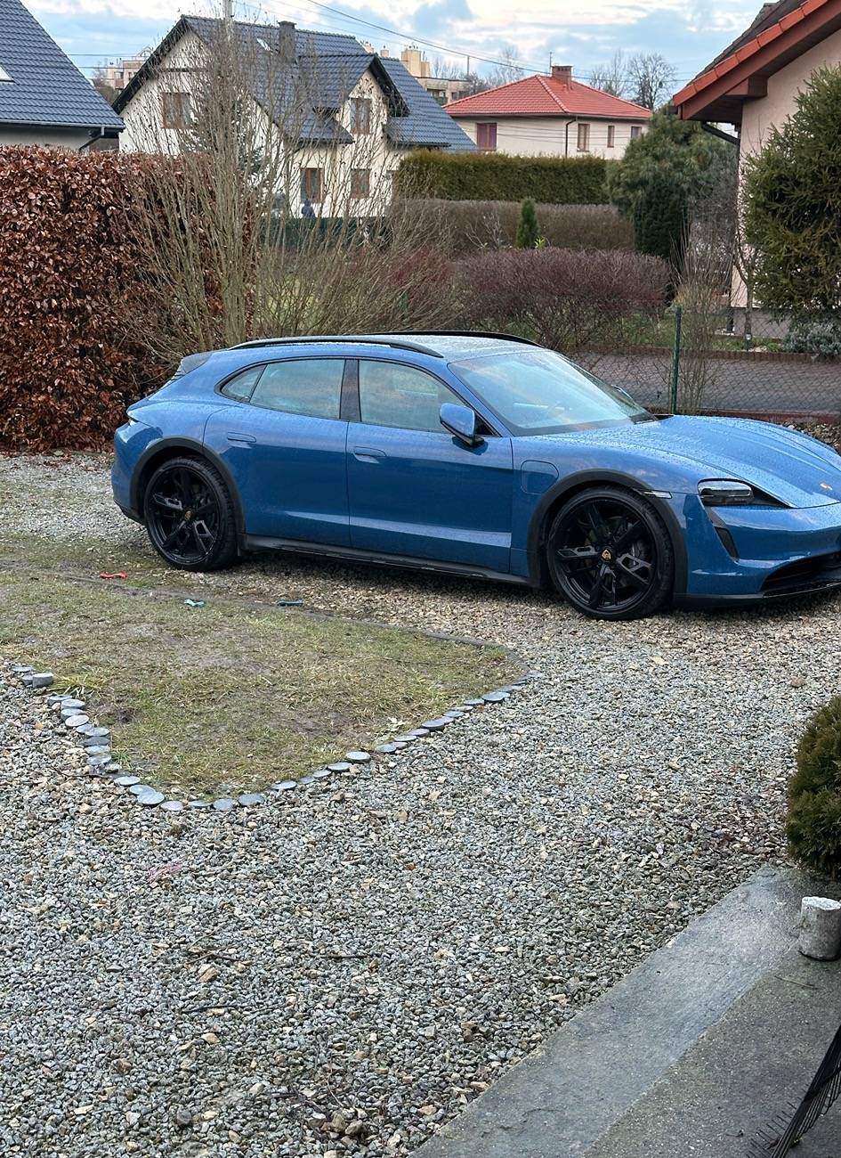

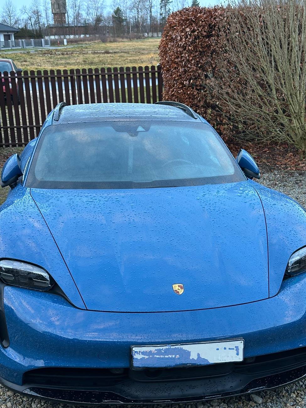

Scandinavian,Can you see in these attached photos any part of the car that has been involved in an accident? I honestly don't think so, but I think you are commenting with the purpose of destructive criticism and not constructive criticism, which is what a forum is for!
