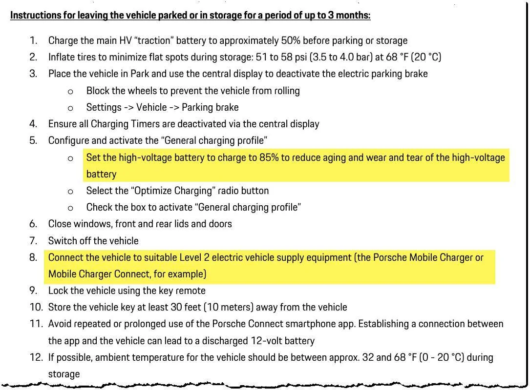

I found this Porsche publication about storage of a Taycan to be helpful.
So even for long term storage, Porsche recommends 85% SoC
Porsche Taycan PNW Washington taycan owners 1716936348380-am
Step 1 seems a little odd, why charge to 50%, then do all the prep (steps 2-7), then plug in in step 8 which will immediately charge to 85%.

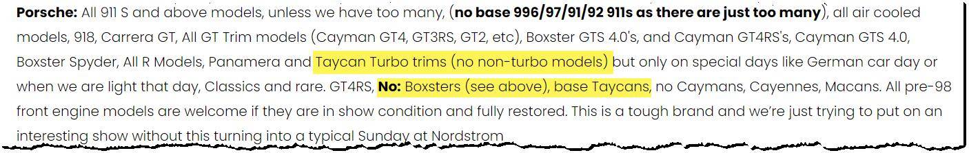

I don't "show" my cars, but I found interesting the criteria to be admitted as a show car at the Exotics At Redmond Town Center, with regards to Taycans.
Porsche Taycan PNW Washington taycan owners 1717140008423-b5
I honestly wonder if the show organizers or gate keepers could even tell a Taycan Turbo from a Taycan 4S or even the base Taycan without rear badges. Something tells me a good percentage of forum members here couldn't tell them apart without the badges (it is possible, but it's subtle, and you need to know your Taycan models, and they have to be stock/unmodified).
I get what they are trying to do by the way, only show cars which are rare in the area, and this being Redmond/Bellevue/Seattle area, $100K cars are not considered rare. It's just with the Taycan, majority of people really couldn't tell, unless they figure out a way to showcase performance (a Redmond Town Center Drag Strip?). My Taycan Turbo is a lot less "showy" than some base models, 4's, 4S or GTS'es that I've seen.
