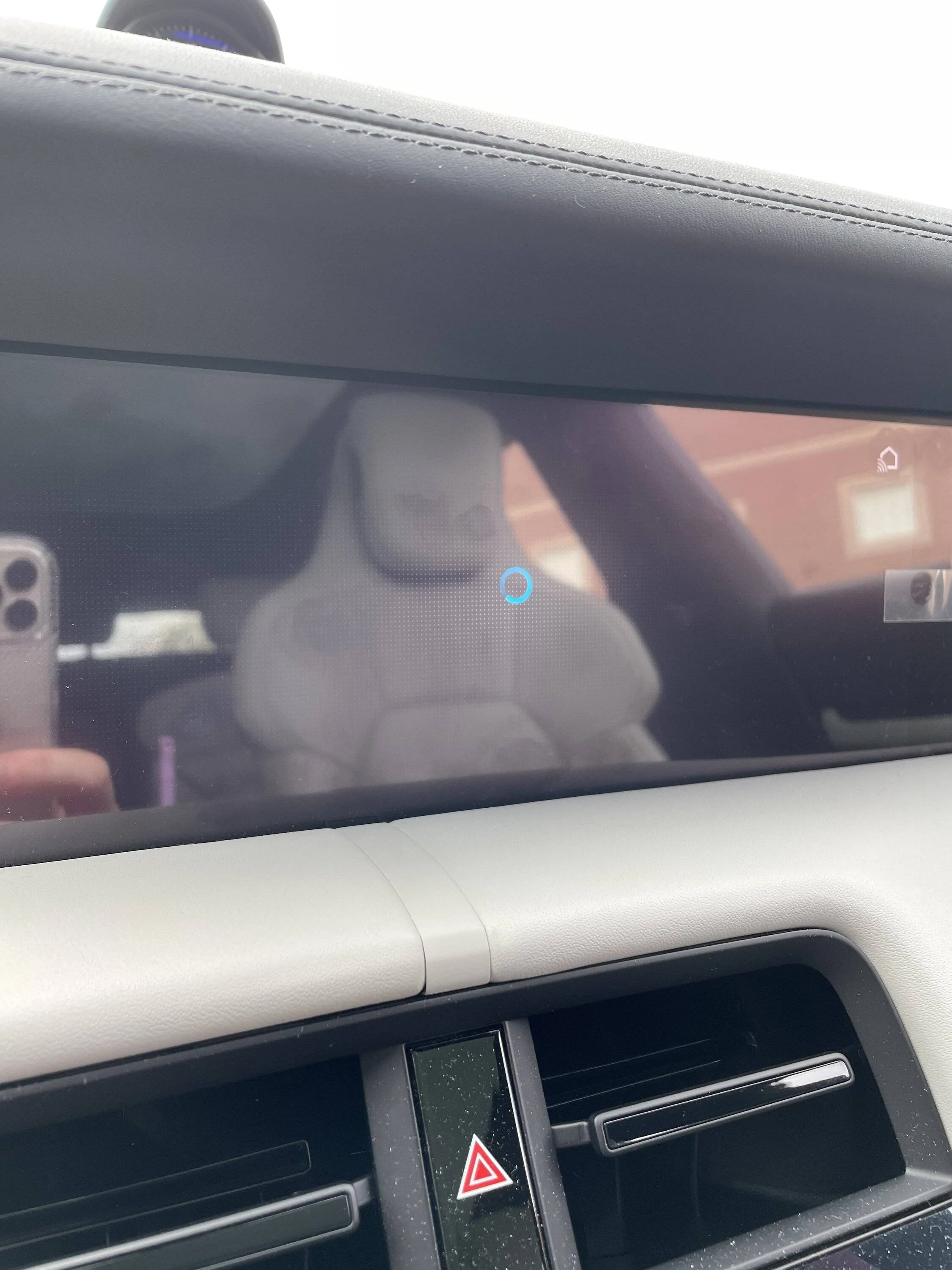

Yes I am the original owner of the car. All my screens go black with a blu circle going around , I guess trying to find a connection. My screen in front of the steering wheel works but both the center and passenger screen goes totally dark and cannot use any function in the car,(radio, garage opener, nav and any other app that shows up on the screens. They usually go back on next day or later after the car is shut off. But I would not go on a long trip when you have the possibility of the nav map goin blank and not being able to see where I can charge the car. The bottom line is that the computer keeps shutting off and has been happing since the car is new.

I am very appreciative of any comment that people care to share and would love to hear from other 2023 taycan cross tourismo 4s drivers. Thanks to all who want to express their thoughts. And just to be clear I have blank screens with a black or blue spinner!

I am having the screen issues. It has done it off and on, hadn’t for a month or two and now started up again. Sent pictures to my Service Advisor, will see what he says. (‘23 CT 4S)
