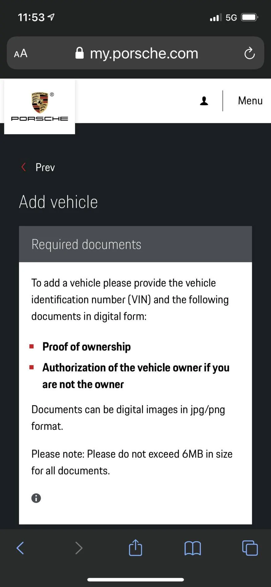

Requesting a Porsche ID is on thing but it needs to tie into the vehicle VIN I think.
You can add a vehicle by VIN in My Porsche, you just have to submit proof of ownership. They didn’t charge me anything when I did it this way for past vehicle.
