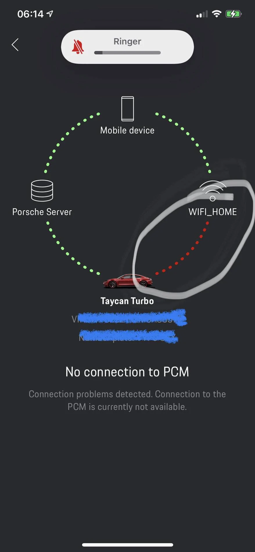

Can anyone help
Could they explain how I am to connect the last part up circled in the image.

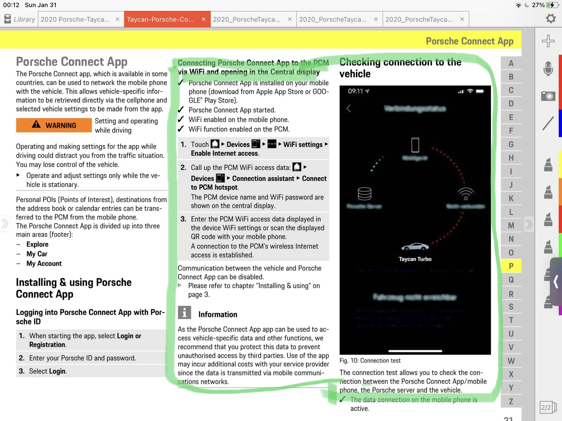

Maybe the attached page 21 from the Porsche Connect Good to Know Manual can give you a starting point to track the problem.
Continues on page 22 not attached.
Hope this helps.
