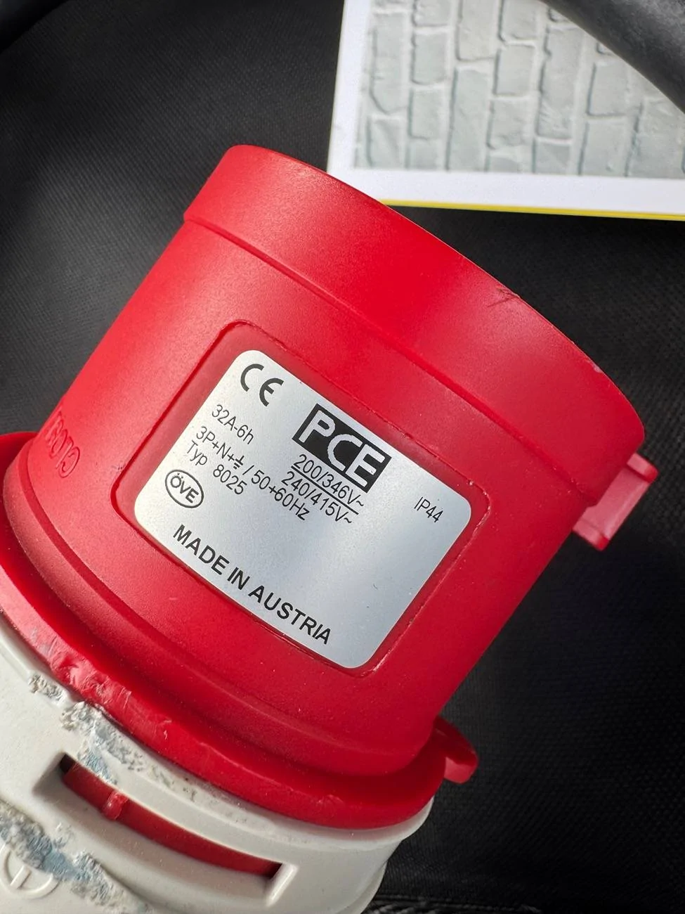

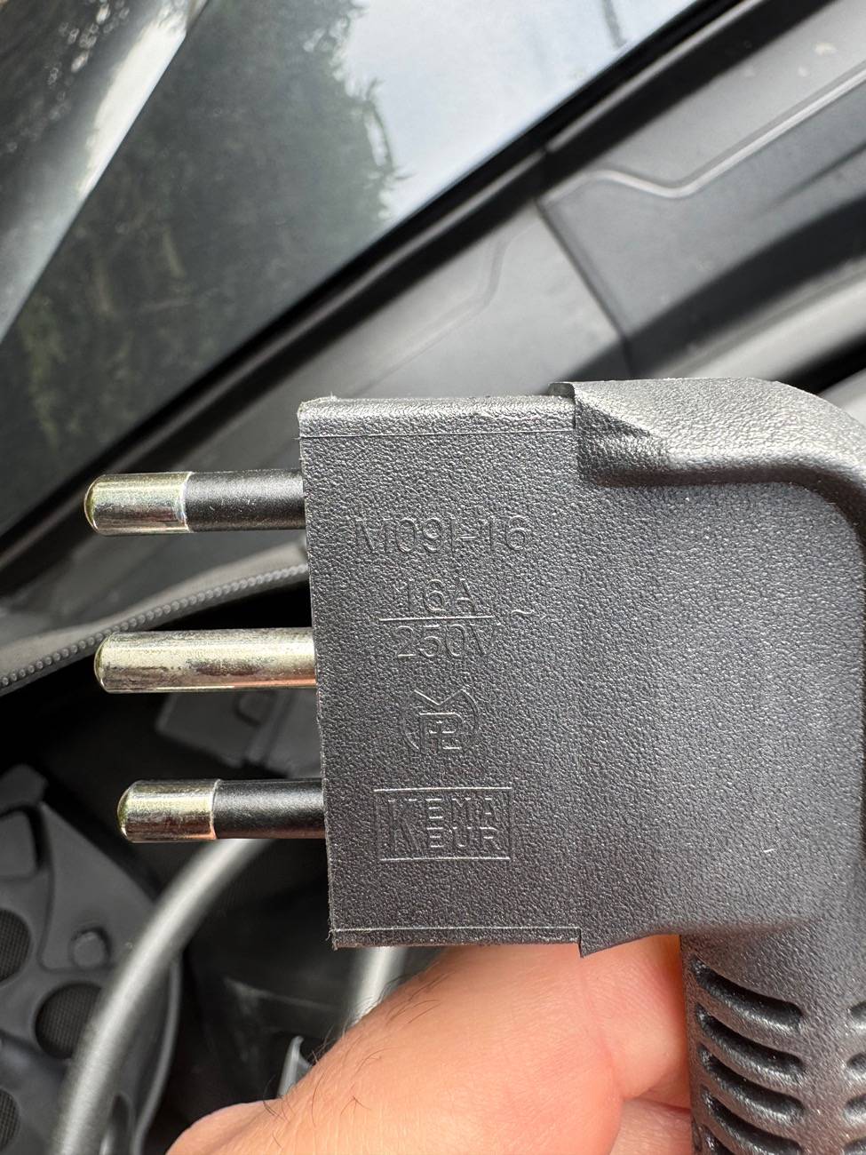

So I have a question: my PMCC (I guess all of them) comes with 2 possible plugs for a 220-240V net, one for a monophase system (which seems to be limited to 16A) and a triphase plug reporting 32A. So with the 16A plug I cannot reach more than 3,52kwh in charging even if my house provides up to 10kw? Am I correct? If that s the case I am afraid PMCC will not be an option since I will maintain a monophase net in my house… am I missing something?

I have my PMCC on a single phase supply with a dedicated 32A fused run from the main fuse board. This provides 7.4kW. Perfect.
To ensure you have 32A from supply to PMCC to car then all components must be 32A rated.
Looks like you have been given a 32A tail and should be fine providing you have a 32A fused supply.
I ll give it a try. Thanks man!
