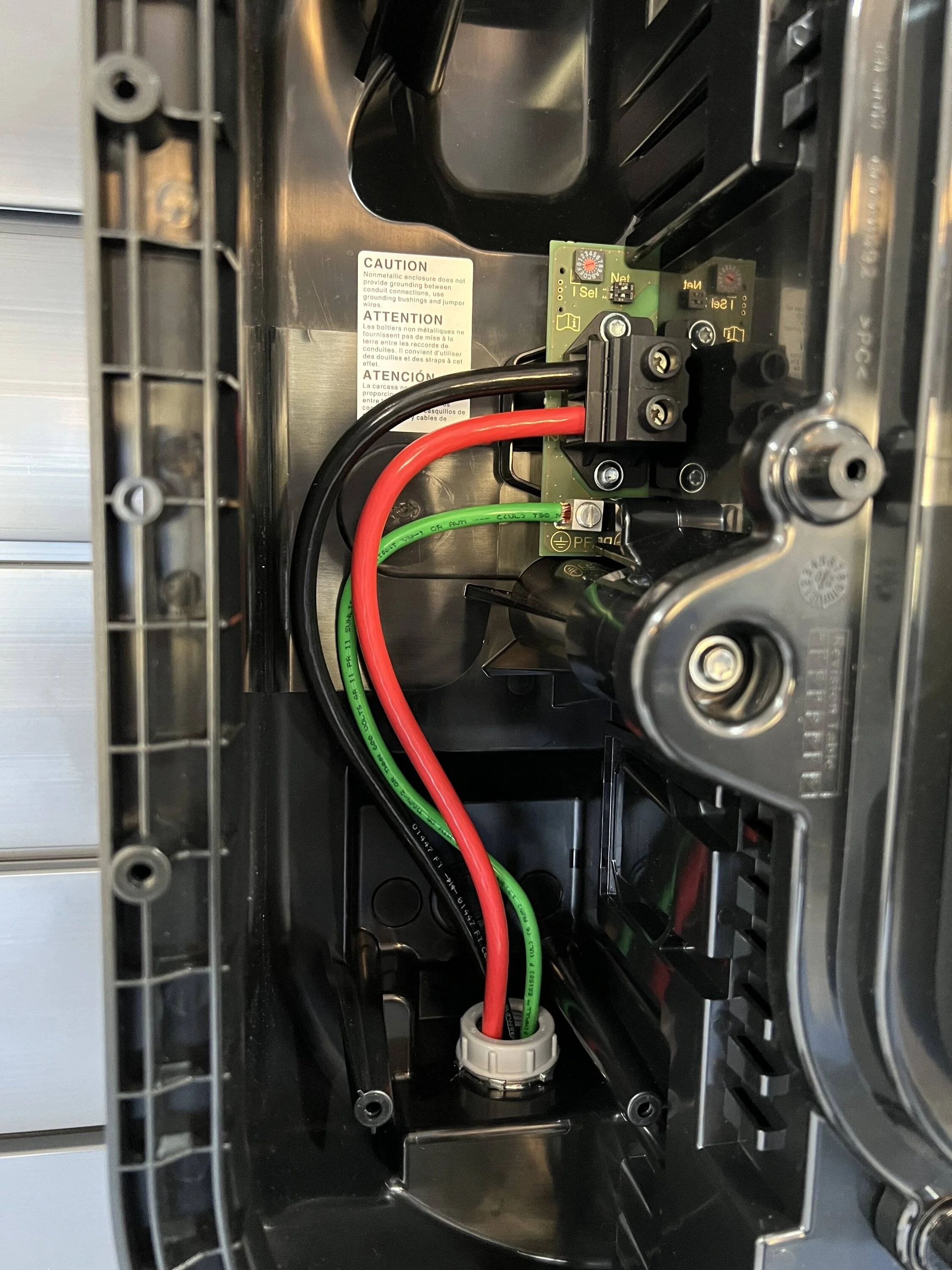

My wife had purchased this charger but I am seeing a loose green wire. I can't find any reference to where it goes. Can anyone help me out?
I have a Porsche Wall Charger Connect in my garage so let me share some things.
  1. The PWCC does NOT come new with the 4 lead wire shown in the picture above, already connected to the connection nuts inside the plastic box.
    • The presence of that wire indicates the device was installed/used, and then someone disconnect it and put it back in the box without removing the wire before selling it to you.
    • Highest likelihood is that the Dealer was using the PWCC. I don't see them accepting a device back from a client that has clearly been installed, and then trying to pass it off as new.
  2. The installation instructions are unambiguous about needing 3 wires - 2 of which are hot and go to the HOT leads of your electrical panel break (e.g., a 100A breaker or smaller if you have a smaller capacity electrical panel), and one of which goes to Ground in the electrical panel.
    • The intention is that the PWCC is wired directly to your electrical panel, or to a sub panel if the distance is longer. For very long distances and electrician might use cheaper aluminum wires from the electrical panel to the sub panel to hold down the cost (similar to how your 240V kitchen oven is typically wired).
    • The three wires needed (2 Hot and 1 Gnd) run in a metal conduit to the PWCC. My electrician said you don't use PVC for this type of application since the leads are carrying a lot of current.
  3. As mentioned above, there is no Neutral connection so someone purchased a wire with an extra connector. Perhaps the wire in your picture was originally for a PMCC setup, and then the dealer replaced that with a PWCC and left the extra wire disconnected.
  4. Be sure to set the DIP switches to match your situation. The DIP switch settings are clearly defined on pages 19 and 20 in the User Manual. One indicates the Power Source Type (e.g. typical US Split Phase 240V) and the other indicates the Maximum Current (e.g. 80A for a 100A breaker).

I agree new electrician - but honestly neutral is normally also ground in many setups - so it won't make a difference, but it would be best practice to to use the green for ground vs. neutral which commonly shares ground.
Neutral and ground are connected at the very first junction/panel into the house, they should not be shorted anywhere else, per code. While this will be mostly functional, it’s not per code, and it will disable any GFCI protection. Perhaps whoever had it before was plugging into a GFCI outlet and swapped neutral and ground on purpose, to disable GFCI protection on the outlet (since it might collide with GFCI in the EVSE).

Not per @satchurator unbox/install thread. Not to say that it hasn’t changed. But I’d put money on that cable coming from your electrician.
https://www.taycanforum.com/forum/threads/porsche-wall-charger-connect-unbox-install.7541/
With absolute certainty, my PWCC and current sold-new PWCC's do not come with a provided supply cable. How could they know the appropriate length to provide? I would guess that @Dale T 's electrician introduced the cable. If it was in fact previously used and sold as new by the dealer, that would be really poor form. @Dale T if your PWCC were in fact previously used and has not been reset, you could connect to the admin web portal to look for evidence of previous charging activity. The absence of that wouldn't prove newness though...

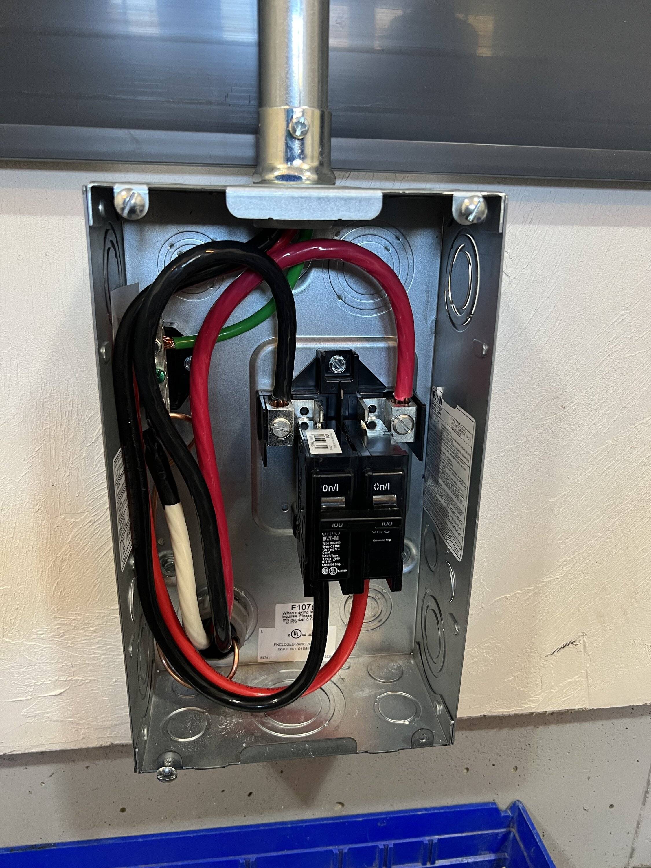

For what it's worth, my (electrician provided) supply cable for the short run to my disconnect has exactly three conductors. Attached are pictures of both ends. I'm not qualified to debate the code/electrical correctness of things here - my approach was to find and overpay for the absolute best electrician who would tolerate my fussiness and humor me on wanting to over-spec the install.
IMO the best path forward is to find a great electrician and start fresh with new cabling so you have zero doubts. Skip the dealer - Porsche have an online referral service for EVSE installation - you could start there instead of looking for random local folks. I went through quotes from multiple electricians who had EVSE install experience but had zero interest in Porsche's verbose and highly prescriptive installation guidelines.
A couple of additions to what @snstevens wrote. Despite what might be acceptable w.r.t code, the Porsche installation guidelines prescribe copper supply cabling (not aluminum) and also metal conduit (not PVC) for any exposed supply cable run.
Regarding copper vs aluminum, I'm not qualified to say why copper is preferred but I vaguely recall reading it has to do with the thermal expansion qualities and their effect on wear at the terminals.
As mentioned in my post, the electrician I worked with said it was fine to use aluminum to a sub-panel, and use copper from the sub-panel to the PWCC. I chose to place the PWCC near the electrical panel so I used copper for the entire run.
