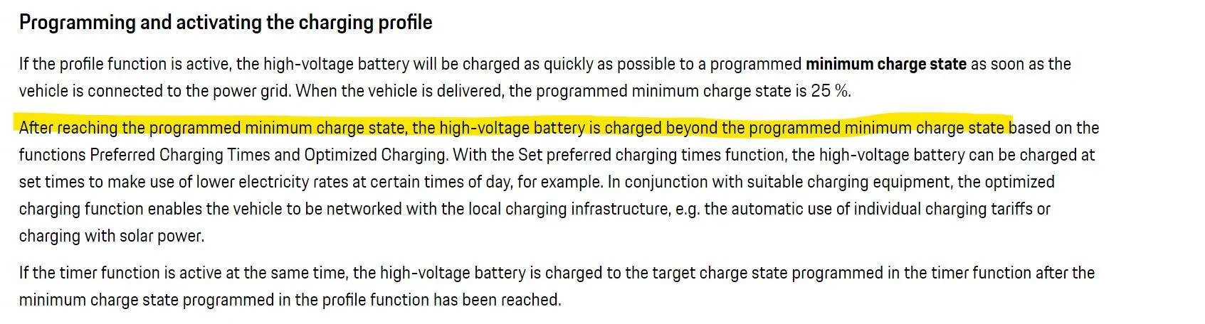

This is not expected behavior. The manual states that it will get to the Profile setting as soon as possible, then if there are no Timers, it will go to 100% per my understanding, but I have not tried it and do not want to take a chance on it going to 100% unless I am watching it. Also, to @whitex point, Timer has a Pre Heat feature that Profile does not. I am not seeing any point for the use of Profiles, unless you need to reach emergency minimum state as soon as possible, then hope it will not go to 100%, which is what Direct Charging does anyway.
You forgot to highlight the rest of the sentence. The “based on…” part.
If on preferred times, then yes it will continue charging during those times.
If on optimized, it’s waiting for instructions from a HEM. If you don’t have a HEM (not available in the US), then it received no further instructions (at least, not from the profile).
So a profile on optimized with no HEM charges to the minimum immediately, stops, and then does nothing else. It does not continue charging beyond the minimum.
As I read the above, it will charge to minimum charge state of the profile, and only charge beyond that if there is Preferred Charging Times or Optimized Charging (via the Porsche Energy Manager I presume) set. I have neither, hence the charging stops at minimum charge state in the profile.
