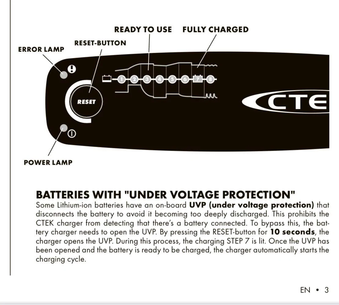

Thanks for the reply and all of the info (both in your previous post and this one). I did come across your older post through some searches and appreciated seeing that info.
That is interesting about the CTEK not being able to trip the safety relay to charge a low battery. As you mentioned, it is specifically part of the user manual which I've attached below. A buddy with a McLaren had the McLaren branded charger, but it is just the same CTEK variant. Obviously I don't have a car to test it on currently, but surprising if it doesn't have enough juice to do what is needed. I kind of question if the Amazon review had connections made appropriately or used the charger correctly. The Shop actually borrowed the Porsche specific 12v charger from the dealership to try to jump & charge the battery with no luck.

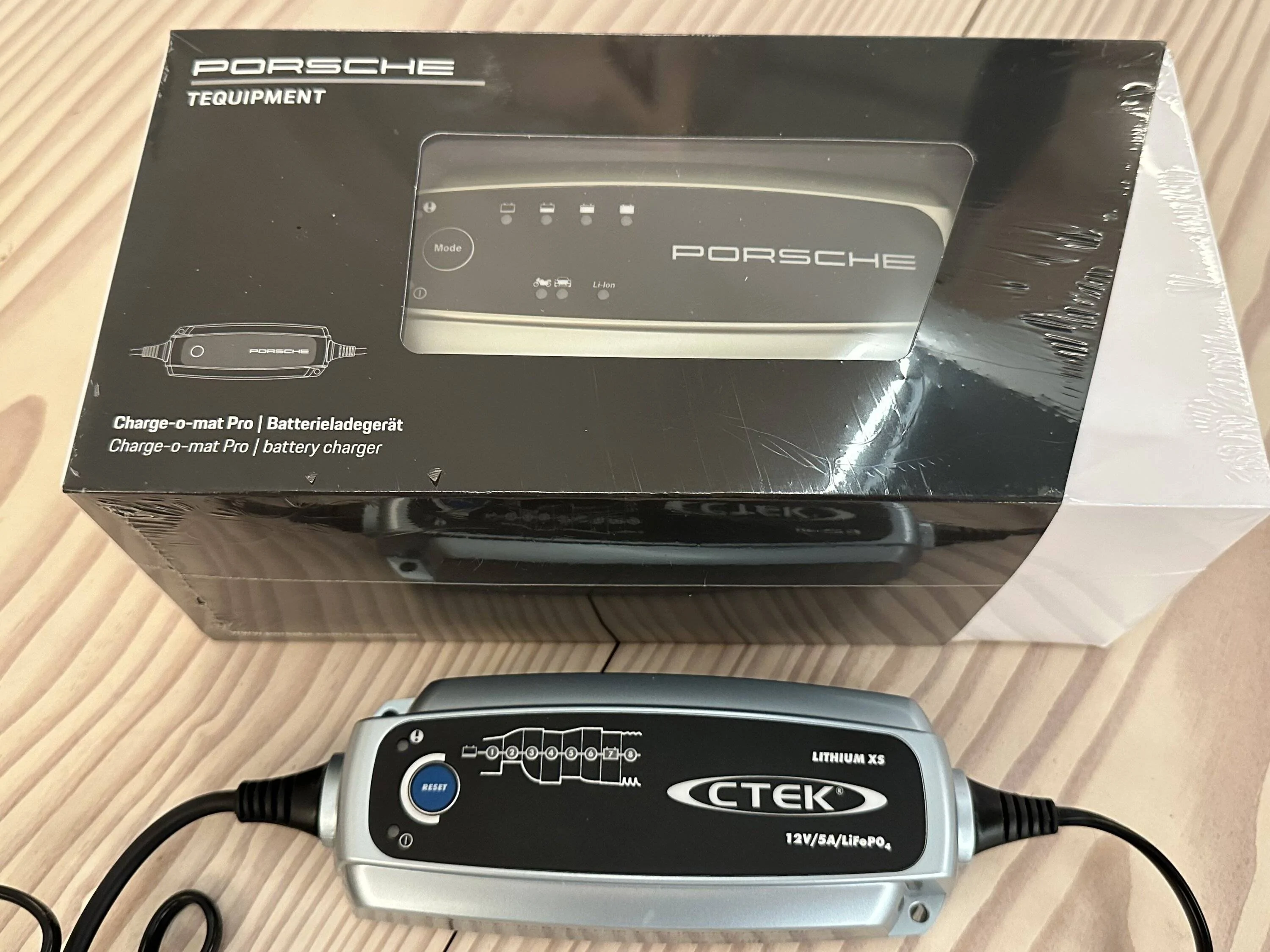

I've got several of the CTEK Lithium XS chargers as I use them on my bikes, out of season, that have Lithium batteries fitted.
Never had a problem with the charger - although a 'dead' LiFePo battery often needs a voltage bump to get it out of failsafe mode.
Porsche also offer a 5A battery charger, the Charge-o-Mat Pro (Part no. 95804490176) made for them by CTEK, which is both a lead acid and a Lithium specific charger. Cost around £120 here. I've got one sitting here in the box waiting for my Taycan to arrive (hopefully this week).
Photo of both below.
