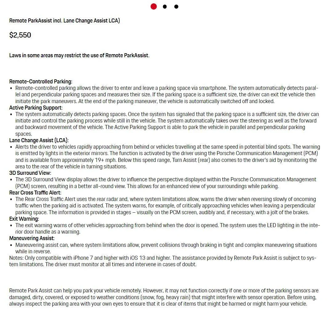

This is part of the Remote Park Assist / 3D option and not 360 Pano / surround.
There is another setting under Assistance for collision warning which can be tweaked to stop aggressive brake intervention - also useful to control rollback etc.
89
8,423
7,417
While I am not questioning this, I am curious how you figured out Maneuvering Assist is part of Remote Park Assist (vs. say just Park Assist)? I was looking through the configurator, didn't see this mentioned. I don't remember seeing it in the old configurator either.
11,085
6,859
Click the ℹ icon against the option and the full details of what you purchased are there.
89
8,423
7,417
You are right. I somehow missed that in the old configurator, I knew about the other options, but missed the Maneuvering Assist. Pasting the description below for reference.

Probably not listed, but won't require any extra HW (so it _could_ be OTA/FOD). I don't have this option in my camera view, but as W1nge mentioned above, the vehicle assistance systems page (the .. menu under Assistance) does list Maneuvering settings (Regular etc.)

In this context it relates to forward and aft movement rather than objects.
I think more hardware is needed - additional sensors - and not wholly software based.

May be, though I'm fairly certain I've experienced this unexpected braking once or thrice. The cameras and sensors are there, auto-braking is there (kicks in on hill holding) - not sure what else could be missing (radar?).
I may be wrong, as I'm not inclined to test this scenario (hmm, I do have a stack of styrofoam blocks laying about.. ?), and it's possible that in the few occasions where I've observed this there was a slight incline (and so I've experienced hill holding, and not auto braking).

I don't appear to have Maneuvering Settings either...
89
8,423
7,417
Do you have it enabled under Assistance, but the button to disable it on demand is not there on the camera screen?
